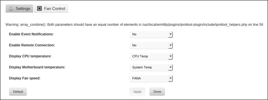

  1. Nope, If I go to Tools, IPMI tool all my sensors are gone. And the normal Dynamix temp and fan readings at the bottom right of the Web GUI is gone as well but it looks like it’s get overwritten by the error message as well. I was able to select and copy it: Array Started• Dynamix webGui v2016.02.09 Warning: array_combine(): Both parameters should have an equal number of elements in /usr/local/emhttp/plugins/ipmitool-plugin/include/ipmitool_helpers.php on line 59 Warning: array_combine(): Both parameters should have an equal number of elements in
  2. This is what I get. Its the SuperMicro board in my signature. root@unRAID1:~# /usr/bin/ipmitool -vc sdr Running Get PICMG Properties my_addr 0x20, transit 0, target 0 Error Response 0xc1 from Get PICMG Properities No PICMG Extenstion discovered CPU Temp,33,degrees C,ok,3.1,Processor,Temperature,40.000,-4.000,89.000,100.000,100.000,95.000,0.000,0.000,0.000,-128.000,127.000 System Temp,33,degrees C,ok,7.1,System Board,Temperature,30.000,-4.000,74.000,90.000,85.000,80.000,-9.000,-7.000,-5.000,-128.000,127.000 Peripheral Temp,38,degrees C,ok,7.2,System Board,Temperature,30.000,-4.000,74.000,90.000,85.000,80.000,-9.000,-7.000,-5.000,-128.000,127.000 PCH Temp,45,degrees C,ok,7.3,System Board,Temperature,25.000,-4.000,67.000,100.000,95.000,90.000,-11.000,-8.000,-5.000,-128.000,127.000 VRM Temp,37,degrees C,ok,8.1,Memory Module,Temperature,25.000,-4.000,74.000,105.000,100.000,95.000,-9.000,-7.000,-5.000,-128.000,127.000 DIMMA1 Temp,29,degrees C,ok,32.64,Memory Device,Temperature,30.000,168.000,206.000,90.000,85.000,80.000,1.000,2.000,4.000,0.000,255.000 DIMMA2 Temp,31,degrees C,ok,32.65,Memory Device,Temperature,30.000,168.000,206.000,90.000,85.000,80.000,1.000,2.000,4.000,0.000,255.000 DIMMB1 Temp,29,degrees C,ok,32.68,Memory Device,Temperature,30.000,168.000,206.000,90.000,85.000,80.000,1.000,2.000,4.000,0.000,255.000 DIMMB2 Temp,30,degrees C,ok,32.69,Memory Device,Temperature,30.000,168.000,206.000,90.000,85.000,80.000,1.000,2.000,4.000,0.000,255.000 FAN1,900,RPM,ok,29.1,Fan Device,Fan,12800.000,2000.000,17000.000,25500.000,25400.000,25300.000,300.000,500.000,700.000,0.000,25500.000 FAN2,1000,RPM,ok,29.2,Fan Device,Fan,12800.000,2000.000,17000.000,25500.000,25400.000,25300.000,300.000,500.000,700.000,0.000,25500.000 FAN3,,,ns,29.3,Fan Device,Fan,12800.000,2000.000,17000.000,25500.000,25400.000,25300.000,300.000,500.000,700.000,0.000,25500.000 FAN4,,,ns,29.4,Fan Device,Fan,12800.000,2000.000,17000.000,25500.000,25400.000,25300.000,300.000,500.000,700.000,0.000,25500.000 FANA,1400,RPM,ok,29.5,Fan Device,Fan,12800.000,2000.000,17000.000,25500.000,25400.000,25300.000,300.000,500.000,700.000,0.000,25500.000 Vcpu,1.818,Volts,ok,3.2,Processor,Voltage,1.800,1.620,1.944,2.106,2.088,1.899,1.242,1.260,1.395,0.171,2.466 VDIMM,1.320,Volts,ok,32.1,Memory Device,Voltage,1.425,1.201,1.642,1.747,1.719,1.642,1.096,1.124,1.201,0.137,1.922 12V,12,Volts,ok,7.17,System Board,Voltage,12.000,10.776,12.918,13.224,13.224,12.918,10.164,10.521,10.776,0.219,13.224 5VCC,4.969,Volts,ok,7.33,System Board,Voltage,5.000,4.473,5.372,5.589,5.527,5.372,4.225,4.380,4.473,0.071,7.976 3.3VCC,3.314,Volts,ok,7.32,System Board,Voltage,3.299,2.969,3.554,3.689,3.659,3.554,2.804,2.894,2.969,0.179,4.004 VBAT,3.045,Volts,ok,7.18,System Board,Voltage,3.000,2.595,3.495,3.690,3.600,3.495,2.400,2.490,2.595,0.045,3.870 AVCC,3.314,Volts,ok,7.36,System Board,Voltage,3.299,2.594,3.494,3.689,3.599,3.494,2.399,2.489,2.594,0.164,3.989 VSB,3.239,Volts,ok,7.35,System Board,Voltage,3.299,2.594,3.494,3.689,3.599,3.494,2.399,2.489,2.594,0.149,3.974 Chassis Intru,AAh,ok,23.1, root@unRAID1:~#
  3. Thanks for the update! I do get an error message, see encl pic.
