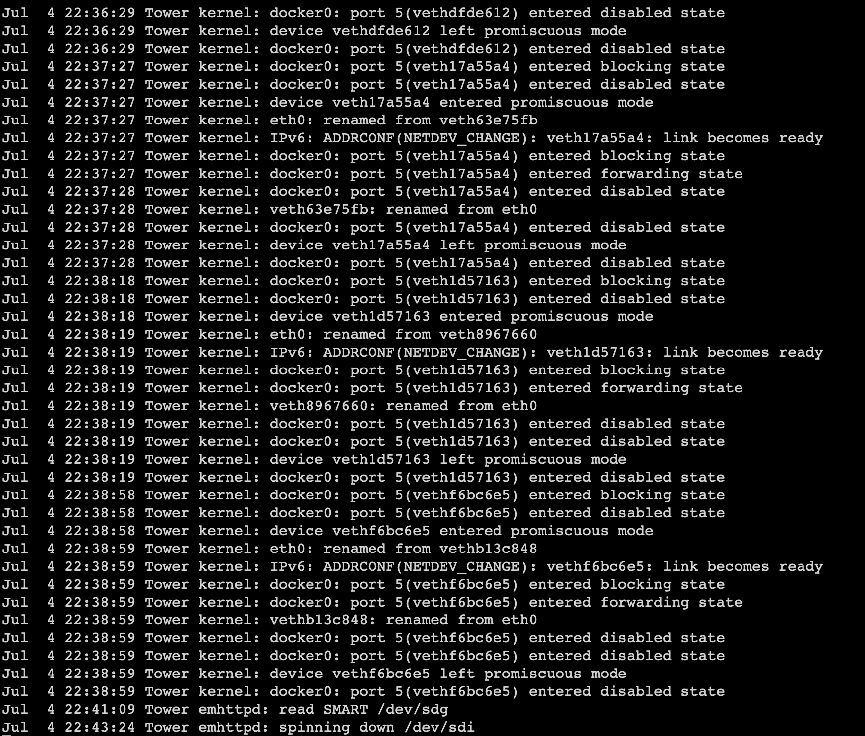

  22. I just upgraded from 6.11 to 6.12.2 and initially everything was working fine. I have a bunch of dockers I use and they were all working fine. I then decided to upgrade jitsi using docker compose, and it worked fine. after that I was trying to work on my wireguard which hasn't been working for a while and when I tried to stop the array it got stuck unmounting the shares. I had to shutdown the server manually and restart it, after doing that, half my dockers didnt work. they won't start. I tried to downgrade to 6.11, they still wouldn't work. I re-upgraded and thought maybe I'll just reinstall the dockers I have, so I deleted my docker image and used my old templates to reinstall the dockers. the dockers that weren't working before, still won't work (despite me deleting the folders in my apps and trying to do a fresh install). when I look at the server log I get all these docker entering disabled state errors. swag and Nextcloud give a ton of these errors: nginx: [emerg] no "events" section in configuration not sure where to go from here and I probably made things worse than better. I would appreciate any help.
