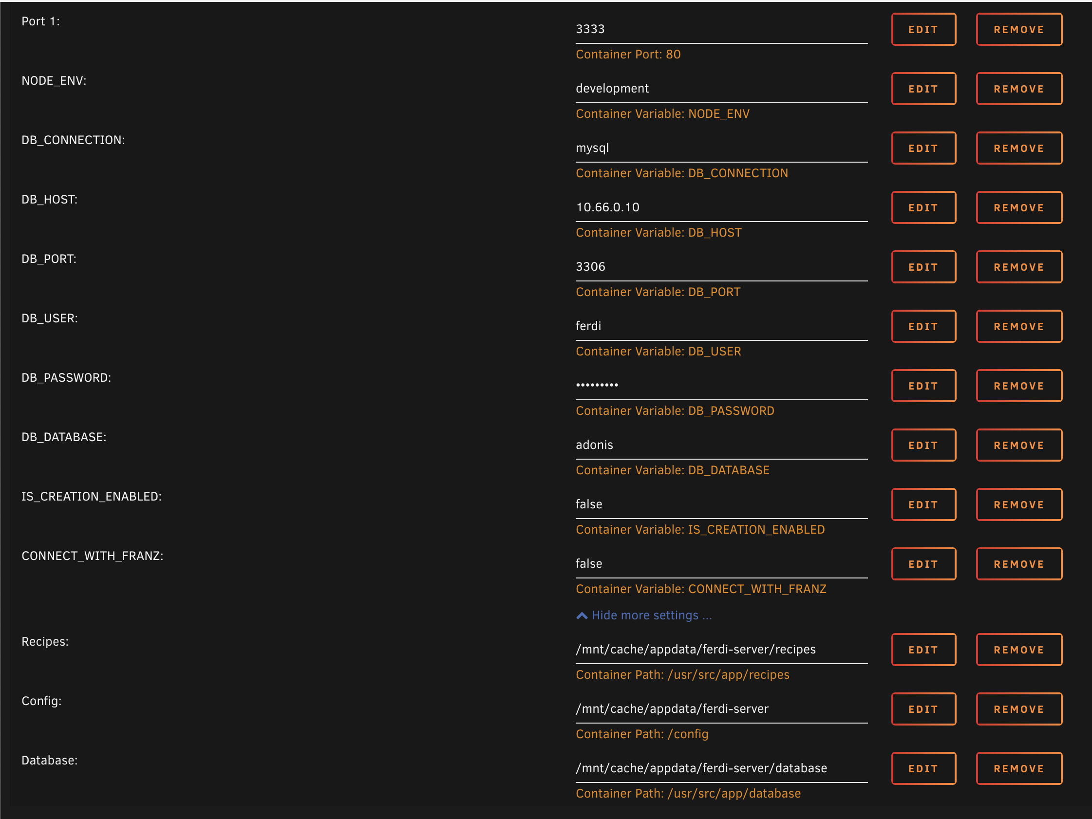

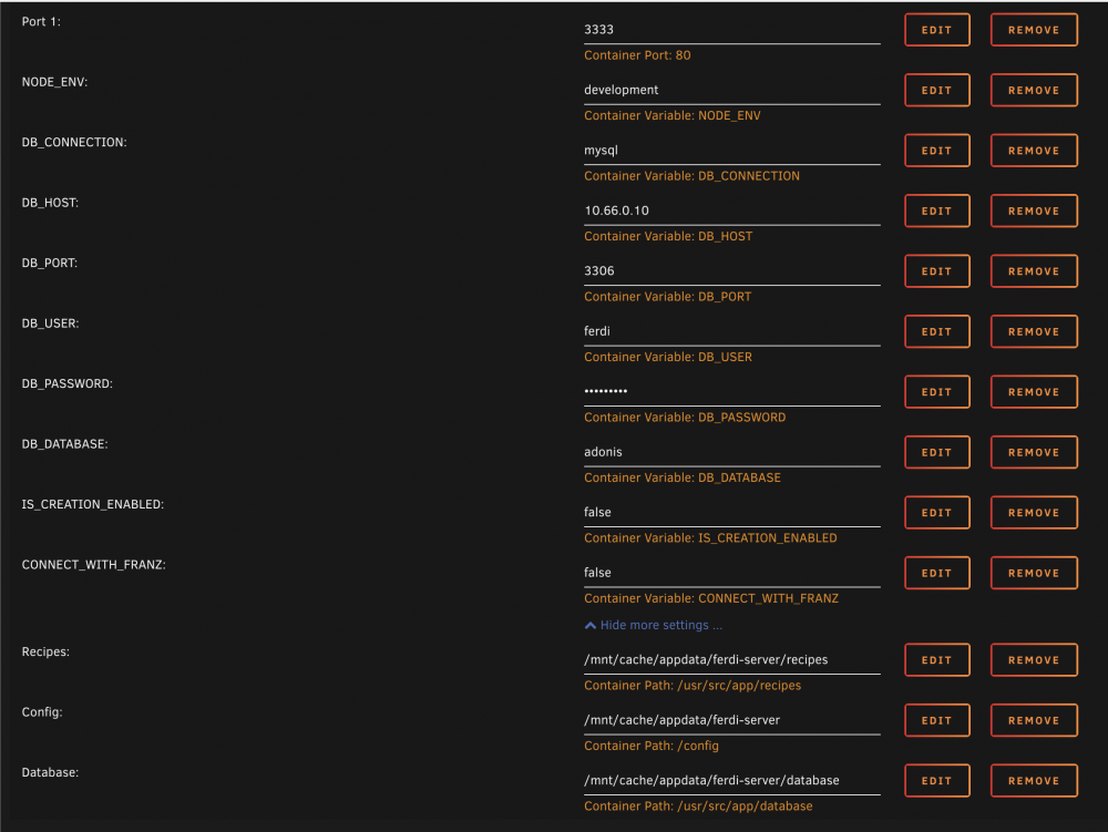

Hi Sebastian. Please see this conversation: https://github.com/xthursdayx/ferdi-server-docker/issues/4 Are you using the default template from my unRAID templates repo? If so, you shouldn't have to add the PUID/PGID variables for it to work. This is what my template looks like: Can you try deleting your appdata folder and the container/image and then reinstall with these variables (set to correct settings for your server) and report back?
