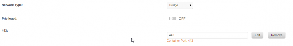

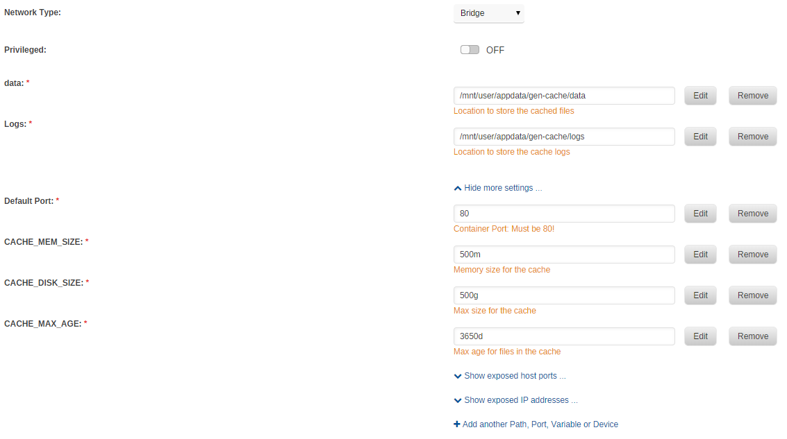

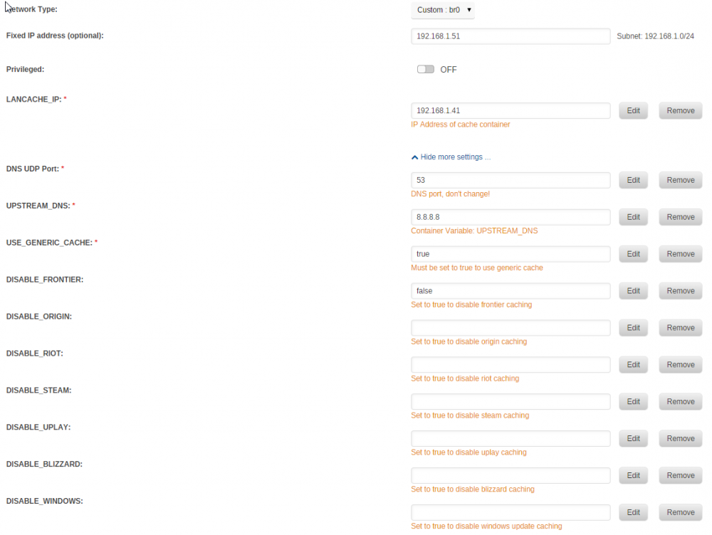

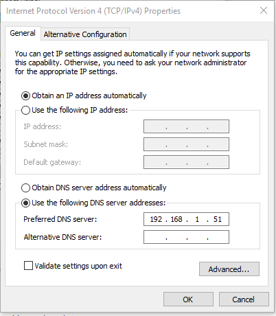

Did Steam say servers unreachable? If that's the case then I'm out of ideas. I suggest that we remove all three containers along with the images and delete all app data folders that were created for them. I then recommend you reinstall with EXACTLY the same config as me. I'll post screen grabs below. Hopefully, that will get it working. The only thing you may need to change are the two IP addresses. 192.168.1.41 is the IP of my unRAID server. 192.168.1.51 is the IP I assigned to the cache DNS container. Then you can tweak the config to how you want and you will soon realise if you make any breaking changes. Cache Container: SNI Proxy Cache DNS unRAID UI Ports Windows DNS Settings
