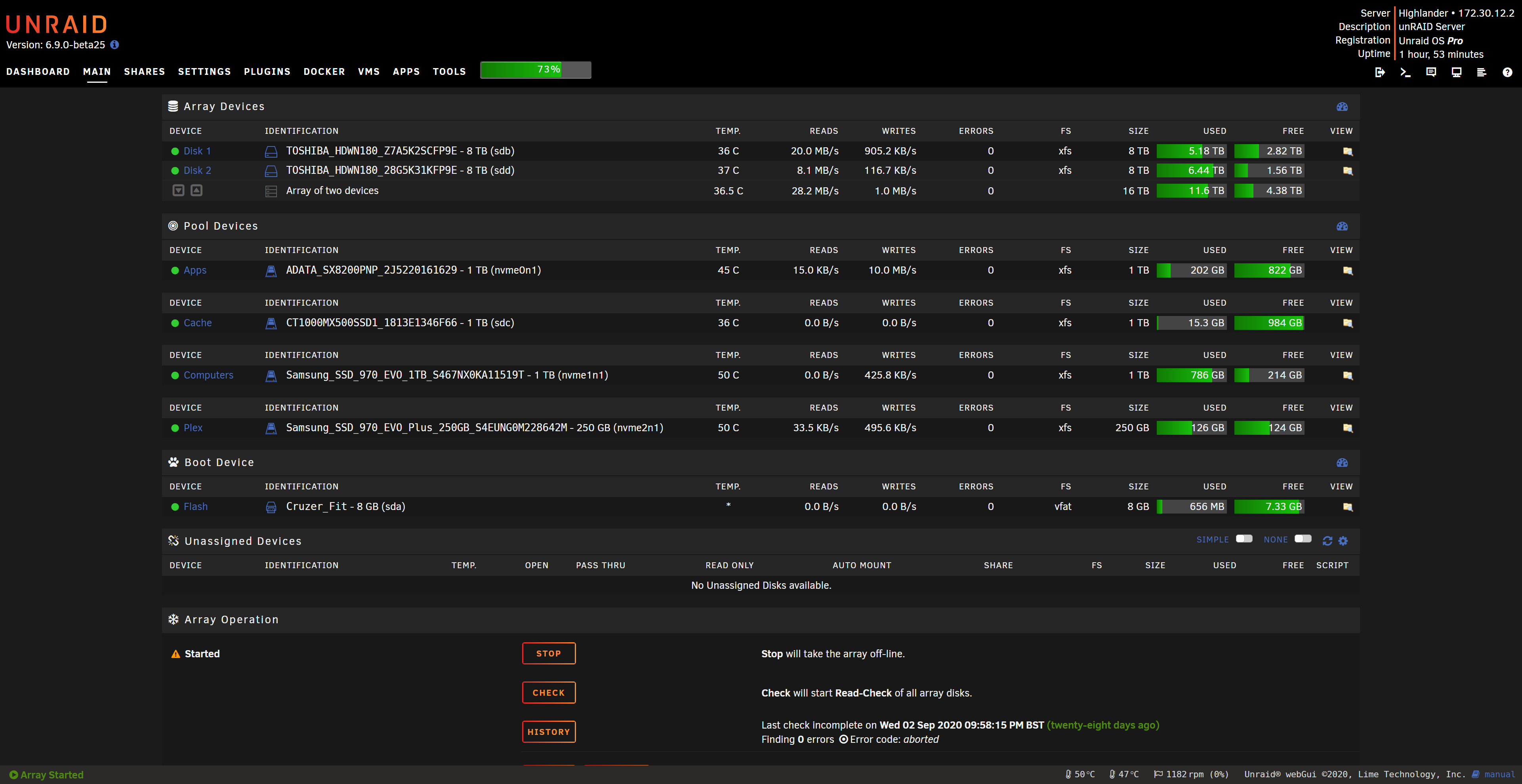

  20. If it was working before then my suspicion is that beta 29 could be the culprit. I've just had to rollback from beta29 as I've had 3 machine lockouts in 24 hours. Re speeds - rather than using UDs why not make your download drive a new pool drive with a cache/pool-only share 'downloads'? For me the biggest benefit of the 6.9 betas are having more options to have drives with shares that don't need to touch the array (even though I don't have a parity drive) and potential R/W slave issues, without having to resort to UD. E.g. here's my current structure, where only my cache has shares that are moved to the array
