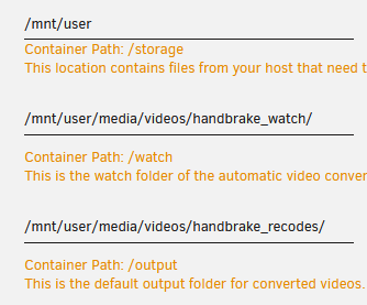

I am getting a cannot read or write the directory so I must have misspecified the output directory. Here is the error message? Here is what I have: What should I have here? How do I add the option to allow Intel QuickSync? In the Github page it talks about /dev/dri setting. I tried the add new device and I get this dialog box. What do I add for these parameters? Do I add
