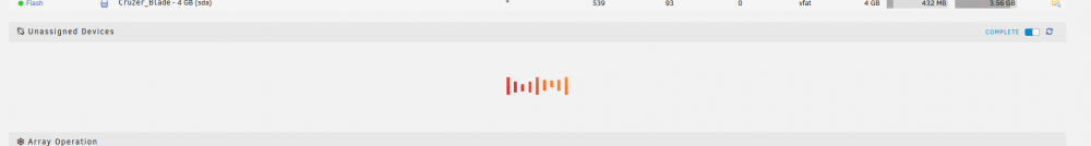

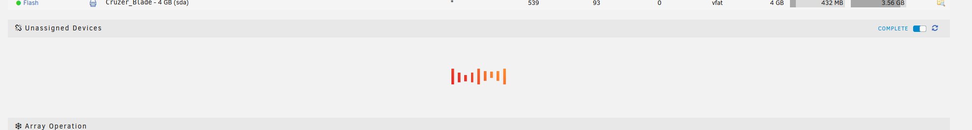

  10. Hi All, I am encountering an issue where each morning, I log into Unraid to find Unassigned devices unresponsive. Everything in the GUI and array is responsive, except the one disk mounted via unassigned devices and the GUI for unassigned devices. (just the loading animation). The disk is being used by a VM to write to over night as a bit of a scratch disk. I Also am unable to shutdown or reboot the server in this state, I am required to do a hard power off in order to restart everything. I am worried doing this is going to cause problems pretty quickly. Has anyone had this issue before?
