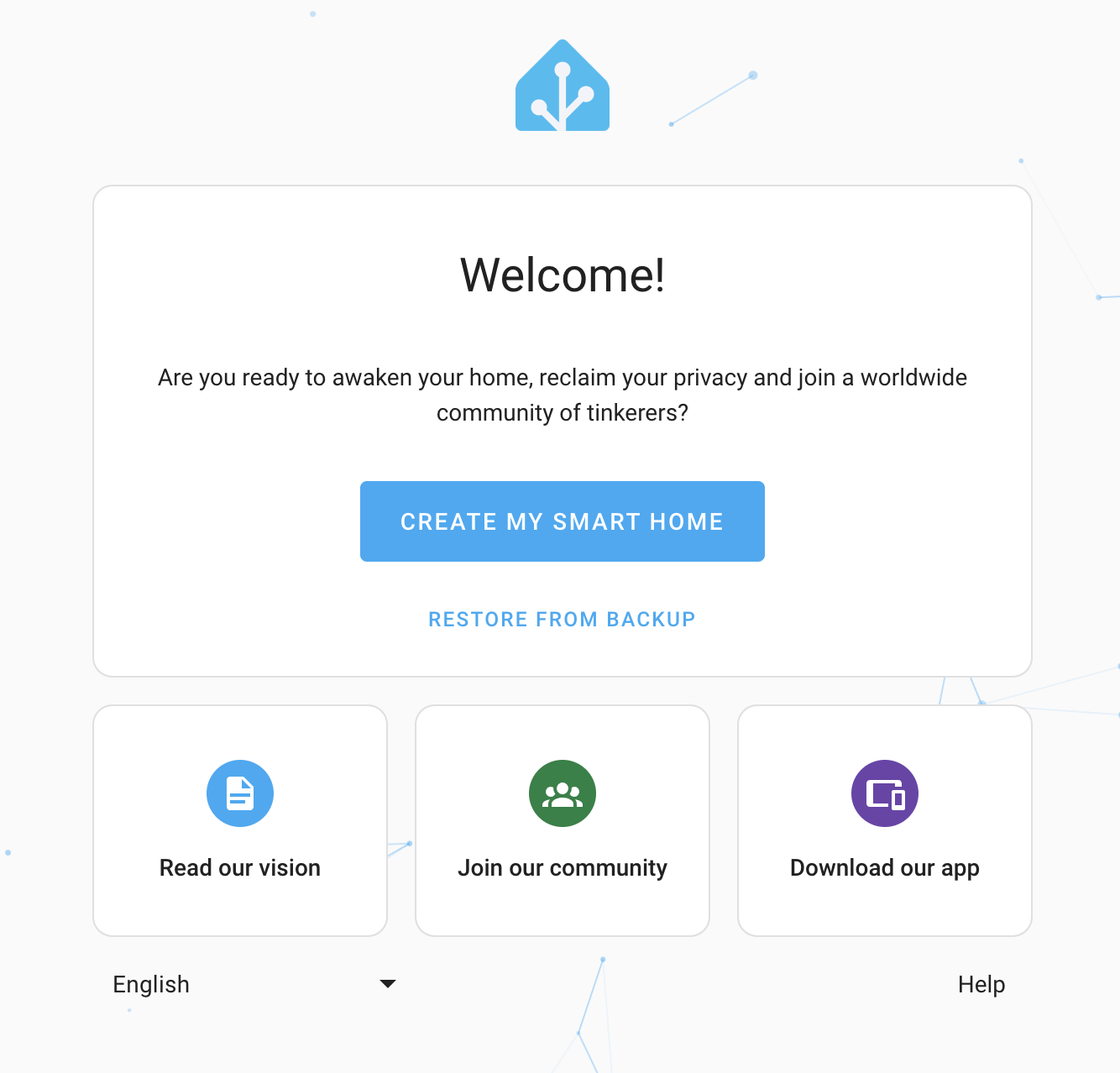

  9. I've got everything started (using default values) and spotted in my Docker log that its assigned its own and different IP address which then i can log into with port 8123 Host path for '/domains' is /mnt/user/domains Highest Q35 machine type available is pc-q35-7.2 The default VM network type is br0 Icon already there skipping..... VM 'Home Assistant' is already defined. Skipping VM creation steps... current status of VM 'Home Assistant': shut off VM 'Home Assistant' is not running. RESTART is set to 'Yes'. Attempting to start the VM... Attempting to start VM 'Home Assistant' (Attempt 1/5)... Domain Home Assistant started VM 'Home Assistant' started successfully. current status of VM 'Home Assistant': running VM 'Home Assistant' is running. Checking for the IP address of the running VM... Guest agent is not responding. Waiting for 5 seconds before retrying... (1/9) Guest agent is not responding. Waiting for 5 seconds before retrying... (2/9) Guest agent is connected. The IPv4 address of the VM 'Home Assistant' is: 192.168.0.187 Reloading Nginx with the new configuration... * Reloading nginx configuration nginx ...done. Waiting for 15 minutes before checking again to ensure VM is still running... Host path for '/domains' is /mnt/user/domains Highest Q35 machine type available is pc-q35-7.2 The default VM network type is br0 Icon already there skipping..... VM 'Home Assistant' is already defined. Skipping VM creation steps... current status of VM 'Home Assistant': running VM 'Home Assistant' is running. Checking for the IP address of the running VM... Guest agent is connected. The IPv4 address of the VM 'Home Assistant' is: 192.168.0.187 Reloading Nginx with the new configuration... * Reloading nginx configuration nginx ...done. Waiting for 15 minutes before checking again to ensure VM is still running... On my LAN http://192.168.0.187:8123/ gives me this now:
