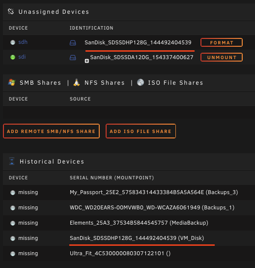

  7. I get the following error running that command mount: /x: special device /dev/sdh1 does not exist. I did try running the same command with just 'sdh' rather than 'sdh1' and got the following mount: /x: wrong fs type, bad option, bad superblock on /dev/sdh, missing codepage or helper program, or other error. Thanks
  8. I'm 99% sure it was xfs, diagnostics are attached. Thanks aventine-diagnostics-20200616-1257.zip
  9. Hi, Been using Unassigned Devices for a long time with no issues, just (cleanly) rebooted my server because of the NICS was stuck in a hardware loop and now one of the SSDs in Unassigned Devices is only giving the option to Format rather than Mount, it was working fine before the restart. Is there a way of getting this back? Thanks
