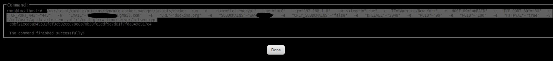

  4. I am having an issue with files being moved prior to processing. Looking at your video again and I have my setup just as yours. My question is the entry in sonarr and radarr dealing with downloads. /mnt/user/Downloads/':'/data if my data is set to downloads wont sonarr and radarr grab them before processing is completed? How does one get sonarr and radarr not to scan that main download folder? here is my template for review. root@localhost:# /usr/local/emhttp/plugins/dynamix.docker.manager/scripts/docker run -d --name='binhex-radarr' --net='tornnet' -e TZ="America/New_York" -e HOST_OS="Unraid" -e 'UMASK'='000' -e 'PUID'='99' -e 'PGID'='100' -p '7878:7878/tcp' -v '/mnt/user/Downloads/':'/data':'rw' -v '/mnt/user/movies/':'/media':'rw' -v '/mnt/user/Downloads_postprocess/movie/':'/data/usenet/completed/movies':'rw' -v '/mnt/user/Downloads_postprocess/media/':'/data/torrents/completed/media':'rw' -v '/mnt/user/appdata/binhex-radarr':'/config':'rw' 'binhex/arch-radarr'

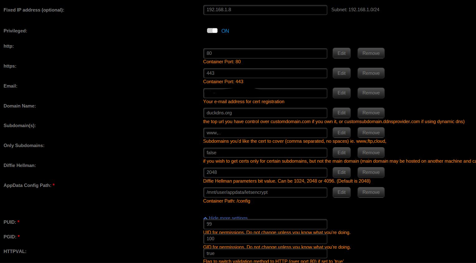

  13. I have been reading the thread for a few days and have tried most if not all of the settings to try to get letsencrypt to work properly. I have cone to the realization that I need some help. here are my docker commands pic for port forwarding docker settings and log. Please review and point me to the right direction User uid: 99 User gid: 100 ------------------------------------- [cont-init.d] 10-adduser: exited 0. [cont-init.d] 20-config: executing... [cont-init.d] 20-config: exited 0. [cont-init.d] 30-keygen: executing... using keys found in /config/keys [cont-init.d] 30-keygen: exited 0. [cont-init.d] 50-config: executing... 2048 bit DH parameters present SUBDOMAINS entered, processing Sub-domains processed are: -d www.duckdns.org -d *****.duckdns.org E-mail address entered: *******@gmail.com Different sub/domains entered than what was used before. Revoking and deleting existing certificate, and an updated one will be created usage: certbot [SUBCOMMAND] [options] [-d DOMAIN] [-d DOMAIN] ... Certbot can obtain and install HTTPS/TLS/SSL certificates. By default, it will attempt to use a webserver both for obtaining and installing the certificate. certbot: error: argument --cert-path: No such file or directory Generating new certificate Saving debug log to /var/log/letsencrypt/letsencrypt.log Plugins selected: Authenticator standalone, Installer None Obtaining a new certificate Performing the following challenges: http-01 challenge for duckdns.org http-01 challenge for www.duckdns.org http-01 challenge for ******.duckdns.org Waiting for verification... Cleaning up challenges Failed authorization procedure. duckdns.org (http-01): urn:acme:error:unauthorized :: The client lacks sufficient authorization :: Invalid response from http://duckdns.org/.well-known/acme-challenge/5DjNjApDhgxwNVsF1Q6lWYBssBPsq5R5LcM43nyAZHg: "<html> <head><title>404 Not Found</title></head> <body bgcolor="white"> <center><h1>404 Not Found</h1></center> <hr><center>", www.duckdns.org (http-01): urn:acme:error:unauthorized :: The client lacks sufficient authorization :: Invalid response from http://www.duckdns.org/.well-known/acme-challenge/movR-LxQjAQuGhXp8wzWU9LjdT99d5UBC_3o0n7RnXA: "<html> <head><title>404 Not Found</title></head> <body bgcolor="white"> <center><h1>404 Not Found</h1></center> <hr><center>" IMPORTANT NOTES: - The following errors were reported by the server: Domain: duckdns.org Type: unauthorized Detail: Invalid response from http://duckdns.org/.well-known/acme-challenge/5DjNjApDhgxwNVsF1Q6lWYBssBPsq5R5LcM43nyAZHg: "<html> <head><title>404 Not Found</title></head> <body bgcolor="white"> <center><h1>404 Not Found</h1></center> <hr><center>" Domain: www.duckdns.org Type: unauthorized Detail: Invalid response from http://www.duckdns.org/.well-known/acme-challenge/movR-LxQjAQuGhXp8wzWU9LjdT99d5UBC_3o0n7RnXA: "<html> <head><title>404 Not Found</title></head> <body bgcolor="white"> <center><h1>404 Not Found</h1></center> <hr><center>" To fix these errors, please make sure that your domain name was entered correctly and the DNS A/AAAA record(s) for that domain contain(s) the right IP address. - Your account credentials have been saved in your Certbot configuration directory at /etc/letsencrypt. You should make a secure backup of this folder now. This configuration directory will also contain certificates and private keys obtained by Certbot so making regular backups of this folder is ideal. ERROR: Cert does not exist! Please see the validation error above. The issue may be due to incorrect dns or port forwarding settings. Please fix your settings and recreate the container
