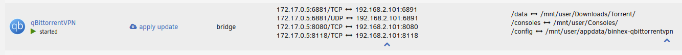

  11. Quick question about container and host ports: if I have 6881 (container) and 6891 (host) as seen here: then I need to have: 6881 set as my incoming port in the qBittorrent web UI 6891 forwarded from my router, to the server's IP (192.168.2.1) Are my assumptions correct?
