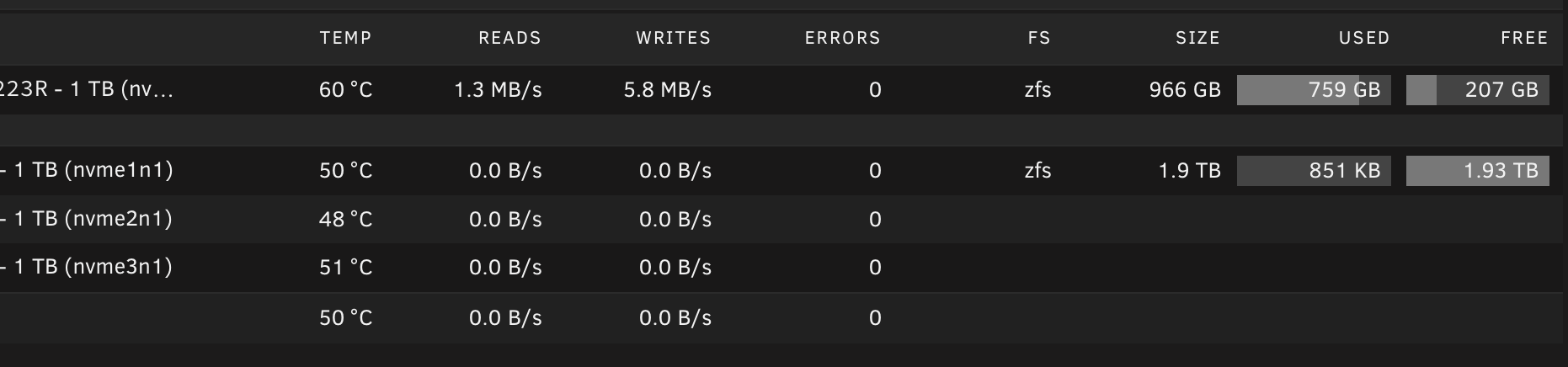

  22. Hey, So i have the following configuration running: Running 3 Samsung 980 in a ZFS RaidZ1. I'm getting really bad internal Speeds: What could cause this to run really slowly, the drives are rated for at least 3/3 GB/s of read and write, yet im getting 1/3 with a Raidz1

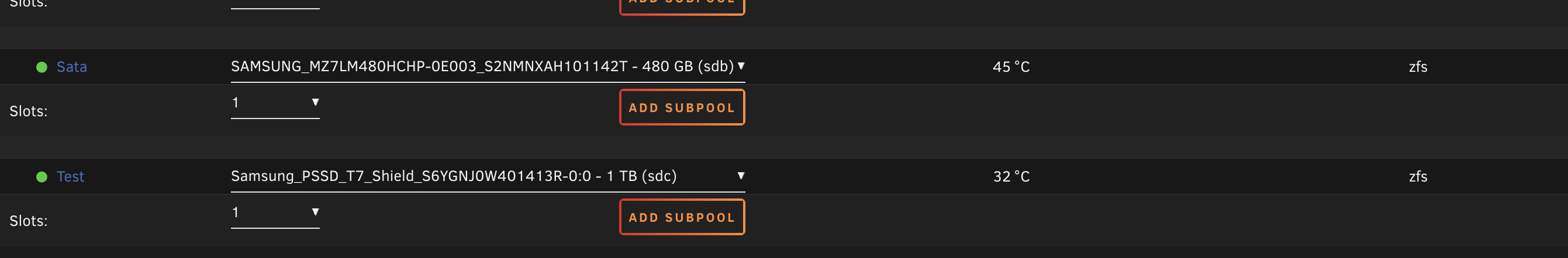

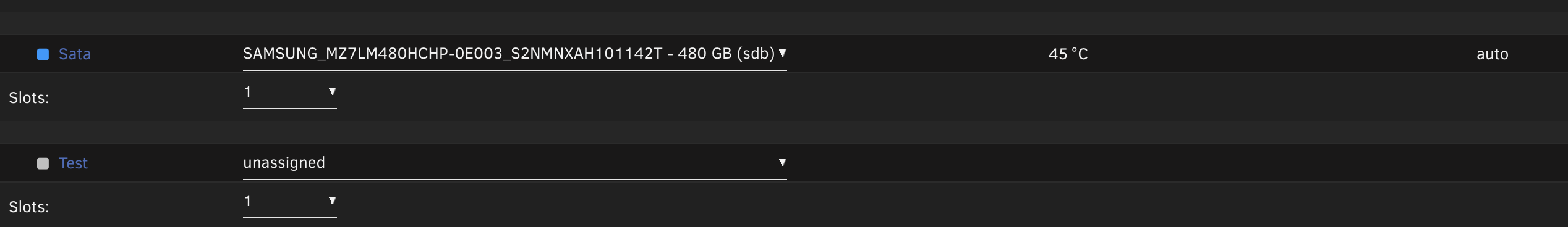

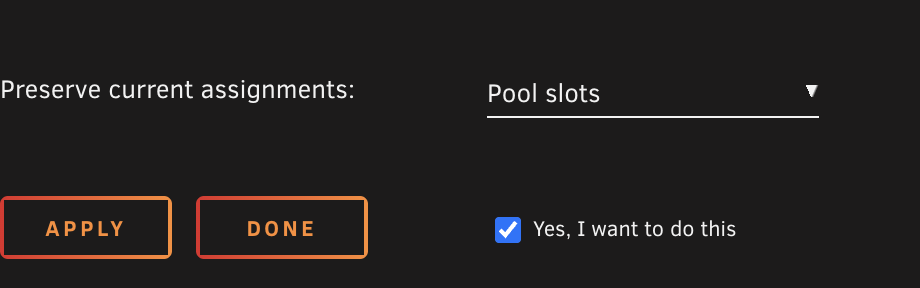

  23. Hey everyone! So it all worked out quite well. (other than accidently deleting a database). I've got one question remaining: I currently have the following: the pool with 1 disk is called; "extra" the pool with 3 disks is called: "main" which is a raidz1 I'm goign to move the data back to the main pool and remove the 1TB nvme from the system. Here's my problem. i went over to my test server and tried to emulate it: on my test server i have 2 pools: When i do "New Config" under tools and i tell it to preserve the full layout: Going back to the main page i can see that the pools stay there and i can remove the one i wanted gone: What i've noticed which is my question: the File system went from "ZFS" to "AUTO". My question: What happens if i do that with my Raidz1 array on my production machine, would i need to place the disks in the same pattern as now and set it to Raidz1 again and it will just work? tldr: When doing new config and retaining pool devices it doesn't keep the config set to make it RaidZ1 and instead resets to "auto"
