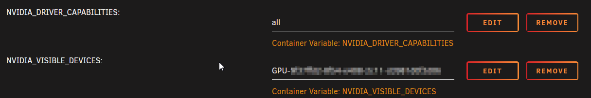

@PTRFRLL
Hi - thanks for the trex miner container. Running into an issue hoping forum can assist.
When starting container I get this in the log:
 have the following 2 entries assigned in the container:
nvidia-smi output:
24 minutes ago, repomanz said:
@PTRFRLL
nvidia-smi output:
fixed this after more reading: change the container repo to this: ptrfrll/nv-docker-trex:cuda11
