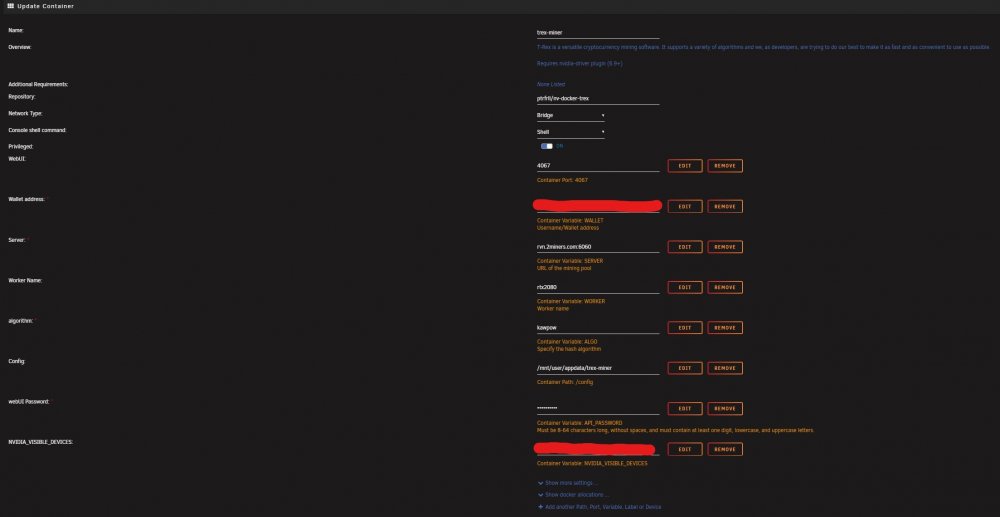

8 minutes ago, Ystebad said:
Need help with Trex docker.
I have to manually enter my pool information each time it starts or it won't connect/mine.
In the unraid docker edit there is only one field named "server" and here I have entered   eth-us-east.flexpool.io
However it won't connect unless I go into the actual GUI after it's started and select SSL then enter the pool above and enter the port 5555.  Then it works fine, until the docker is restarted at which time it won't connect again.
I tried editing the config.json under the tree-miner folder of appdata with the following:
      "pools" :
                        "pass" : "x",
                        "url" : "stratum+ssl://eth-us-east.flexpool.io:5555",
However this doesn't seem to work.
What am I missing/doing wrong?
advTHANKSance!
You should be able to pass that entire URL, port included, via the "server" variable. This is what my "server" var looks like:
stratum+ssl://us2.ethermine.org:5555

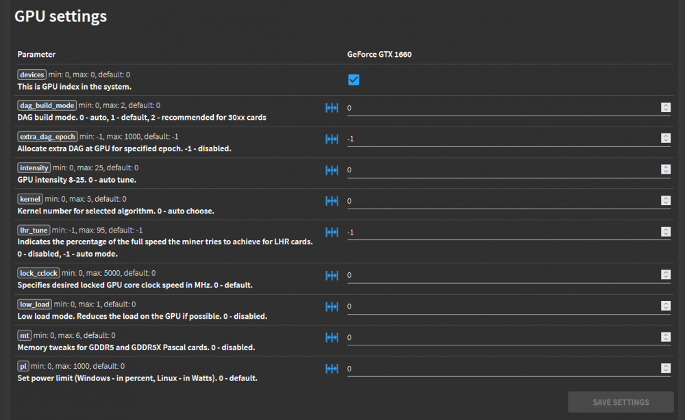

Hi Folks, I don't seem to be able to get my trex-miner docker running on Unraid since I recently had a graphics card die on me.
The error is :
ERROR: Can't start T-Rex, number of specified <arg> doesn't match the number of GPUs
I tried to adjust the devices field from  "devices" : "0,0", to  "devices" : "0", but no dice.
I'm including my config.json below with obfuscated details. Appreciate any help.
The error is :
I believe you need to adjust all the parameters in the config file that reference the second GPU. Any that have a comma (dag-build-mode, mt, pl, etc), e.g. "0,0", should be changed to remove the second number
That worked. Thank you!
