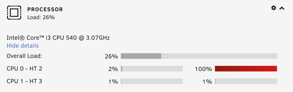

100% CPU on one core, waiting on something, can't run diagnostics, can't access Docker
I've seen similar reports like here, but mine is slightly different in that there are no dockers running, so unsure what to look for.
Here's the details:
UNRAID Dashboard shows one core @ 100%
When running top, there's nothing obvious in the CPU column, however I can see 24.9 wa, which would indicate 1 of the 4 cores is at 100% waiting on something:

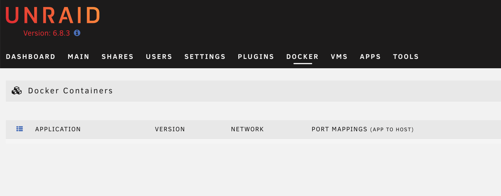

I can't see much the Docker page on the GUI, however I know I have 2 Dockers installed, but no Dockers running, there were none running yesterday when i could successfully access this screen:

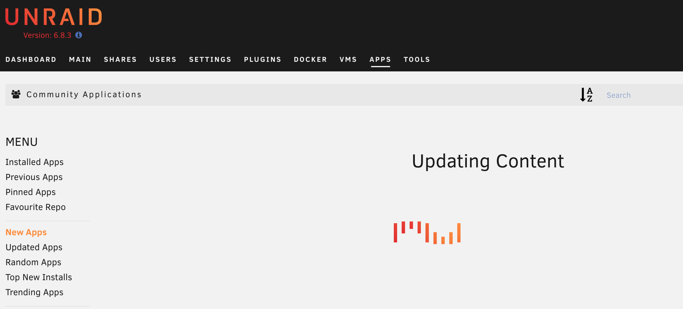

I receive this never-ending loop on the Apps screen:

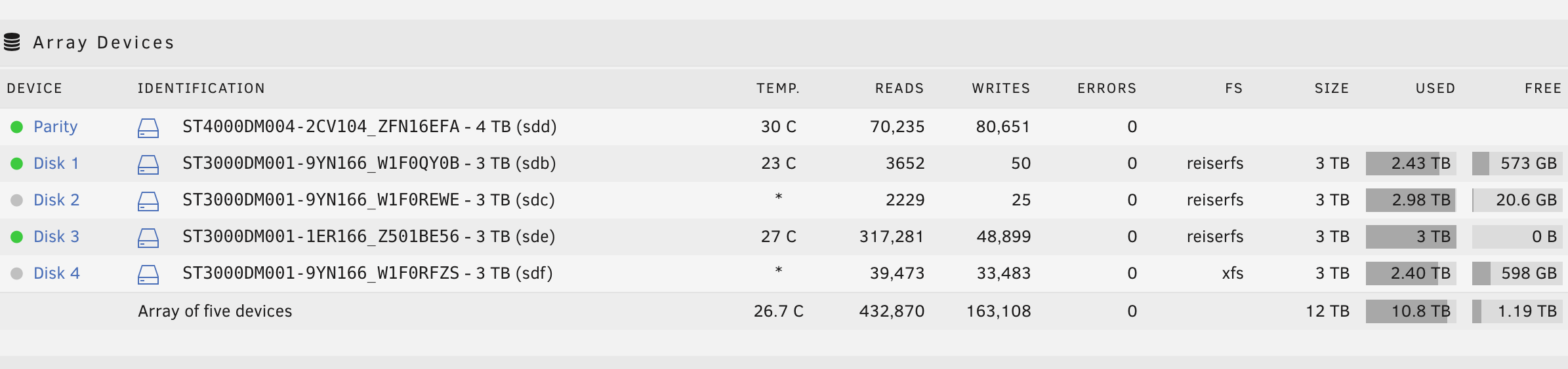

I can access the server over the network, but don't seem to be able to access disk3 (whereas the other disks are successful). disk3 I was copying files to yesterday, and it looks like it ran out of space (curious if this has caused it):

Educated guess here, ReiserFS is doing file system maintenance. Leave it alone for at LEAST 24 hours and see if it resolves.
Another issue could be your 3TB seagates, those models are infamous, they have their own wiki entry about the class action. https://en.wikipedia.org/wiki/ST3000DM001
Would also be helpful if you said what test FCP stopped on since that's listed along with the %
Wish I could but I can't remember, but if I'm being honest, I don't think this was the cause. I ran FCP once I started having issues, my gut says it hung on 3% due to these issues, not caused them.
Whoa.
Whoa.
Whoa.
Seems an obvious culprit could indeed be the drive(s). I'm running 4 of the things. Oh damn.
Just now, freezingkiwis said:
Whoa.
Whoa.
Whoa.
I'm more inclined to blame ReiserFS, having experienced almost identical symptoms several years ago.
Also, just because those drives have an exponential failure rate compared to similar drives in that time period, doesn't mean that there is a 100% failure rate. In my experience, drives that survive several years are more likely to die relatively normal deaths typically preceded by warning SMART errors.
Doesn't mean those drives are good, but without a SMART report you can't pass judgement just yet.
as far as I know you never get any sort of file system maintenance that is not initiated by the user.
Absolutely.  But the test it hung on would help pinpoint what your problem is in lieu of diagnostics
Poor choice of words. ReiserFS can get super slow sorting out file fragments when asked to write to a drive that's full. That's what I meant by maintenance, it's likely just stuck sorting out where to put things.

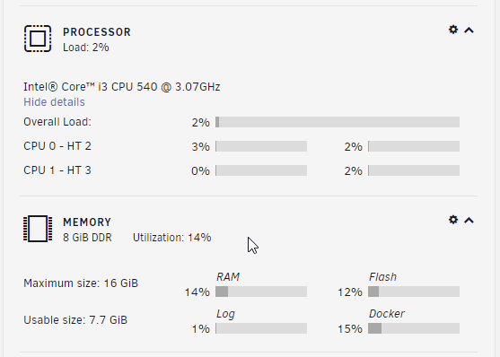

Parity check was started, so I allowed that to run for ~11 hours, finding no errors:
Processor and RAM are nice and low, nothing in particular is happening on the server now:
And I've attached diagnostics again, after all of the above "20210214-1415-after-Parity-check".
I've successfully run FCP, no errors or warnings found.
I can successfully connect to my server over the network, and browse all drives.
