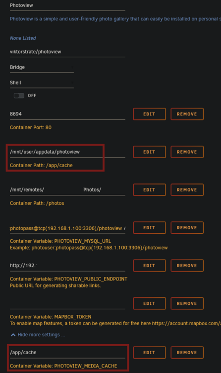

  • CorneliousJD, I got Photoview running, and it was quite a bit of trying different things. So initially I couldn't get Photoview to load no matter what. Looking through the logs it seemed like it was

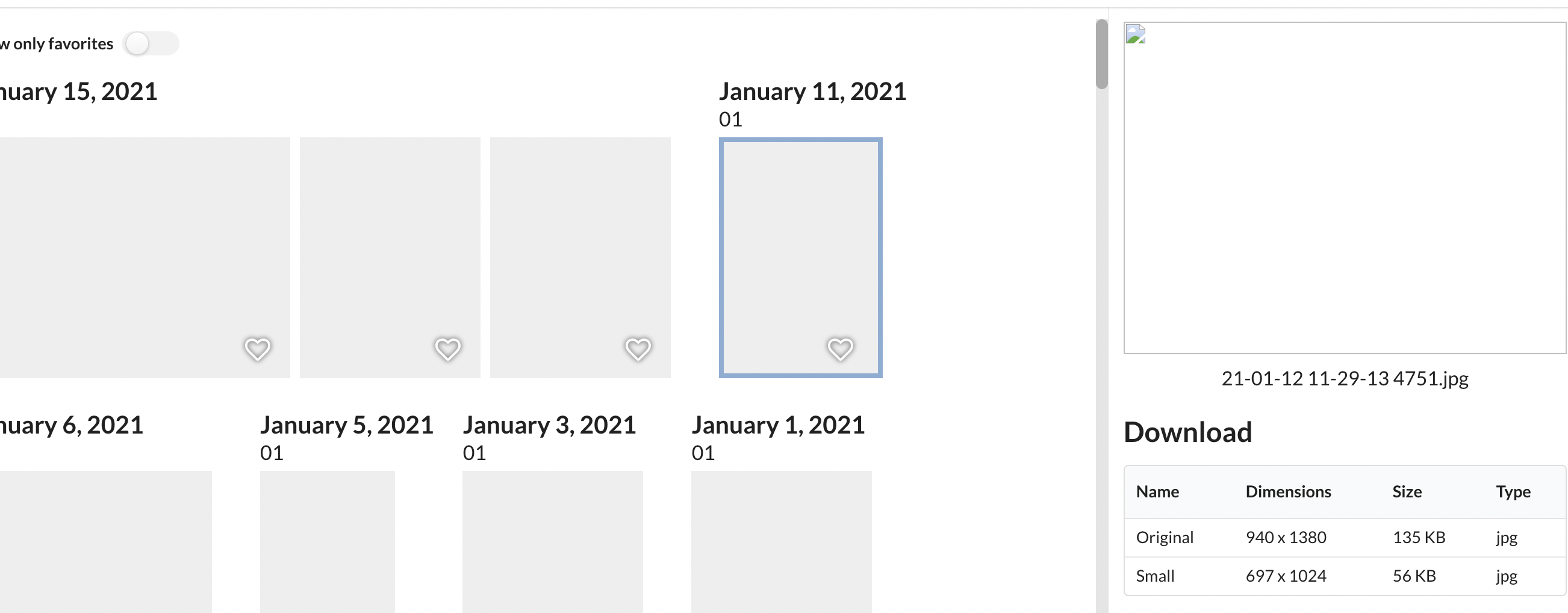

However it shows a blank image where the photo is and does show the name of the picture.
Any ideas?

Just now, roadkill said:
So i set everything up and it worked fine and was able to scan.
Any ideas?
Check your appdata photoview folder. Is it actually rendering thumbnails there for you?
Yes, my appdata folder shows thumbnails of all the images
I am using mysql if that matters
Interesting, I had that issue for a while but didn't for too long. If your library is huge it might take hours to fill out. But if you have a small collection it shouldn't take but a few minutes to start showing up.
This is the official docker container so it may be worth reaching out to them on their GitHub page if it doesn't show up in a few hours time?
Any ideas?
I had this problem I changed the domain to Unraid ip and port in order to show the images
PHOTOVIEW_PUBLIC_ENDPOINT: http://IP:8694/
Thanks i'll try it later
Thanks for posting this. I had always had mine setup when I was doing testing as a public URL that I had Photoview up on for testing reasons and it was loading fine!
So initially I couldn't get Photoview to load no matter what. Looking through the logs it seemed like it was having trouble pinging the mysql server. I tried a fresh install of mariadb and back to mysql and still nothing. What made me suspicious was that the mysql docker wouldn't accept my login credentials even though I changed them.
What worked:
I set up a fresh mysql docker and used the docker-composer.yml template to set the login and passwords in the initial setup. I used the same settings to in Photoview and viola, it worked! So the mysql docker isn't update the database with any changes, which is what I kept doing after install. Whatever settings are used in the initial install, that's what the docker will use. Hopefully itll help someone else with this too.

Scanner error
Failed to begin database transaction: failed to process photo (/photos/DSC04092.ARW): open /app/cache/2/3/highres_DSC04092_ARW_6gwa6DDO.jpg: no such file or directory
/app/cache is configured properly, folders like /app/cache/2/3/ were created, but there's nothing in it :(
