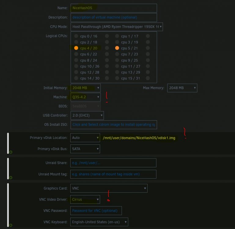

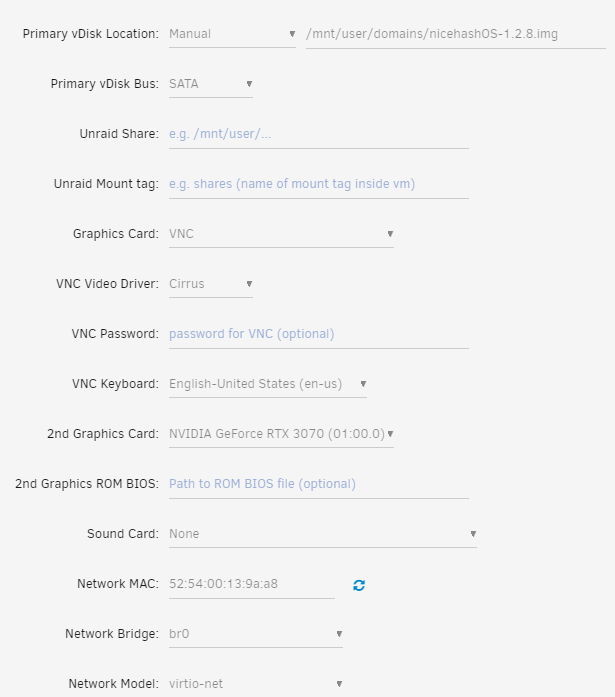

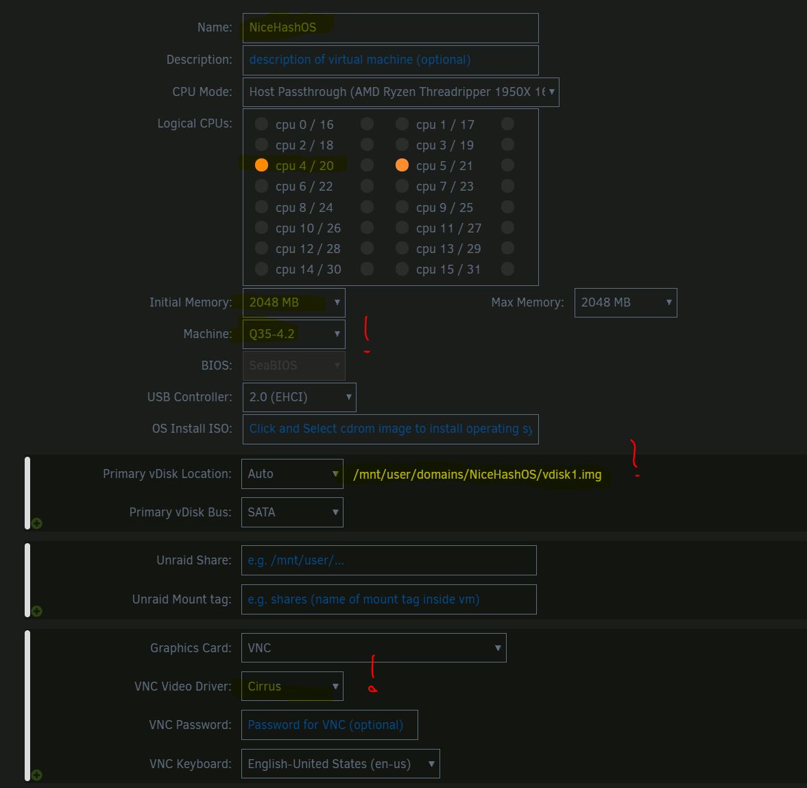

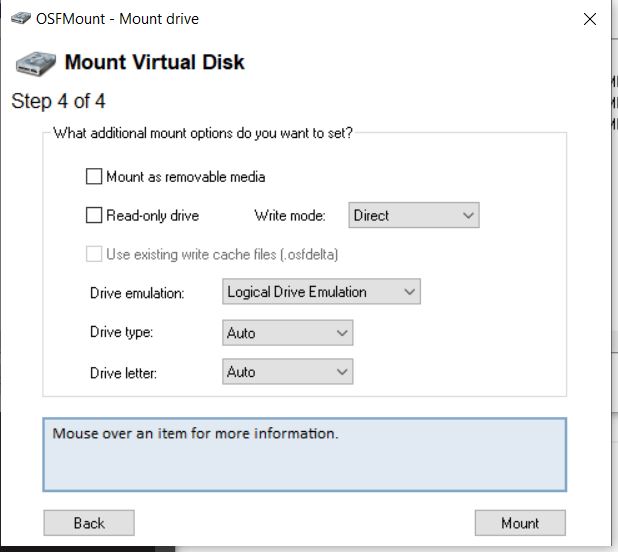

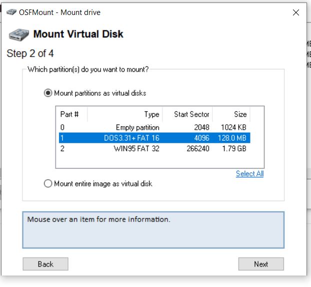

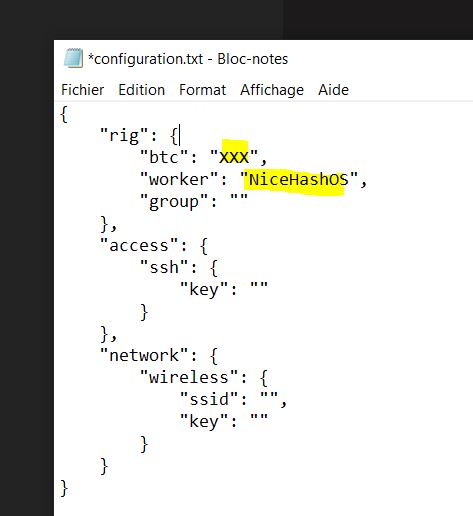

February 28, 20215 yr In two words ; Machine Type Q35, VNC driver CIRRUS. Download NiceHashOS from : https://www.nicehash.com/download-center Download and install OSFMount : https://www.osforensics.com/tools/mount-disk-images.html On a Windows VM : - Extract the NHos archive with Winrar or 7Zip. - With OSFMount, select tthe extracted .img file and mount the DDOS3.31+FAT16 partition. - Uncheck "read-only drive" - Open the mounted partition in the explorer and edit the configuration.txt by adding your BTC address (from your Nicehash account) and worker's name (as you like). - Save the file and unmount the partition - Mount again the .img file and ensure that your changes have been recorded - You can now move the .img file in your domains/vm disks folder Create a new VM with Ubuntu Template. Ensure to have these settings : - At least 2GB of ram - Save on CPU cores as it will bring no benefits Mandatory : - Of course point to the edited .img file. - Machine Type Q35 - Change VNC driver for CIRRUS - Add a secondary nvidia GPU. You should be all set :). You can control the GPU OC settings from the web interface. Your nvidia GPU should have no more rest. Edited February 28, 20215 yr by dboris

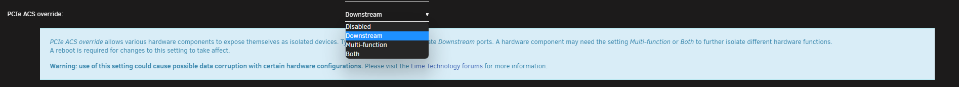

July 10, 20215 yr On 5/19/2021 at 9:23 AM, kron said: Need a little help here. Nicehash rig dashboard is showing the unraid rig but the status is Offline. Last seen timestamp shows only the initial creation of the VM and nothing more. What am I missing? Just got this sorted out myself. To properly pass through the GPU into the VM, you first need to set "PCIe ACS override" to "Downstream" in the VM Manager settings, then reboot. This is the first VM i ever needed to build and found Spaceinvader's VM walkthrough for unraid was pretty helpful in piecing this together.
