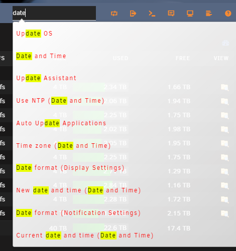

Updated it to support searching for individual settings within the GUI.  ie: You can search for "font" and it'll offer up Display Settings
