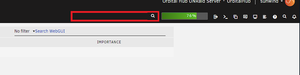

  • Yesterday's update changes things around a bit.   The search bar is no longer present under black / white themes.  Instead a search icon is present at the top right.  Press it and the sea

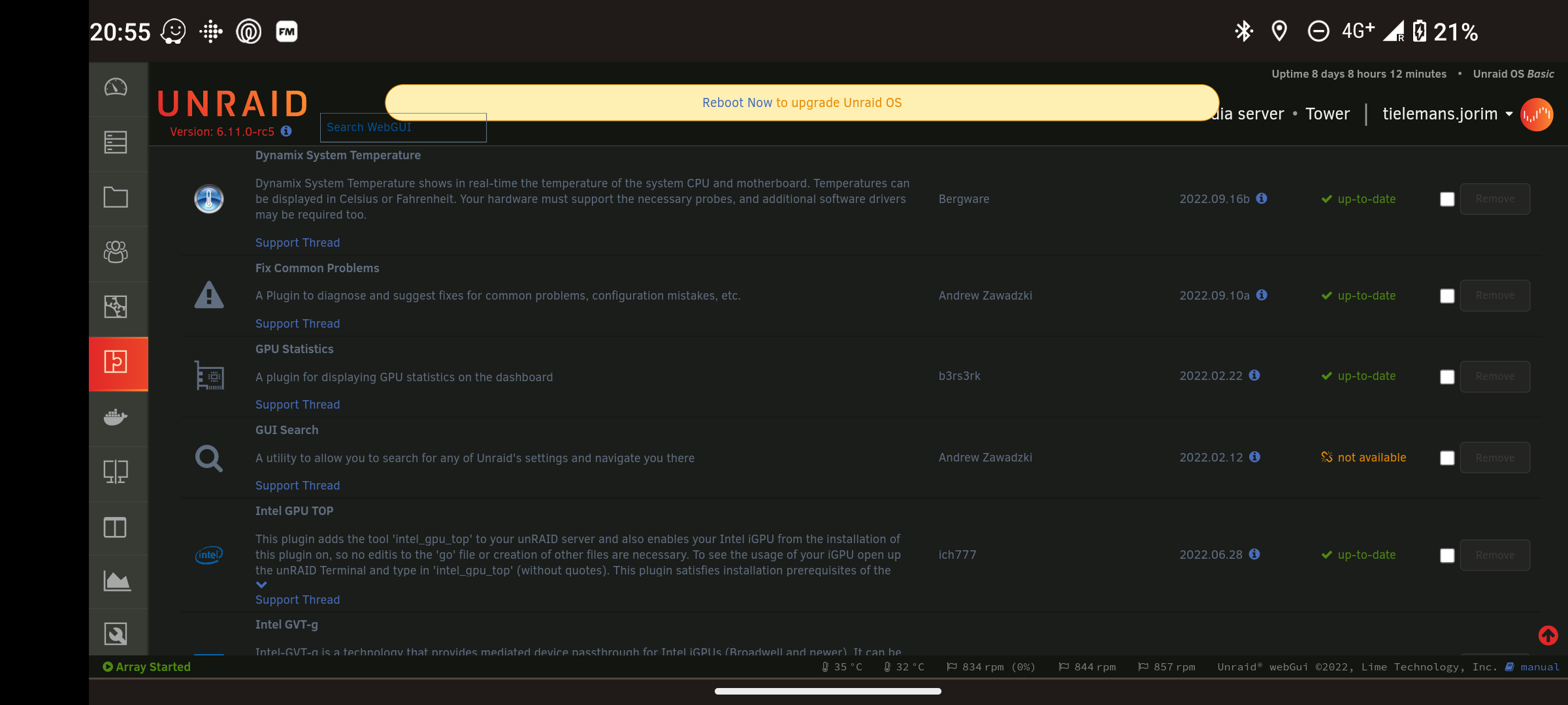

  • 7 months later...
Is the plugin still being developed? It shows as not available in the list for me. It is however, still available in the Apps list.
