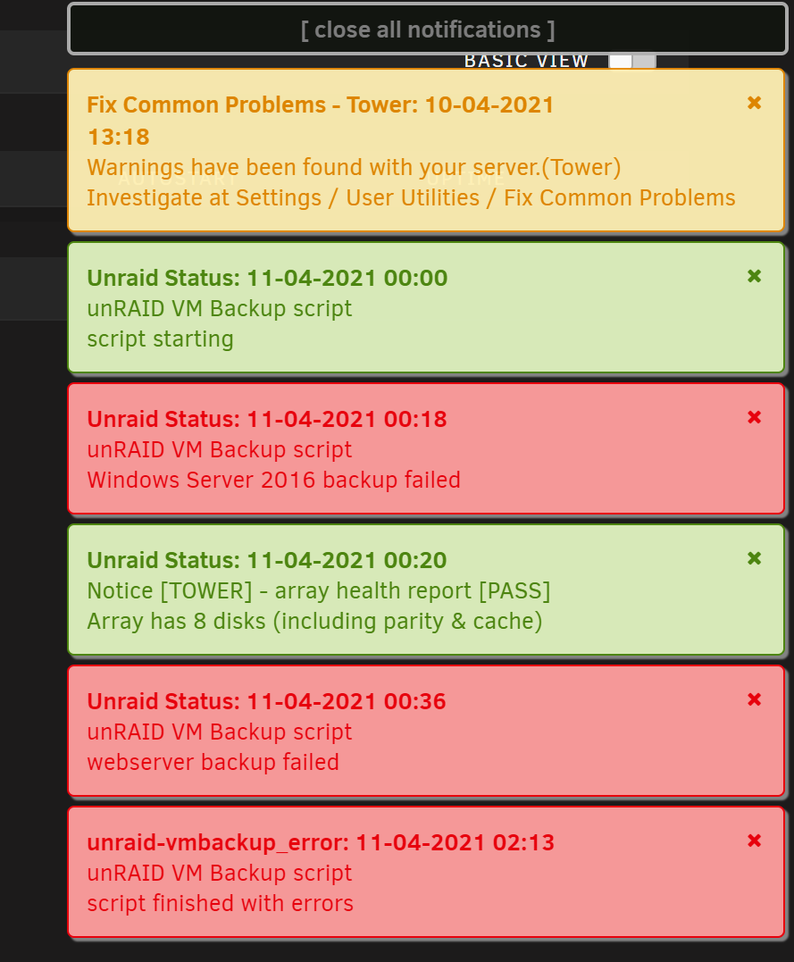

i thought it was the VM Backup   but that issue  says it creates a log  but i never can find it thats where i mentioned it  vm backup issues

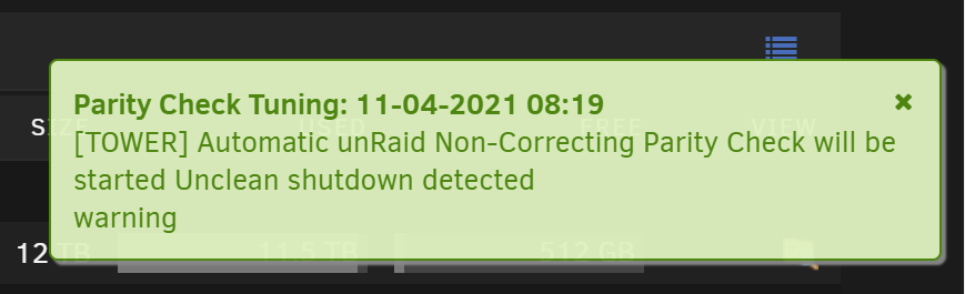

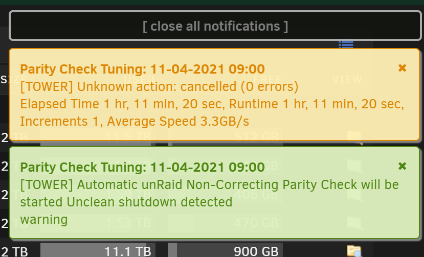

The diagnostics are after the reboot.  Was one generated (and sitting in the logs folder on the flash drive) at time of reboot?
Just a check - did the parity check actually start?   It is always possible that the Parity Tuning plugin incorrectly detected an unclean shutdown and the notification is misleading.    The plugin does not start the check itself - it just assumed unRaid is going to do so after an unclean shutdown and puts up the notification to indicate why.

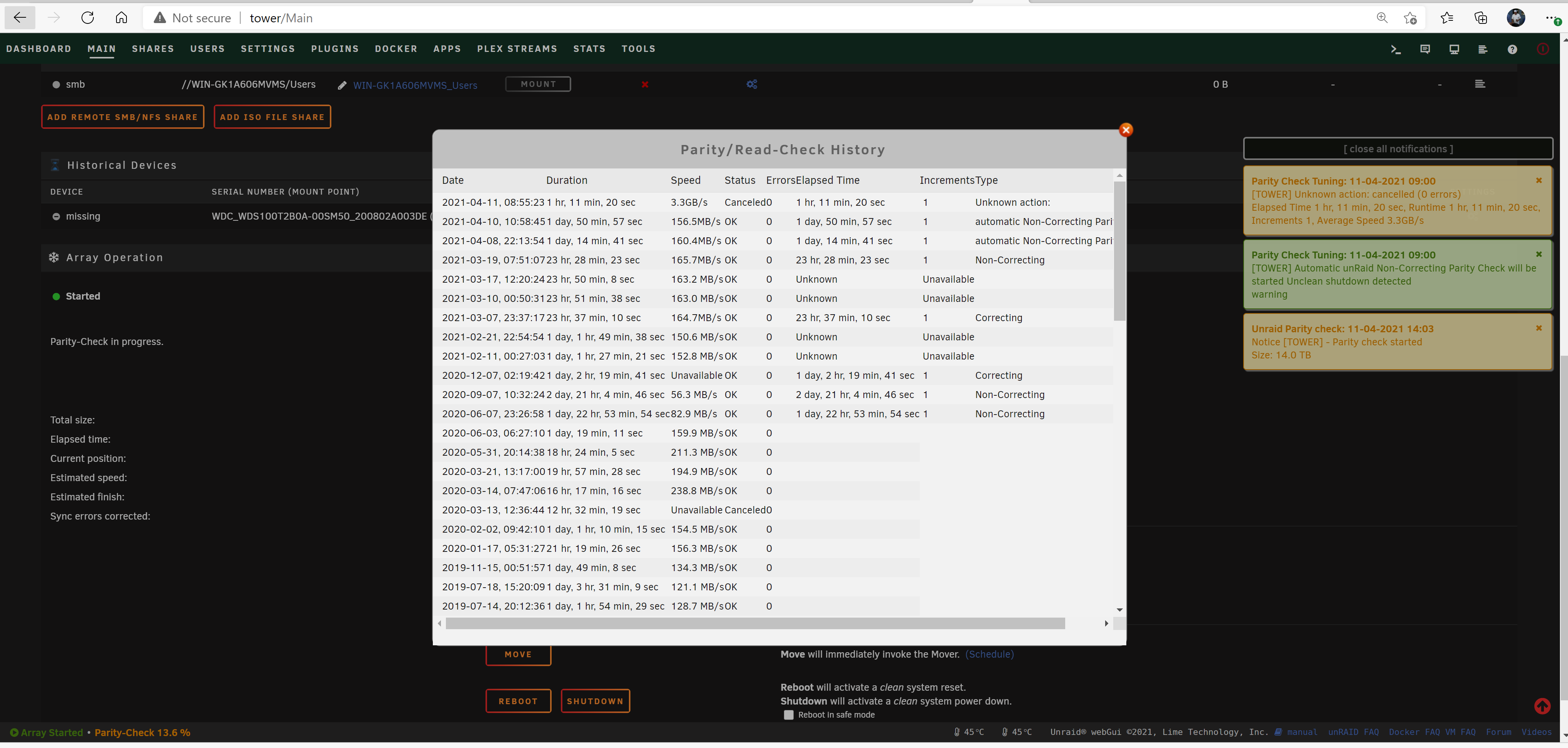

i then did a Reboot.. and then parity check didnt start back up  but it was running from the screen shot....  the screen shot is from after the reboot..  is the go file causing the problems?  at the time of my reboot it was at like 2.2% done parity check

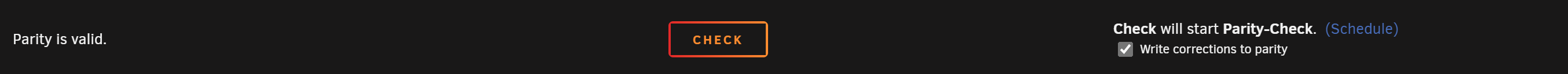

Whether scheduled parity checks are correcting or not is set under Settings -> Scheduler.    For Manual checks is set by the Correcting checkbox next to the Check button on the main page.    The automatic checks after an unclean shutdown are always non-correcting.
oh ok so the automatic parity checking after a reboot does nothing then?
as for scheduled  parity   i have it set for ever 3 months to run..
to do thid paritiy correcting    thats what that check box is for correct?   so i just click start  ...

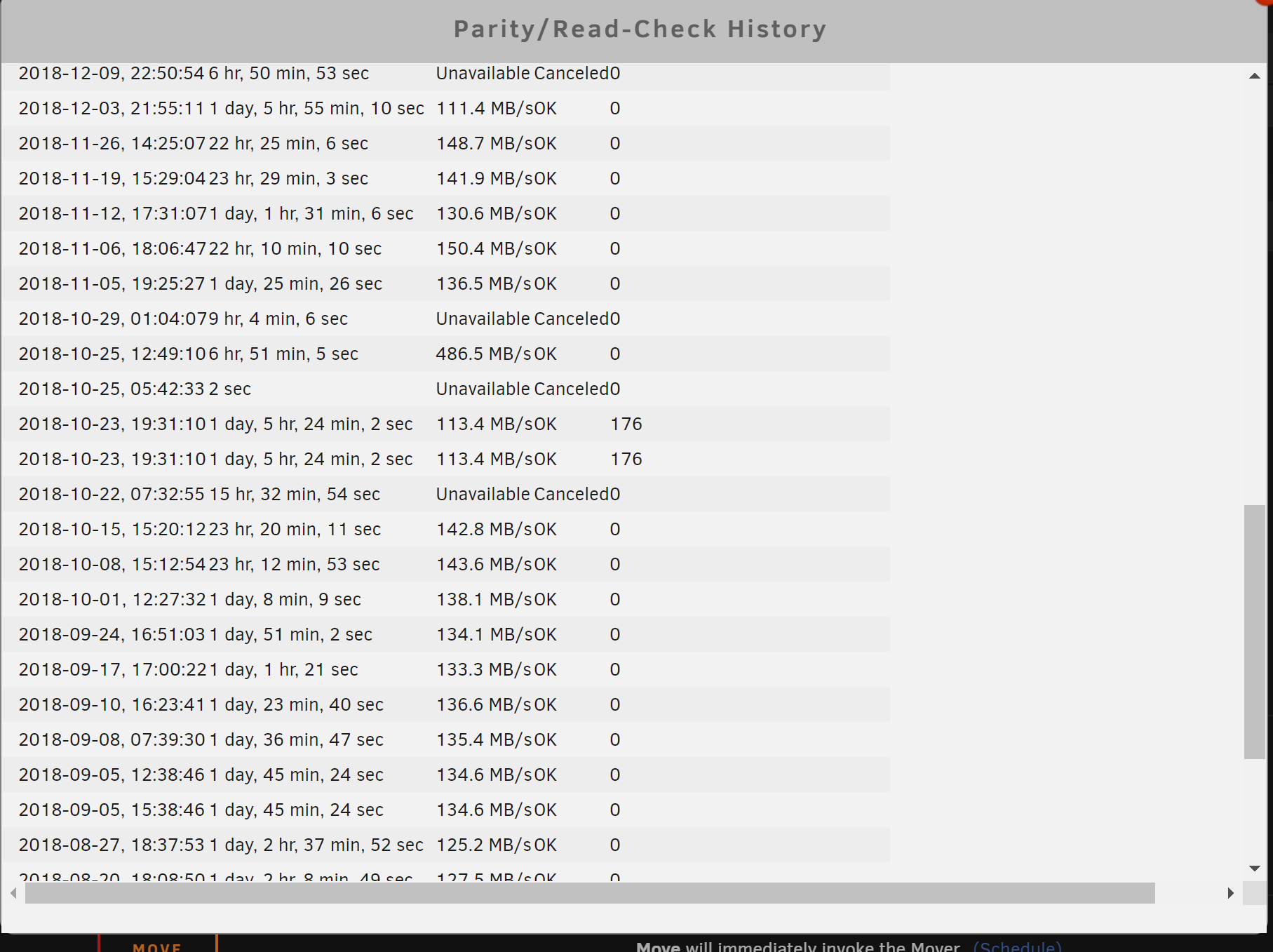

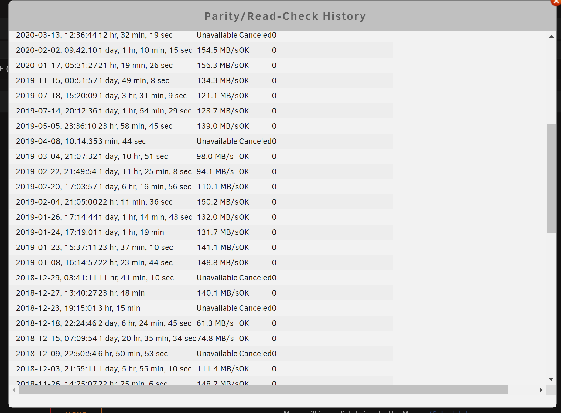

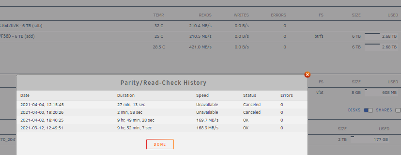

Go to Main - Array Operation and click History then post a screenshot.

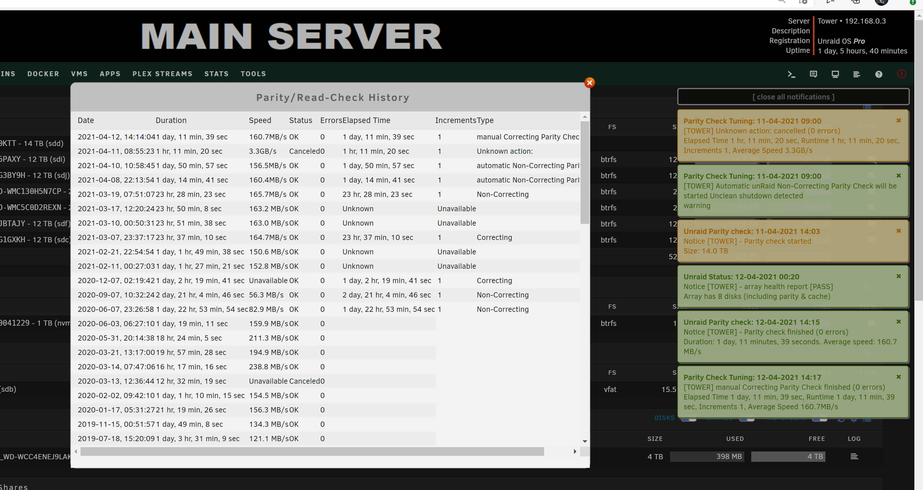

here is last 3 pages of the array history hope it helps
well i might as well let this parity correction run  since i started it  let it go till tommorow
what i noticed  from those   screen shots   i not getting over 200mb/s
but all my drives are 7200rpms  is unraid slow at times..  i know i read  that freenas is a faster data transfers then unraid
but i like unraid its user friendly.. but i noticed  shouldnt i be getting over 200mb/s  always?

Outer track of disk will be max performance, decrease with inner track.
Those are average speed figure, not record on max / min. BTW, it look normal and seems quit good.
There are many factor affect that, i.e. any other load on array, no of disks, different disk capacity mix or not etc ....
Below is a simple setup 1 data+1 Parity result, it will got best speed, strat at 210MB/s with average 169MB/s, 6TB complete less then 10hrs.
Edited by Vr2Io
ah ok so then what i get is fine wasnt 100% sure figure  i should got 200+  anywhere on the drive lol

alright its done the correcting parity  here is image
so whats the next step  to test why reboots cause parity checking.. and anything to do with why vm backup  as you can see wont backup..  from image from a couple posts ago

Remove VM Backup plugin
