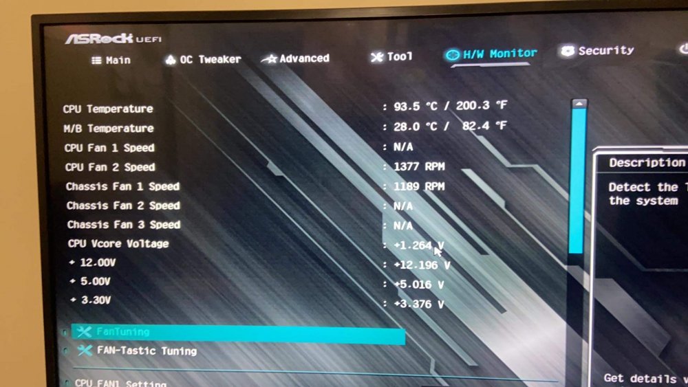

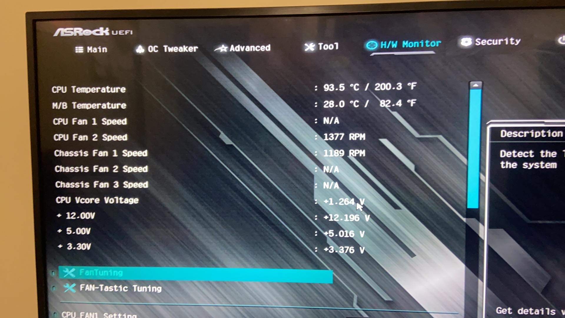

So I got to the root of the issue!
Looks like my AIO pump is dead! CPU temps just keep climbing!
Ordering a Evo212 right now!
