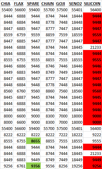

if you're going to run silicoin on the same install as chia and spare, you'll need to make changes to the config.yaml, otherwise it'll walk all over things.
wow, I see that. Explains why I could not get it to sync up.
Hopefully they will fix that, not worth restarting the server right now so I guess I will give them a few days to sort that out before resorting to manually editing it.
oh the green ones on spare, are the ones I changed myself, as the OEM values matched chia.
I use hpool so guess that is why I have not had issues with spare.
I dug into the config for silicoin... stay away. it's all kinds of wonky stupid in there.

Stupid like scam or stupid like lazy?
stupid as in, they didn't change things that needed changing, if you're going to run it in parallel with other farmers.

I keep having spare lose its daemon, and it stops passing plots.
also just noticed, spare and chain have the same UI port as chia.  probably not helping matters, so I changed it
spare 8322
chain 8422
