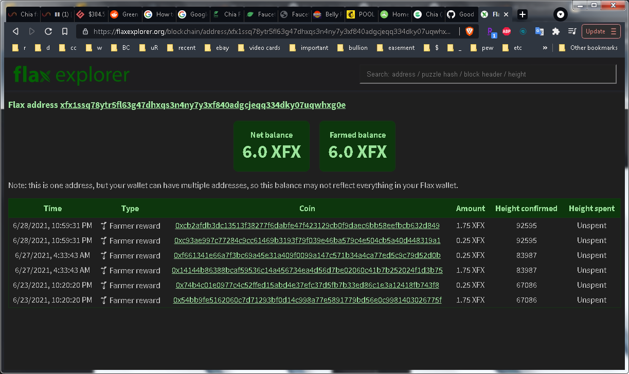

figured out flax.... going to the "wrong" wallet. :D
started flax when virgin, and it created a new wallet.  then I imported the mnemonic from chia, and thought it was storing coins in there.
probably the same for the others.
ah, that is more like it. lol, makes sense.

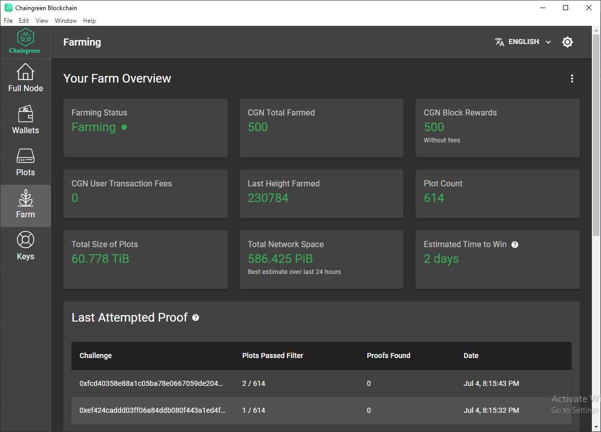

as of right now, flax, chaingreen, spare, goji, and seno are farming on one machine. (GUIs are being retarded, but I can see in the logs that plots are passing filter, so i'm leaving it alone for now.)
