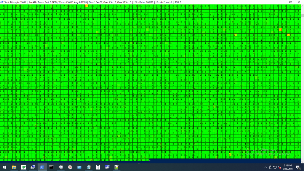

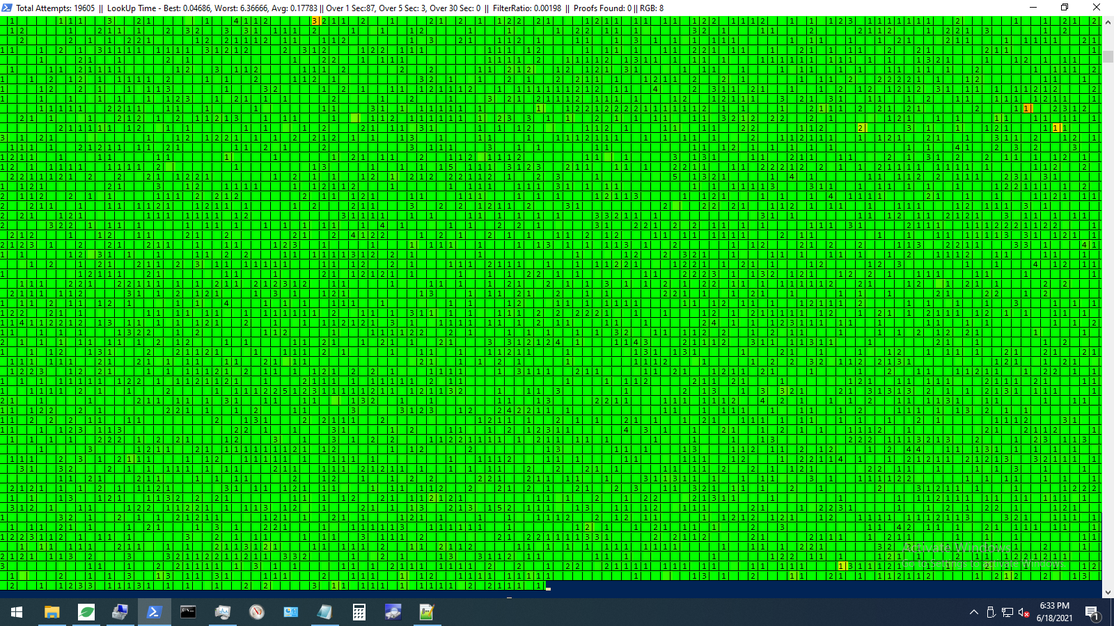

on some other news: my scripts continue to just plot along (pun intended.)
just watched 'monitor' suspend robocopy because a TMP file started getting copied to the staging drive on the one plotter.
plot map is getting nicely full with it finding a potential match every round.
