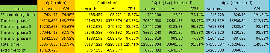

    Just a little FYI from some testing I am doing.   You can get some good plotting speeds with normal hard drives without the need to wear out SSD's.   With a regular 7200rpm 4tb sin
getting some interesting preliminary results from this latest run (16p1t).
phase 2 DEFINITELY suffers on only 1 thread.  total estimated time to complete is up about 45%, however the average plot time is DOWN 16%.
I also need figure out how to have a final plot staging drive on this machine, as having to ship the plot over the network is going to have a statistically significant impact in overall plot speed, since I can't start a new plot until completed one has left the drive, since they're only 300GB disks.  or... can I?  I'd run that test now, but i'm making changes to the plot parameters, as well as I want to reformat the disks to a different cluster size.
oh, and  P410 controller is slower than a P420.

interesting results, further shows that parallel is king.
Wonder what would happen if you over-provisioned the CPU with 16p2t or even 4t.
If you staggered the plots you could do 4-6t pretty easily I am guessing since the later phases would not be competing the threads.
That's part of what i'm planning on doing next.
reformat all plotter drives to 32k sectors. (worth potentially a couple % off total time)
change to 64 buckets (could be worth another 8%?)
6k ram per plot (no idea what that improved, % wise.)
stagger start plots in groups of 4 (undecided on time delay at this point though.)

And as for how buckets and blocks (memory) are related, this is just from some recent observations and deductions; take them with a grain of salt:
buckets are into how many pieces each phase dataset is broken into.  you ideally want your blocks (memory) to be big enough to complete the sort function entirely in memory (uniform sort).  if it's not, you wind up dropping to the slower (?) quick sort method.
so, if you have more memory, you can have fewer buckets, and it should be able to more quickly process the entire dataset.
i'm attempting to tune the buckets and blocks for each machine and type that I have here.
Very interesting, I will have to try cutting the buckets down as well since I have plenty of extra memory.
if you cut the buckets in half to 64, I saw various process lines saying the u-sort needed 6.5GB ram to work, and since it didn't have it was dropping to q-sort.  I'm setting my bucket size to 6656 for the next round.
watching this one machine, waiting for it to end so I can make some changes to it, I can see during phase 4, processor and hdd spikes are in opposition to each other.

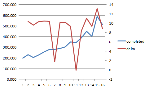

here's some raw data:
F1 complete, time: 197.843 seconds. CPU (187.92%) Sun May 30 08:49:38 2021
F1 complete, time: 230.411 seconds. CPU (184.9%) Sun May 30 09:00:04 2021
F1 complete, time: 204.651 seconds. CPU (185.32%) Sun May 30 09:09:39 2021
F1 complete, time: 228.132 seconds. CPU (186.65%) Sun May 30 09:20:02 2021
F1 complete, time: 257.852 seconds. CPU (185.06%) Sun May 30 09:30:32 2021
F1 complete, time: 281.433 seconds. CPU (184.08%) Sun May 30 09:40:56 2021
F1 complete, time: 281.054 seconds. CPU (183.65%) Sun May 30 09:42:39 2021
F1 complete, time: 289.449 seconds. CPU (179.14%) Sun May 30 09:52:47 2021
F1 complete, time: 304.029 seconds. CPU (173.73%) Sun May 30 10:03:02 2021
F1 complete, time: 350.178 seconds. CPU (150.61%) Sun May 30 10:12:21 2021
F1 complete, time: 345.094 seconds. CPU (155.06%) Sun May 30 10:12:17 2021
F1 complete, time: 389.805 seconds. CPU (133.09%) Sun May 30 10:20:39 2021
F1 complete, time: 449.83 seconds. CPU (115.89%) Sun May 30 10:31:43 2021
F1 complete, time: 403.385 seconds. CPU (125.08%) Sun May 30 10:41:05 2021
F1 complete, time: 588.592 seconds. CPU (88.76%) Sun May 30 10:54:15 2021
F1 complete, time: 512.601 seconds. CPU (100.09%) Sun May 30 11:03:06 2021
you can see the times degraded as more plots were brought online.  the start times got a little weird in the middle, as I accidentally killed the window that was managing the timing. what's interesting though the time delta between each ending plot, as if you "filter" the noise in your head you can see they're pretty darn consistent.
average was still 332.146, which is -410.03 from the baseline 8p2t blob storage run.

Doing a little excel wizardy I get this:
start		end		delta
8:46:21 AM	8:49:38		0:03:17
8:56:14 AM	9:00:04		0:03:50
9:06:14 AM	9:09:39		0:03:25
9:16:14 AM	9:20:02		0:03:48
9:26:14 AM	9:30:32		0:04:18
9:36:15 AM	9:40:56		0:04:41
9:37:58 AM	9:42:39		0:04:41
9:47:58 AM	9:52:47		0:04:49
9:57:58 AM	10:03:02	0:05:04
10:06:30 AM	10:12:21	0:05:51
10:06:32 AM	10:12:17	0:05:45
10:14:09 AM	10:20:39	0:06:30
10:24:13 AM	10:31:43	0:07:30
10:34:21 AM	10:41:05	0:06:44
10:44:26 AM	10:54:15	0:09:49
10:54:33 AM	11:03:06	0:08:33
So the run time for F1 matches what's being reported by the system, but there doesn't seem to be a major effect on the end time of the F1 process, even with nearly all plots deep into Table 2 bucket sorts.
