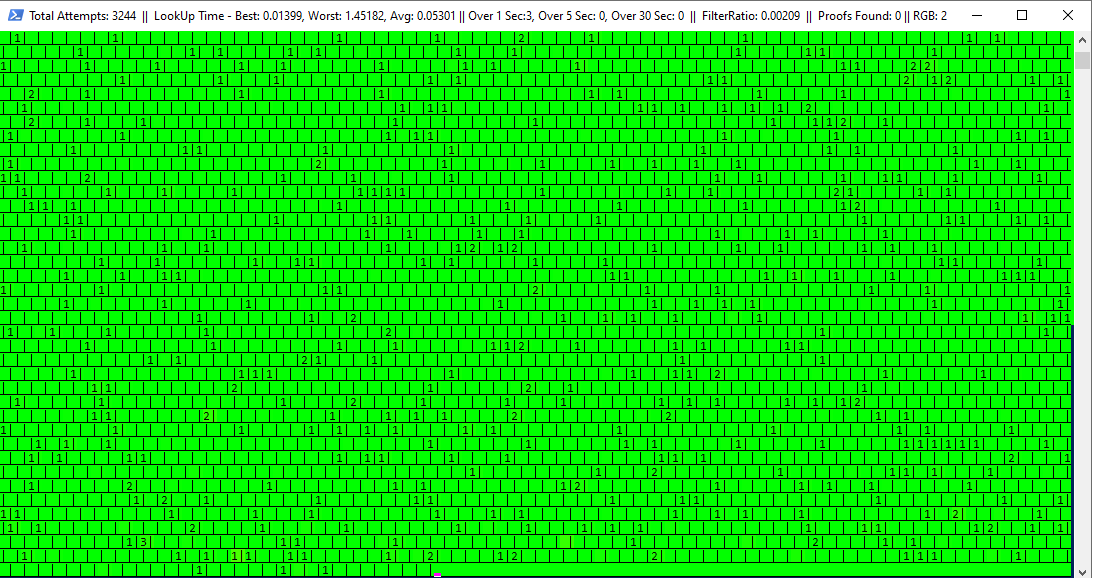

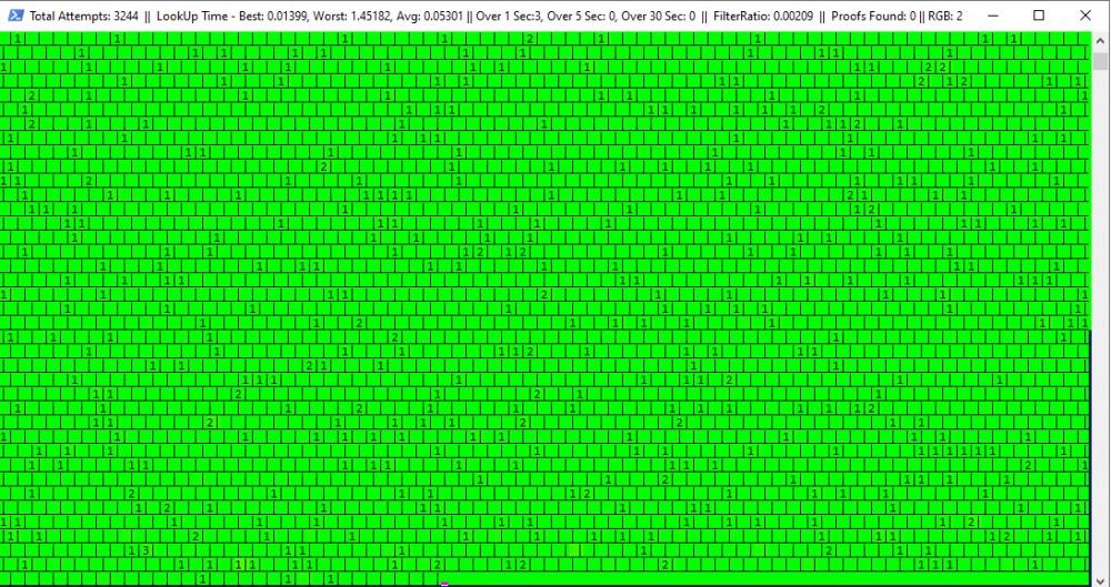

on a good note, it appears my farm is working correctly...
2021-06-02T17:05:25.332 harvester chia.harvester.harvester: INFO     1 plots were eligible for farming a6ac75822c... Found 0 proofs. Time: 0.19568 s. Total 81 plots
2021-06-02T17:05:33.364 harvester chia.harvester.harvester: INFO     1 plots were eligible for farming a6ac75822c... Found 0 proofs. Time: 0.18119 s. Total 81 plots
2021-06-02T17:05:43.342 harvester chia.harvester.harvester: INFO     1 plots were eligible for farming a6ac75822c... Found 0 proofs. Time: 0.08190 s. Total 81 plots
2021-06-02T17:05:52.879 harvester chia.harvester.harvester: INFO     0 plots were eligible for farming a6ac75822c... Found 0 proofs. Time: 0.04482 s. Total 81 plots
2021-06-02T17:06:00.708 harvester chia.harvester.harvester: INFO     0 plots were eligible for farming a6ac75822c... Found 0 proofs. Time: 0.05575 s. Total 81 plots
2021-06-02T17:06:09.485 harvester chia.harvester.harvester: INFO     0 plots were eligible for farming a6ac75822c... Found 0 proofs. Time: 0.03305 s. Total 81 plots
2021-06-02T17:06:18.858 harvester chia.harvester.harvester: INFO     0 plots were eligible for farming 57c2a69fb1... Found 0 proofs. Time: 0.33405 s. Total 81 plots
2021-06-02T17:06:27.611 harvester chia.harvester.harvester: INFO     0 plots were eligible for farming 57c2a69fb1... Found 0 proofs. Time: 0.04072 s. Total 81 plots
2021-06-02T17:06:37.191 harvester chia.harvester.harvester: INFO     1 plots were eligible for farming 57c2a69fb1... Found 0 proofs. Time: 0.28098 s. Total 81 plots
2021-06-02T17:06:49.360 harvester chia.harvester.harvester: INFO     0 plots were eligible for farming 57c2a69fb1... Found 0 proofs. Time: 0.03999 s. Total 81 plots
2021-06-02T17:06:58.574 harvester chia.harvester.harvester: INFO     0 plots were eligible for farming 57c2a69fb1... Found 0 proofs. Time: 0.04503 s. Total 81 plots
haven't won anything yet, but it at least it looks like I could.
