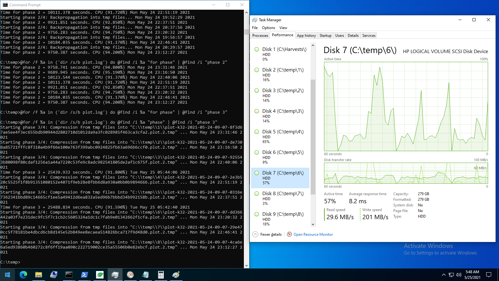

nearing the end of phase 3 right now.  that's one of the lower write speed peaks I've seen. 350MB/s isn't rare.
what I still find interesting is the inconsistency of phase completion across processes.  it doesn't seem to trend with any specific disk/excuted thread.  only thing I can think of is, the system's background housekeeping/foreground interface processes are asymmetrically latching on to specific cores/hyperthreads and causing contention.
Phase 3 should end within 30 minutes from now, and I should have the completed data from this run in by 7am, according to my estimates.

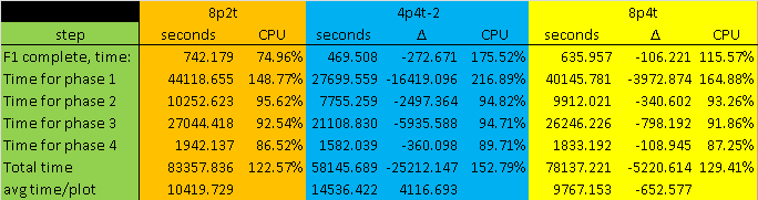

Here's what I mean by the inconsistency.  In every case, the group of plots was started within a second of each other, via script.
I highlighted the "flyers" in each group.

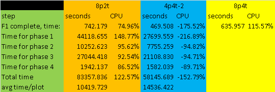

switching 8p2t to 8p4t shaved 1.45 hours off the total time for 8 plots.
4p4t is the fastest through P1 and P2.
-2 definitely helps P3 and P4 to charge through.
