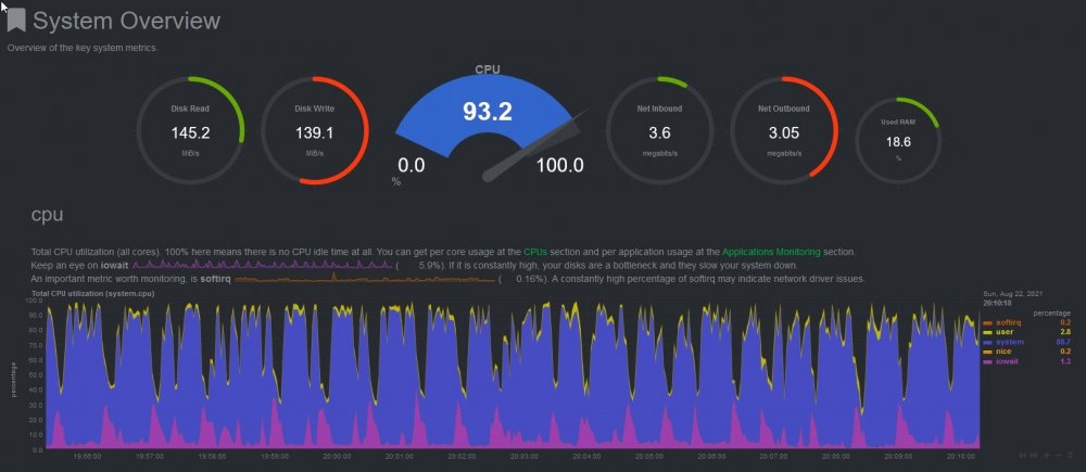

I have seen a lot of reports that plotting is faster on linux and BTRFS is faster still then most other file systems. You might try running Ubuntu and see what the plot times do.
The other thing is that the first stage is the only one that can handle mutiple threads, the rest are all single threaded, so single thread performance will play a big role there. I am running 2x 2670 CPU's which have a lot higher single thread performance then you, although surprised you can't get more as I am not even stressing it at this point, just doing basic tests until pooling comes online.
I also increased my dirty writes in linux to 90%, so it can use up to 90% of my available memory as a cache for writes to the drives, didn't seem like this helped a ton but it might of had a larger effect then I thought. It reduced the thrashing of the drives though.
based on my testing so far 3x parallel for a single drive netted me the best times per plot at 6.5 hours. If I was to do that on the 4x drives I am now testing in the raid, I would be around 2.2 hours per plot, a bit faster then the 2.5 hour raid0 performance of the drives thus far. Testing now with some staggering of the plots to see if that improves things.
So yes, using the drives individually does seem to net slightly faster speeds all else being equal but it is a lot harder to keep track of, so there is a trade off.
Watch the performance metrics of the system during plotting and you can find your bottlenecks. I use netdata on linux, allows me to log the whole process for later review.
I don't max out the single drives IO until running 3x in parallel per drive (on these fairly fast ~170mb/s drives). With 2x plots there are times when the drive activity drops to zero.
CPU limits the ability to plot a single plot any faster, thats why I need multiple in parallel to max the drives IO. I have 32 threads but they are ~7 year old threads, so they leave some performance on the table lol.
It is looking like my limiting factor will end up being memory actually as I can only run ~17 in parallel with 64gb of ram but can do a lot more then that with my CPU's and disks before those max out. I won an auction for some cheap ECC DDR3 the other day, gonna see what 128gb of ram does ;-) with ~25-30 plots running in parallel.
Yes I will be over-provisining the CPU but that is not an issue if I stagger the plots as only the first stage is multi-threaded. Plus worst case it slows down a bit.
Edited by TexasUnraid
