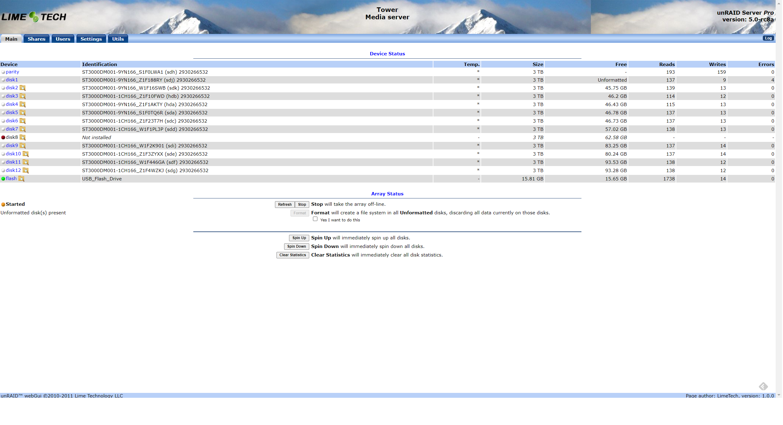

I got lazy about keeping up with my NAS for a few years and powered it on to check if it still worked. I have a 12-disk array with 1 parity drive and I was greeted to 1 drive showing "not installed" and the rest are fine (I think) though another is showing as unformatted.
-Can I check that the other drives are actually healthy when I cant start the array?
-How do I figure out why disk1 is showing as unformatted? I don't think thats how it should be.
-I ordered a new harddrive the same model as I was ordering previously, my understanding is I replace disk8 and it should try to rebuild the array with the other drives. Is that correct? What other steps should I be taking to get this back up and running?
Thanks for the support! :)

According to your screenshot the array is started.

That one is so bad it does make me concerned about your other disks though, since they will be needed to rebuild that one.

Repairing filesystem on disk1 might be more important than replacing that other disk if you need to get any files off.

Problem is that disk8 is already disable, so there will be some data loss.
Best bet IMHO is to use ddrescue to clone disk1 to a new disk, then you can try to rebuild disk8 using the clone as disk1, there will likely be some or a lot of data corruption on the rebuilt disk, mostly depending on how successful ddrescue is, you can also run reiserfsck on the cloned disk1 before or after rebuilding, no point in trying to run it on the failing disk1, it will abort due to i/o errors.
