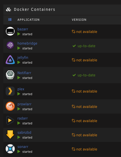

all docker containers lists version “not available” under update
I'm also getting this issue on 6.12.3, but I don't have any custom networks

I also have this problem on 6.12.4 and it seems to affect random containers. I don't see any difference based on what network the container uses or actual update availability.
Search has turned up very few mentions of this problem since 6.12.0 became available. Only solution I've found personally is to delete each affected container when this happens and reinstall. Has anyone found a better solution?

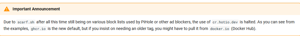

I'm similar in numbers 8 out of 15 all showing all are from cr.hotio.dev/<dockername>
Repo does appear to be up so I'm assuming possibly incorrectly that there has been a change made upstream and all dockers will need amending, maybe

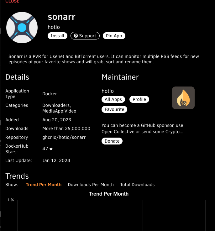

Just tried updating the docker config to use ghcr.io as opposed to cr.hotio.dev and that appears to have worked on my test
same for me only hotio's containers

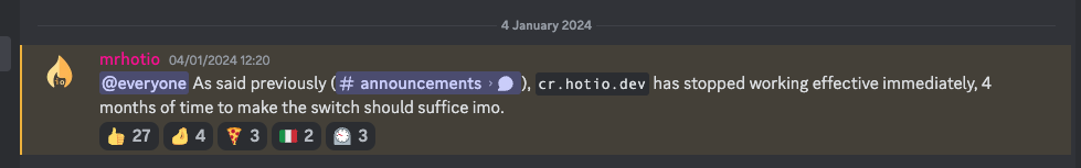

From their dev page.. explains that this is now to be expected.. Time to update the docker configs. @Tarnous
exact I'm on his discord
and on the Apps "store" depot has change it's now ghcr.io/hotio/sonarr, so I guess we must change this parameter
I've change manually the depot its fix now
