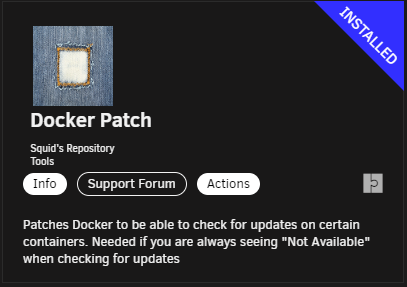

If you're having trouble with one or two apps that are "not available" then you should install this.  I was running Unraid 6.11.5 and I had problems with the MeTube app.

Unfortunately the patch is not offered to me via the App Store - what now?? I can't update to the current Unraid version at the moment for various reasons.

Maybe @Squid can help to point out what exactly needs to be done for you in 6.9.2.
This topic:
The applicable modifications to an OS file will be listed in there.  But much easier to simply upgrade the OS to 6.11 and then install the plugin instead.
Done and works as expected.
