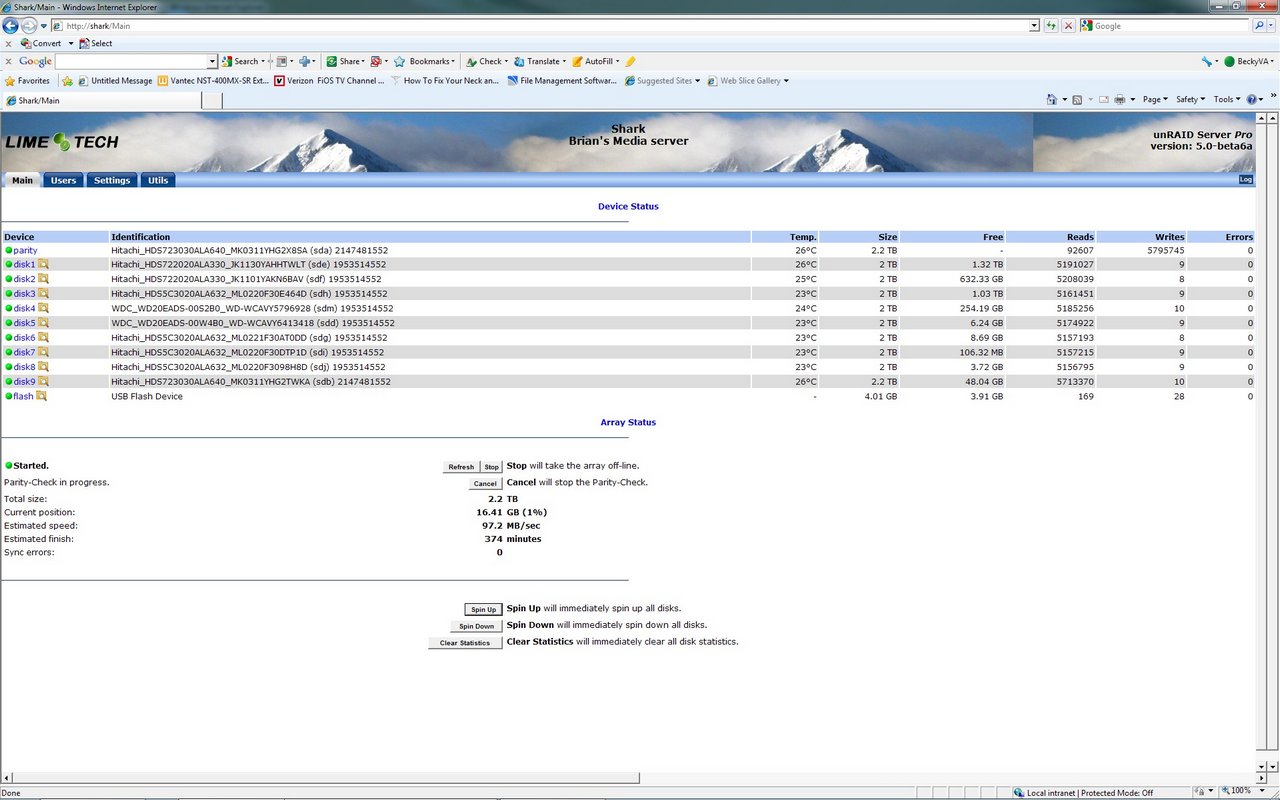

Misc Fixes / Bugs with 5.0 beta 6a:
1 - (FIX) It DOES now read temperatures from BR10i attached disks
2 - It does not know how to spin down BR10i attached disks
3 - There is a double scrollbar on the far right (see attached screenshot)
4 - The banner image is too narrow - when it repeats on the top it leaves an unattractive vertical line (see attached screenshot)
Check out the parity check speed (97 MB/sec).  Combo of motherboard and BR10i slots with combo of green and 7200 RPM disks.  I'm sure it will slow down, but this is fastest I have ever gotten!

I repaired the MBRs using the mkmbr program to what unRAID 5.0b6a expects. I rebooted the system and everything was recognized as expected. I rebooted a second time and everything remains recognized.
