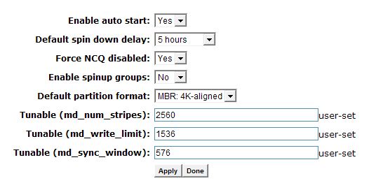

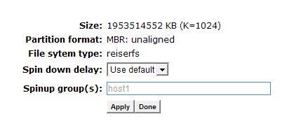

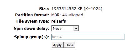

There is a problem with the spindown in 5.0b6a.
I have my default settings to spin down every 5 hours, and then my per disk settings of SOME of the drives (on the BR10i controller) are set to Never.  But unRAID is never spinning down any of the disks.  Spinup groups are also disabled.  I rebooted and waited overnight and drives are all still spun up.
There are no spindown messages in the syslog indicating that it is trying and failing.  I am running on the C2SEE-O motherboard.
Screenshots of the default disk settings, a disk on the motherboard settings, and a disk on the BR10i settings are provided.

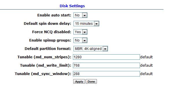

my disk settings as requested

disk7 MBR: unaligned
So apparently it's all the disks that unRAID believes are 4K alligned, that are seen as Unformatted, even though disk 2,3 and 4 are not adv. format capable..
Now to the serious issue.. Obviously, I didn't check the "Format" button as I knew there were about 8TB of data on the 6 disks, so I went ahead and reloaded my backup - discarding everything related to 5.0b6.
However, when going back to 5.0b2, the 6 disks still show "Unformatted" and aren't recognized by unRAID :(((
Where to go from here?.. Can the MBR's be fixed and if so, how?
