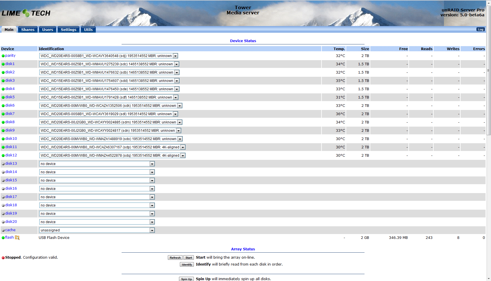

So, I've installed 5b6a to my unRAID server in the process of moving it to a HDD install vs the flash key, and am getting the MBR: Unknown message on almost all but my two most recently added drives... I will mention that the three most recent drives were cleared with the new preclear script and 4k-aligned, but only the two most recent ones were added to the system after I upgraded to 4.7...
I have saved the mbr debug info using the command specified in the other topic, if there's a way I can use that information to tell what I need to set the MBR flags using the command in the OP of this thread, please let me know...
Odds are it's LILO that slightly altered the MBRs on your drives. If possible, uninstall LILO and use GRUB. It does not mess with MBRs of your data drives. Since your drives were pre-4.7 they were sector 63 aligned. The following should correct the LILO bad-touch. Try -1- command first, then refresh the unRAID management console and see if that drive is now listed as MBR: unaligned. If so, proceed to the next drives.
mkmbr /dev/sdb
mkmbr /dev/sdc
mkmbr /dev/sdd
mkmbr /dev/sde
mkmbr /dev/sdf
mkmbr /dev/sdj
mkmbr /dev/sdk
mkmbr /dev/sdl
mkmbr /dev/sdm
mkmbr /dev/sdn
mkmbr /dev/sdo
Done... They appear to show up properly now, and the array is started, now I just have to get used to the new way of doing permissions, after the chmod/chown script is done... Is there a thing in the wiki to clarify what setting I should use if I want RO for all, and RW for specific users?
