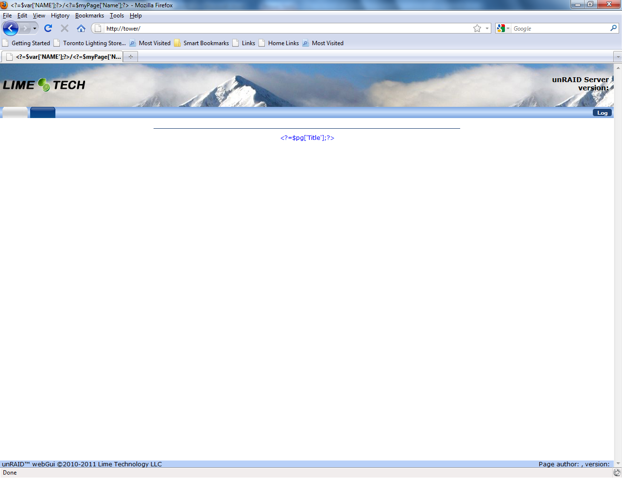

Has anybody seen this after upgrade from 4.7?
I've followed the instructions in Release Notes.
Basically, the GUI is broken after the upgrade as shown in the attachment.

Do you have any 3rd party utlities/php servers installed? Essentially the PHP server you're running isn't recognising php short tags.
Thanks! It was unraidweb package.

Yes, you yourself broke it with the installation of one of the add-ons that also install "php"
The fix is simple, you need to add a line in your "go" script to enable the use of the short-tags in the version of php you installed.
see here:
http://lime-technology.com/forum/index.php?topic=10925.msg103866#msg103866
