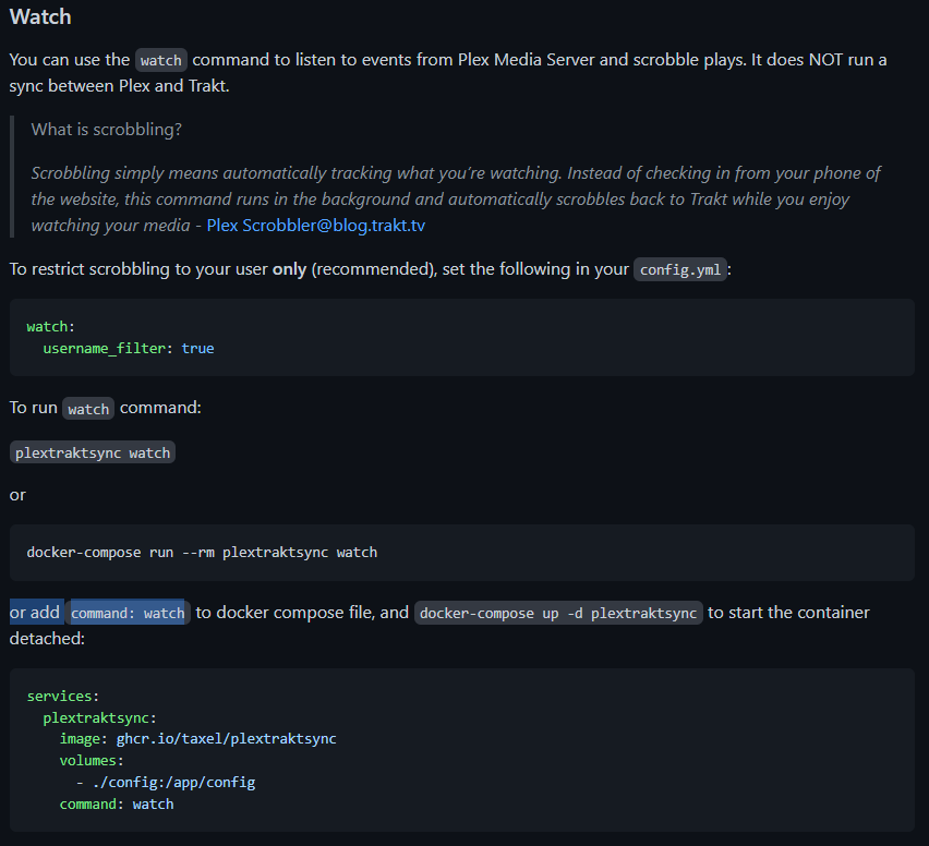

September 17, 20224 yr On 8/13/2022 at 9:00 AM, Azarog said: i'm pretty sure it's normal as you should cron schedule start it because it syncs at startup i think If you want PlexTraktSync to watch / actively scrobble, are you meant to add "watch" to either your container template post argument or as a separate line in the script? Referencing this part of the setup I have a cron setup as custom at 4a daily (0 4 * * *): #!/bin/bash docker start PlexTraktSync Edited September 17, 20224 yr by Linguafoeda
September 29, 20224 yr i think, yes. to my understanding the container starts, runs and stops until you want it to do it again.
