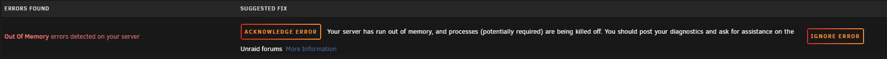

Hey Guys,
I got a "Out of Memory" Problem with my Unraid.
Jorge told me that i can try a Swap File / Plugin.
But I dont have a clue what that Plugin exactly does and what Cons I might get when using it.
Would this Plugin help me get rid of that Error?
If yes, maybe someone here can tell me what I need to do without breaking my Config/Machine?
I'm really afraid of losing it :(
Thank you in advance

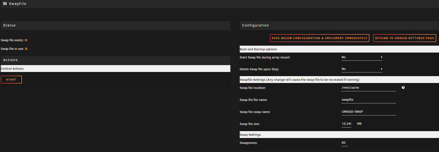

The Plugin wont work for me. It doesnt install the swapfile properly i guess.
When i clock "Save below.... and install" it still shows the red X on the left side.
What did i do wrong?

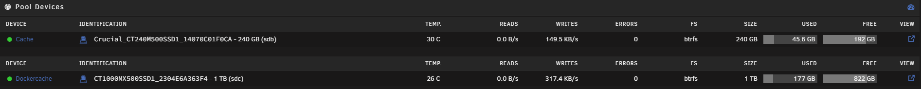

I read in the help that it wont work on cachepools.
Im not running a pool, but i do run 2 seperate caches.
What do i do wrong? Can u help me out here.
Thx again.
Thx again.
The swapfile cannot be placed in the root directory of a cache drive on BTRFS. It must be placed in a subvolume. Best to specify a directory that does not already exist and allow the plugin to create the subvolume itself. I would suggest something like '/mnt/cache/system/swap/' Click the little help icon next to the location for further information on swapfile placement.
I would also recommend setting swappiness to something lower than 10 (i use 1) and setting 'start swapfile during array mount' to true. Finally you will need to click the start button to start the swapfile for the first time.
Thank you very much.
The File got created, but it cant be used for some reason.
When i click start, nothing happens, just a quick reload of the plugin site...
Edited by Zeench
What does the system log say?
Just this:
6 hours ago, Zeench said:
Just this:
That would seem to indicate that the swapfile is active. On the command line you can run 'swapon -s' to confirm. Weird the that webpage does not update.

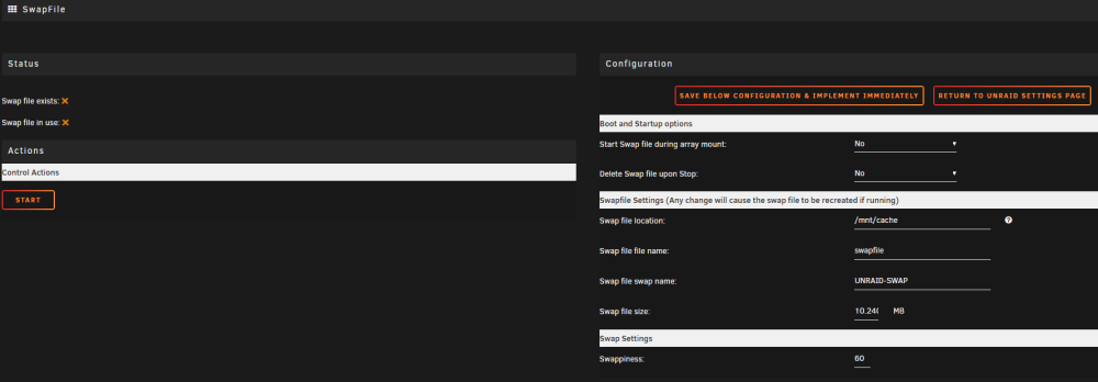

Strange, it really seems to be in use.
But the Page still shows
While you guys were writing about the size.
I put mine  to 10GB, it doesnt have negative side effects to have it this big, right?
