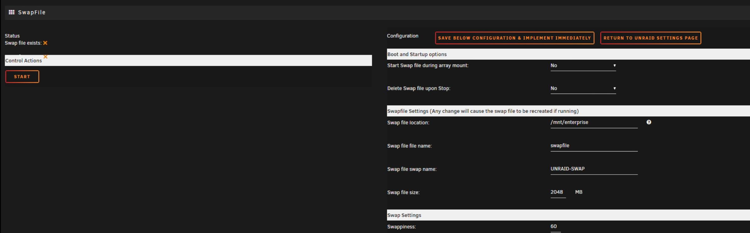

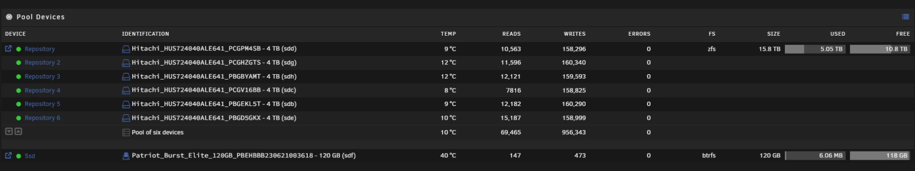

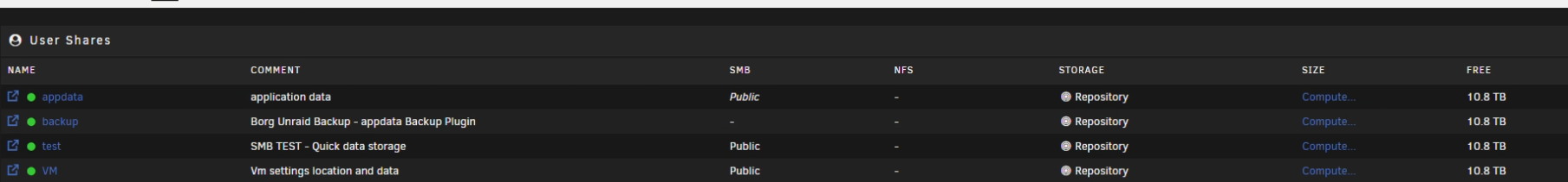

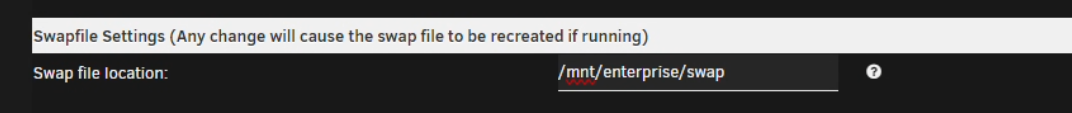

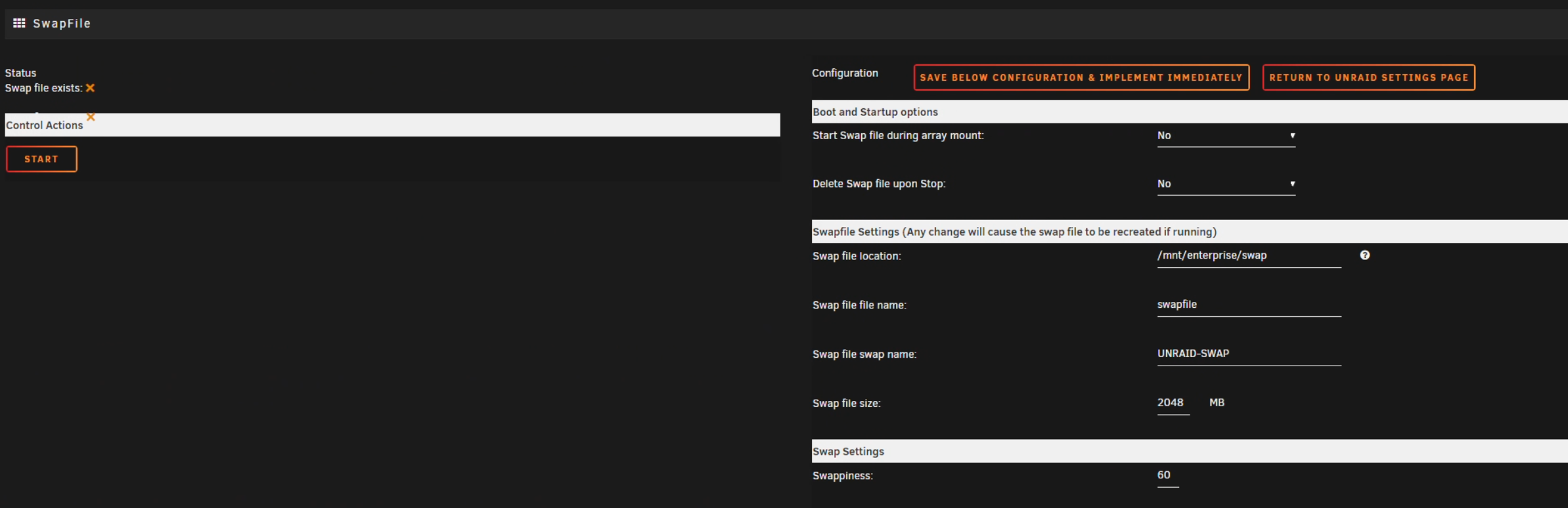

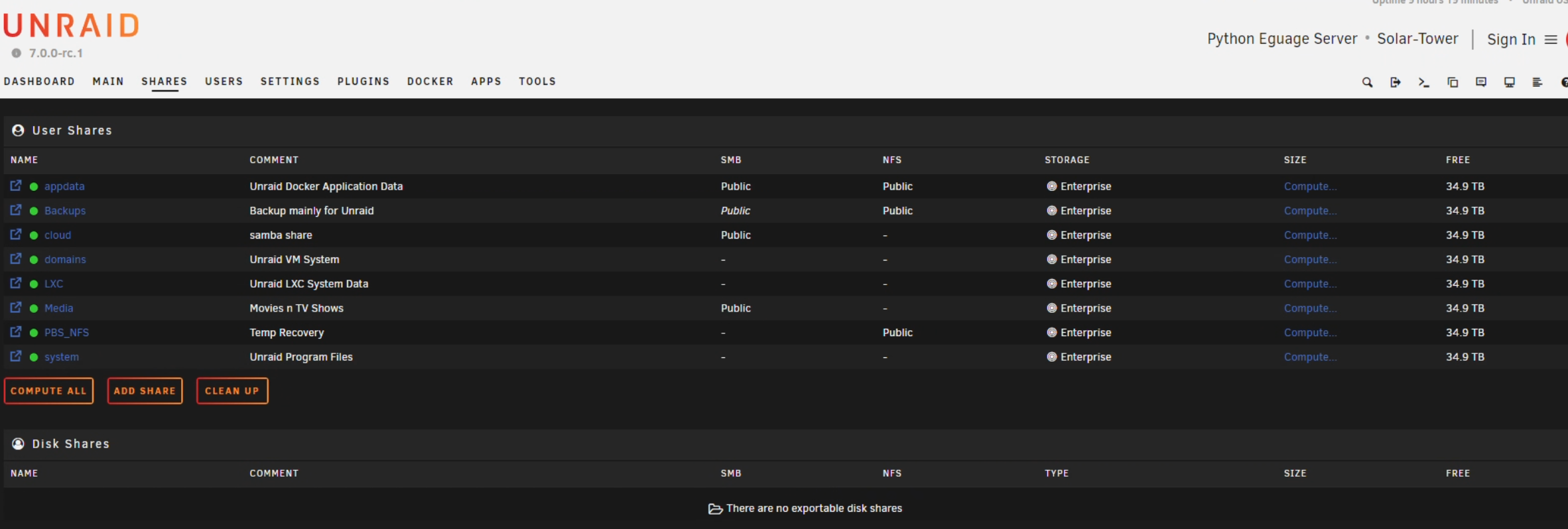

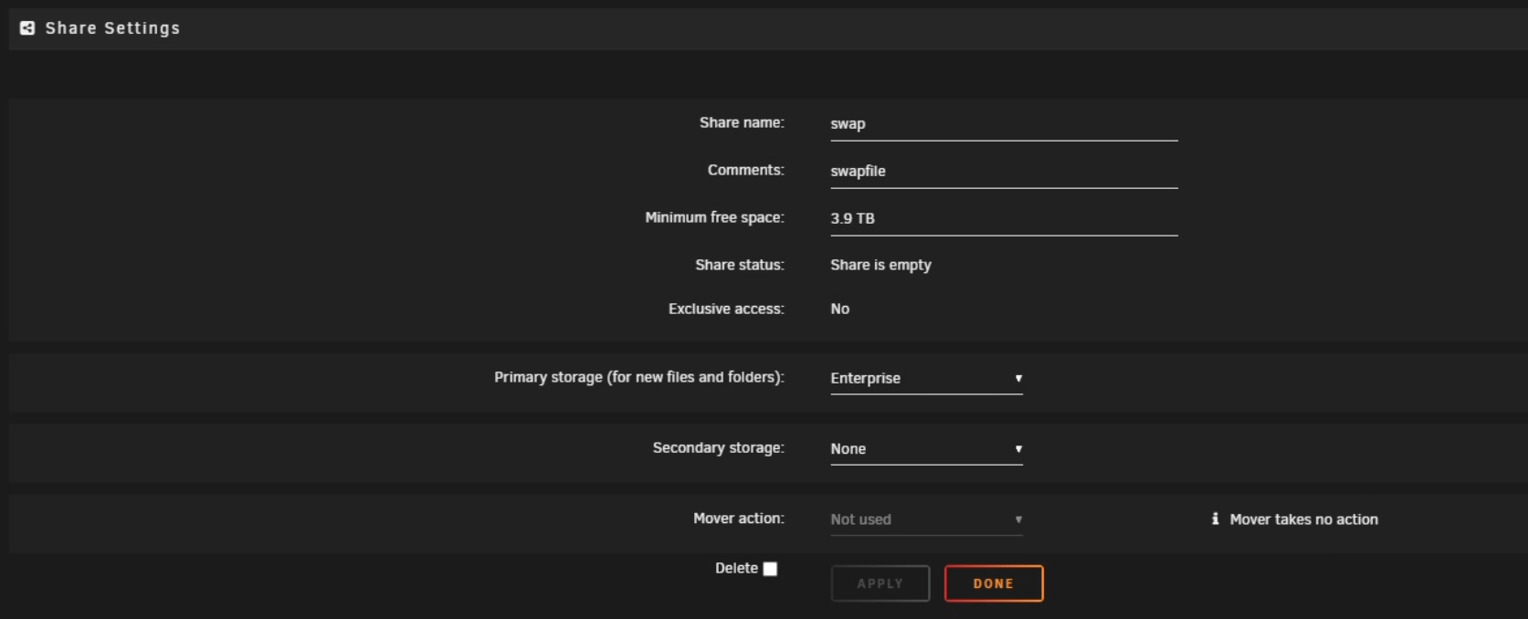

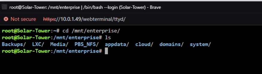

would like to see an update espcail on the web display for this plugin:
fresh download:
make the folder i want it to be on...
Save and impl;et the setting:
dead.
It will not make the folder...
I can premake this then...
now i have a share fodler called swap and must run my user scirp[t to fix for a work around...
v7 rc1 bug idk, idc... regradless its a problem/fixable...

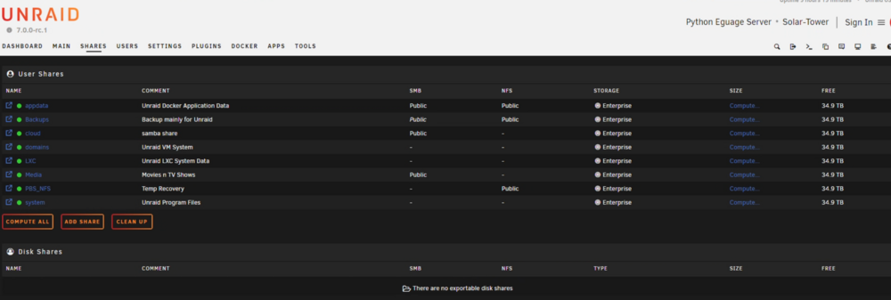

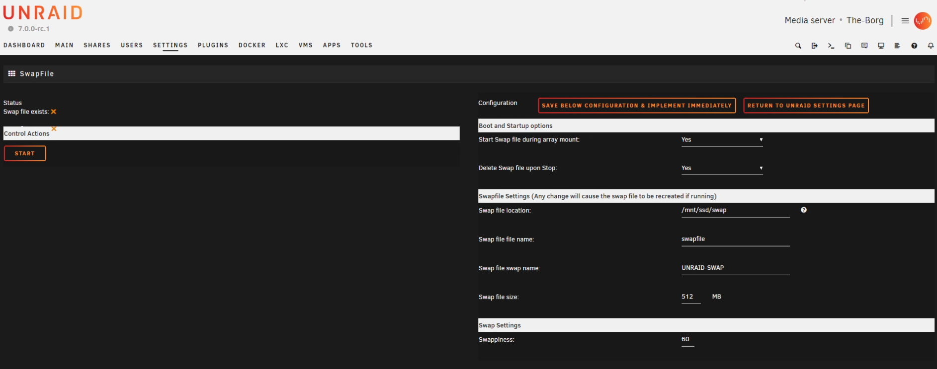

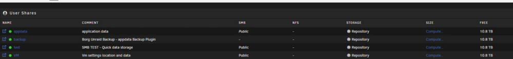

Above was a bad example that one is zfsa only ... this is a good example fresh downlaod for the borg:
no share exist:
no array pool devices only:

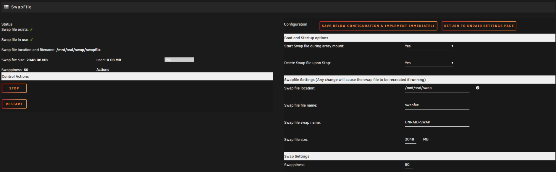

huh... weird inconsentcy with other v7 rc1 borg worked as it should...
saved configuration and then hit start...
