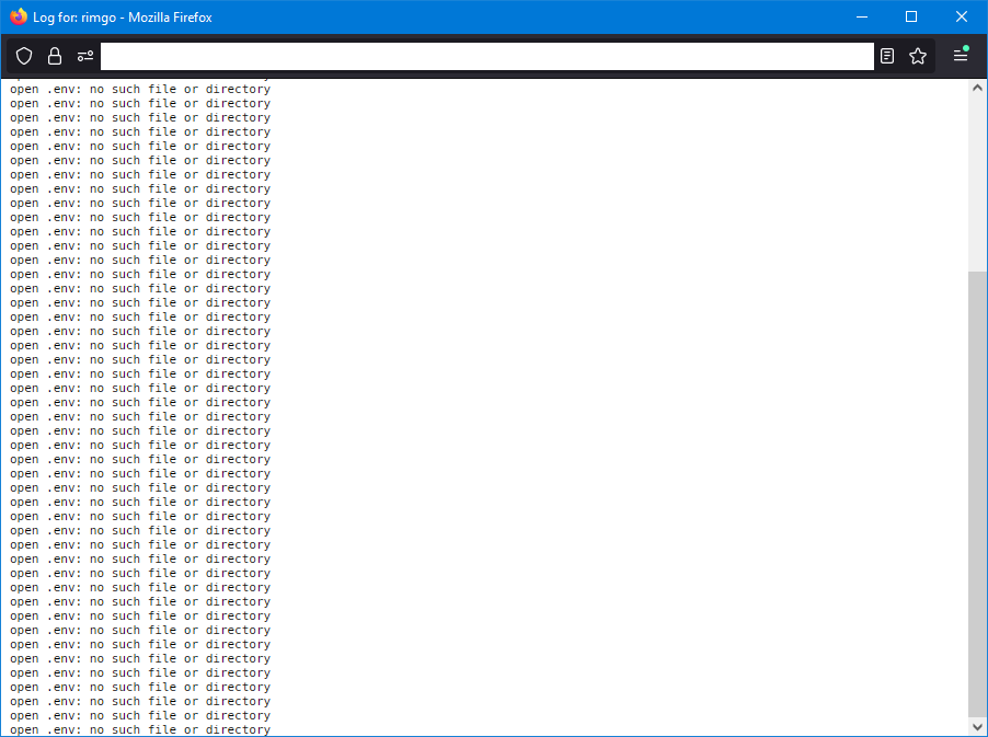

Hi everyone,
I seem to have an issue with Rimgo! It's a fresh install of the docker, but the log is on repeat, displaying
"open .env: no such file or directory"
Going into the docker does not work [for me] as the console returns with
"Error response from daemon: Container 7bce39507dace8589564a4c3e312cfb53b56e593150e3d11b5ffebb578ff9655 is restarting, wait until the container is running"
There is nothing restarting, the docker seems to be running. But I guess the message is related to the software repeatedly searching for the .env file.
Normally, one can go into the docker and make the file or add the file in the appdata/[product] folder, but I can't do anything withing the docker and there is no appdata/rimgo folder.
Do I miss something [probably pretty obvious]?

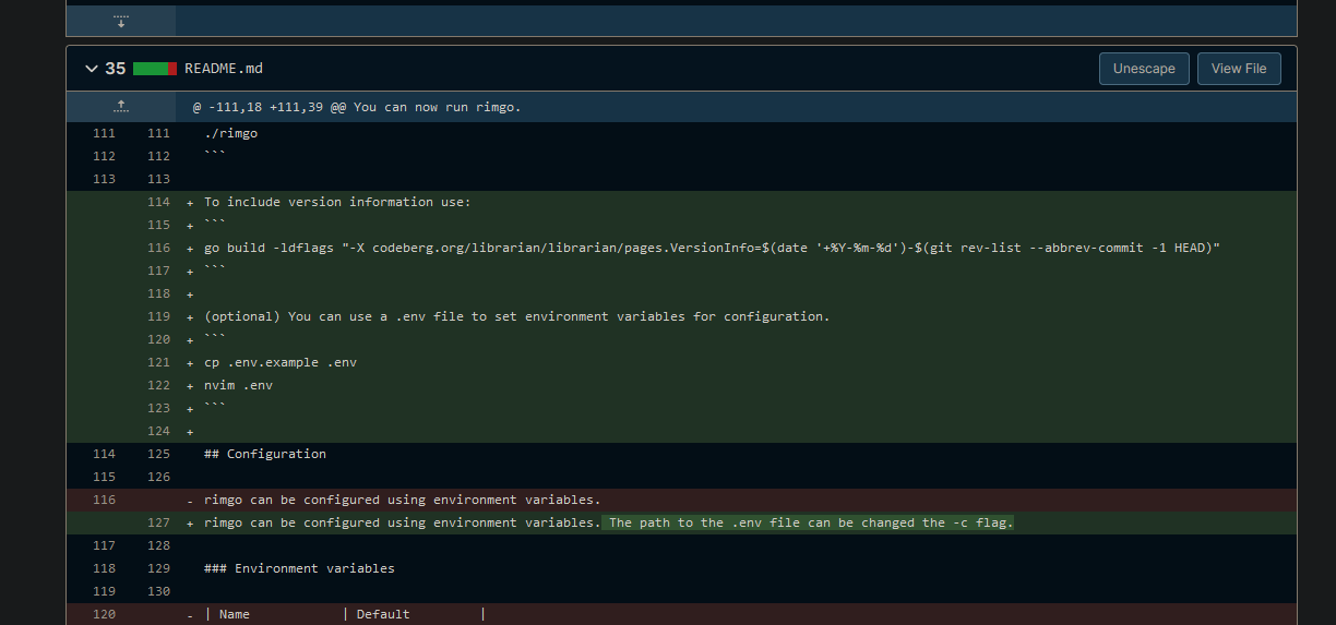

Rimgo only needs the .env to set configuration during deployment.
We are setting the environment flags within the template.
This is the commit where it was added to the source.
We have no need for the -c flag... we are running the prebuilt docker image.

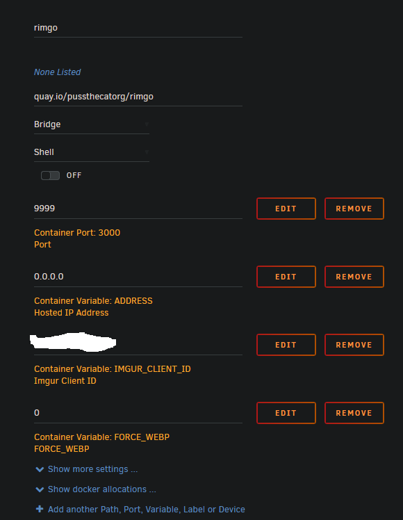

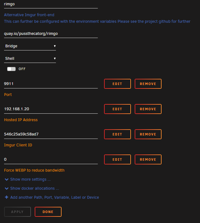

For sanity I have nuked my rimgo, deleted everything and redeployed... Nil issue running and home page listed is the same as the official listed instances.
Looking above... is your listed IP address correct for your 'Hosted IP address'?
I am also running as a 'bridge' network.
I have mine set as 0.0.0.0
Alright, the IP address seemed to be the culprit. The 0.0.0.0 setting had confused me, expecting me to enter the server's address where it is hosted. It's working now.
Thanks!
