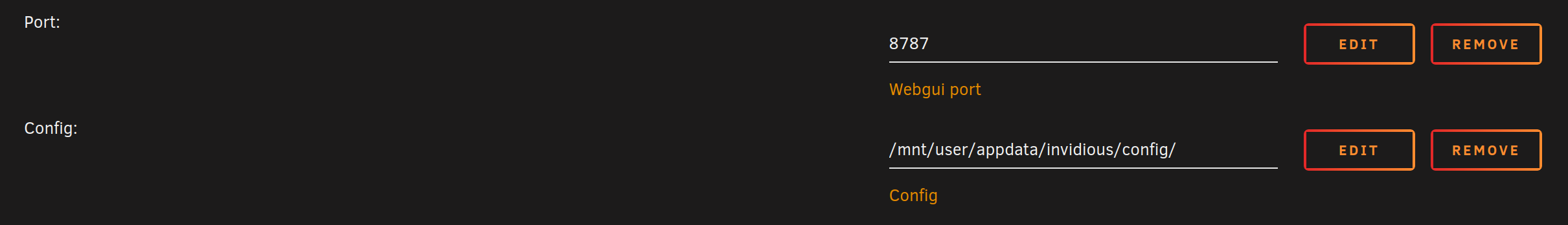

The only way I could get it to work again was
/invidious/config  -> /mnt/user/appdata/invidious/config/
Is that what your referring too?
I can confirm this was my missing piece. I was able to instantly get this running through your directions using a custom network.  But I wanted to route this container through one of Binhex's VPN containers.  Once I changed the container to none and routed through the VPN, it never resolved 'postgres'.  I kept changing the config to host IPs / container IPs with no luck and was stuck for a while.  - I should have read through the posts.
Making the above change fixed my problem instantly. The moment I changed the path variable and restarted the container it picked up the IP and instantly loaded.  Invidious looks like it works through a reverse proxy wither or not it has the port, domain or https_only config values set.  I'm guessing it doesn't correctly link without them set, and instead would give the IP:Port/video id.  But since it looked like it worked, I assumed it was reading the config.  Knowing this, it most likely would work on bridge connections by directly pointing to the postgres container IP.
Anyways, thanks for putting this container together!

I have learnt something else new in that it appears that if you update the template with changed mount path locations the updated template does not remove what you already had set while it adds the new one, causing what you are seeing with the dual configs. I guess this change is more helpful for new users rather than existing people.
I was able to delete the duplicate config path location from the edit screen, with reboot, and invidious was working as it was before.
This is mine for reference.
1660148209_Screenshotfrom2021-10-2014-25-34.thumb.png.2f119cfcbfed2c27d47892f18195012c.png
