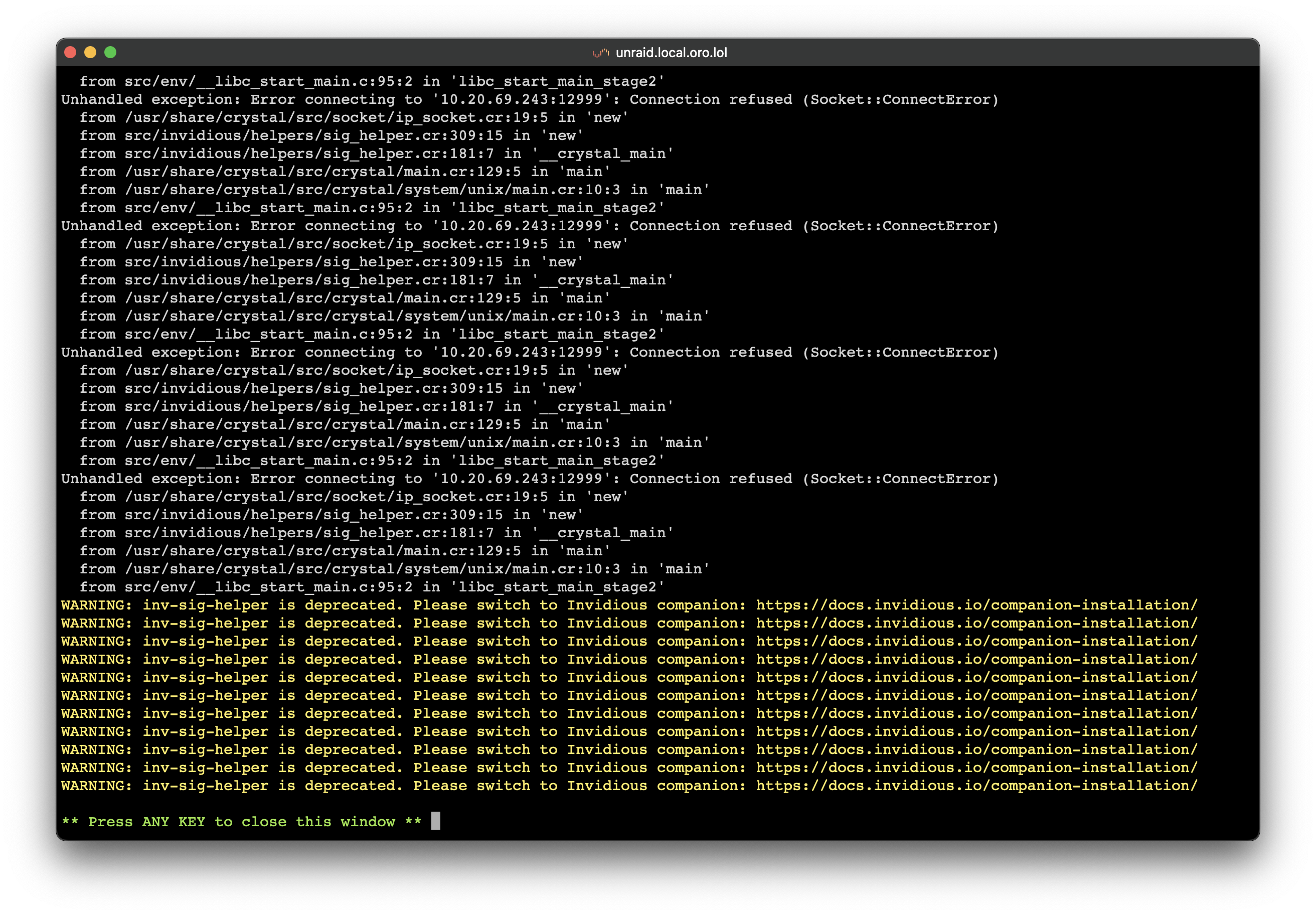

The companion doesn't seem to work for me as I'm still getting `The media could not be loaded, either because the server or network failed or because the format is not supported.`
never mind, it works fine now after I fixed my reverse proxy and opened up my companion since it seems the browser needs to connect to it

Hello & Thank you everyone. I also got invidious working thanks to everyone's help and great info here.
I have it working with both inv-sig-helper & the companion.
I also have a question on SERVER_SECRET_KEY & invidious_companion_key meant to be the same . ( I have the invidious companion created via the docker UI)
I know hmack_key needs to be created with "openssl rand -hex 20"
I think SERVER_SECRET_KEY & invidious_companion_key need to be created with "openssl rand -hex 8" ? is that correct ?
Are we meant to use the same key for both of these or 2 separate random keys.
The inv-sig_helper plays almost everything with no issues.
I expected the companion to be better or at least as good, but with it, it does not seem to play some of video that sig_helper plays . ( I would say - it plays maybe 50% of the videos). The same video plays using in-sig-helper; but not with inv_companion.
Is this expected behaviour ? or is there something wrong with my setup.

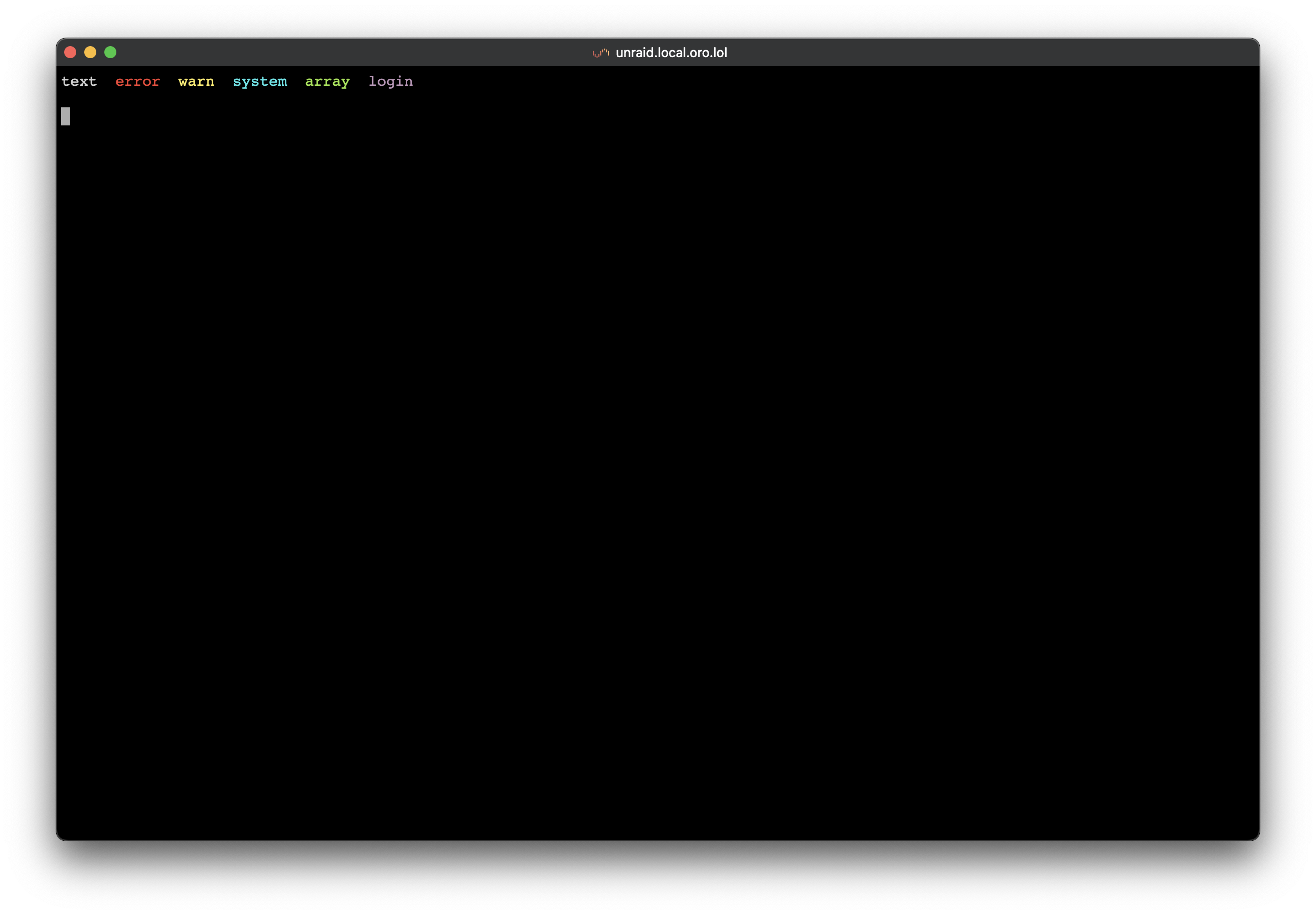

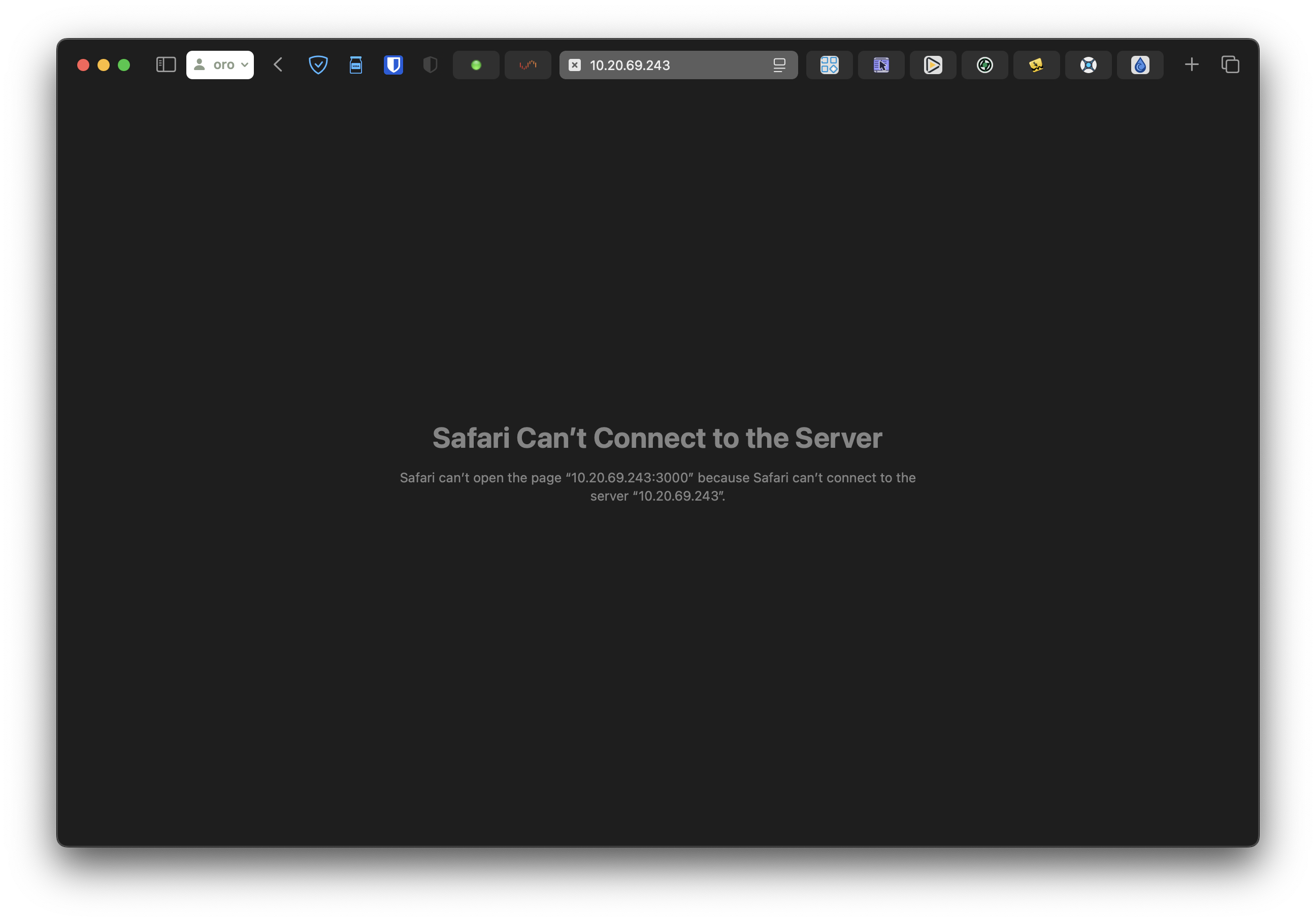

My Invidious instance recently stopped working and i haven't been able to troubleshoot it on my own. Unraid reports that the container is running but when i attempt to view from my browser, i get the message that it's unable to connect to the server.image.png
When i try to inspect the logs, i get this empty screen that auto-closes after a few seconds image.png
If i open a console into the container, it immediately closes.
I tried removing the container and docker image and reinstalling but i got the same result.
Is there anything else i should try to troubleshoot?

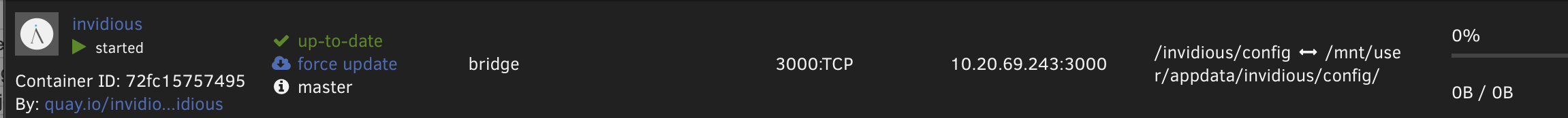

The issue seems to be the sig helper container. If you want to see logs stop the container first, then check logs. My sig helper container is showing some Javascript errors which seems related to the news of Google killing all those recently.
Thanks for the advice. i was able to see the logs by stopping the container and it looks like the issue was invidious sig helper was deprecated.
So i switched to using that with the Docker Compose template from invidious's installation guide and got it working again.
