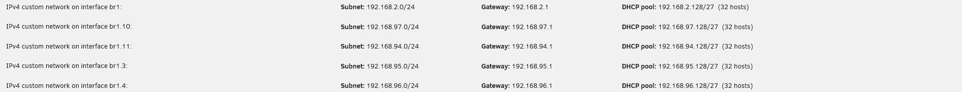

August 16, 20215 yr On 8/12/2021 at 10:26 AM, wgstarks said: I have a docker container that I’m setting up (locast2plex) on br0. I want to reserve a static IP for it on my pfsense router but I’m unsure how to get the MAC used for this docker? Docker containers don't actually get their IP from the network DHCP server. the docker engine assigns them in order based on the pool you've set in the network config. Its your job to configure it so that the range will be outside of your DHCP pool (or have a way to ensure they will never conflict) Here's my docker networks (w/VLAN): The network is constrained to get IPs from 192.168.2.128-192.168.2.255 (my DHCP range is outside that range) If you want each container to have a static IP, you can use just set the desired IP in the container settings On 8/14/2021 at 3:52 AM, wgstarks said: Can I run multiple docker/vm’s on br0? You can connect as many containers or VMs as you want to the network interface, just take care to avoid dynamic IP assignment collision between the containers and the DHCP server.
