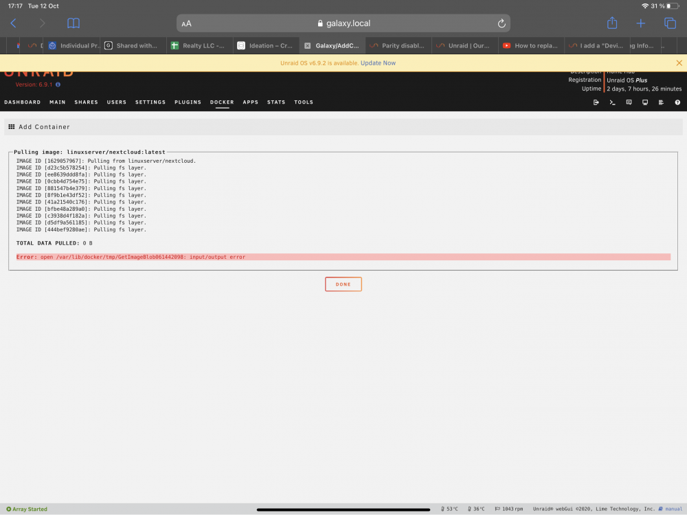

6. When I try to add containers, no files are pull and I get errors. Typically a Server Error and it is not recreated.

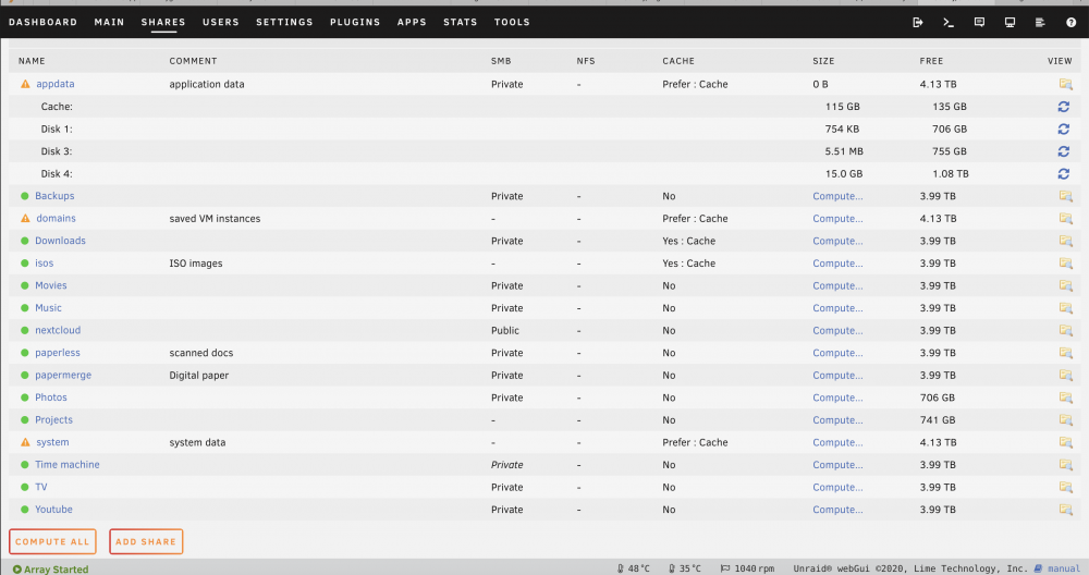

Corrupt docker.img. Why have you given it 150G? Have you had problems filling it? 20G is often more than enough. Making it larger won't fix filling it, it will only make it take longer to fill. The usual cause of filling docker.img is an app writing to a path that isn't mapped.
Why are you moving appdata, domains, system shares to the array? You want these shares to be cache-prefer so they will stay on cache. If they are on the array, dockers/VMs will not perform as well, and they will keep array disks spinning because these files are always open.
Set these shares to cache-prefer.
Disable VM Manager in Settings. Disable Docker in Settings and delete docker.img.
While you have Dockers/VMs disabled, run mover so those shares will get moved to cache where they belong.
After mover finishes, recreate docker.img, try 20G.

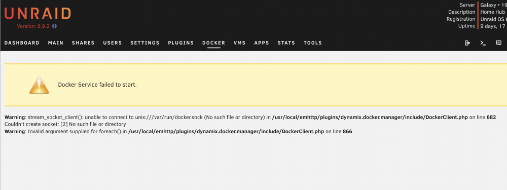

Midway report.
I have recreated docker.img
i can now see my  appdata folders in the share tab. Progress
but docker service will not start. I get the following error..
Warning: stream_socket_client(): unable to connect to unix:///var/run/docker.sock (No such file or directory) in /usr/local/emhttp/plugins/dynamix.docker.manager/include/DockerClient.php on line 682
Couldn't create socket: [2] No such file or directory
Warning: Invalid argument supplied for foreach() in /usr/local/emhttp/plugins/dynamix.docker.manager/include/DockerClient.php on line 866

But as I said above I can't re install dockers as I get the above error message.

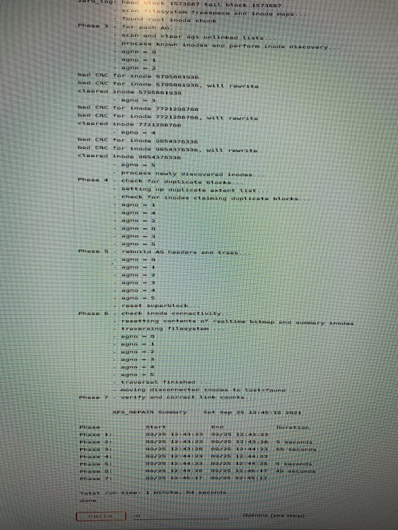

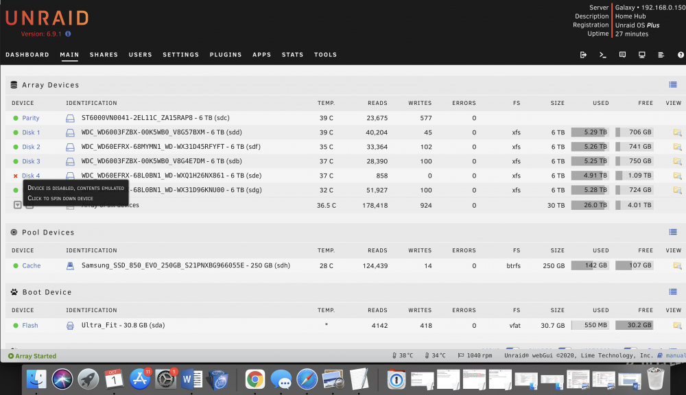

You need check filesystem on disk 4
It also appears that your parity drive is having continual resets, probably due to a flakey sata / power connection to it.  Reseat / replace the cabline.

I just assumed the logs got cut off.  Corruption exists on drive 4 (partial explanation for no containers), and if the server hasn't been powered off and cabling reseated, then the parity drive needs that and it also explains why the check is slow.
I will check the filesystem using the link. Thanks. and check the sata/power connections.
