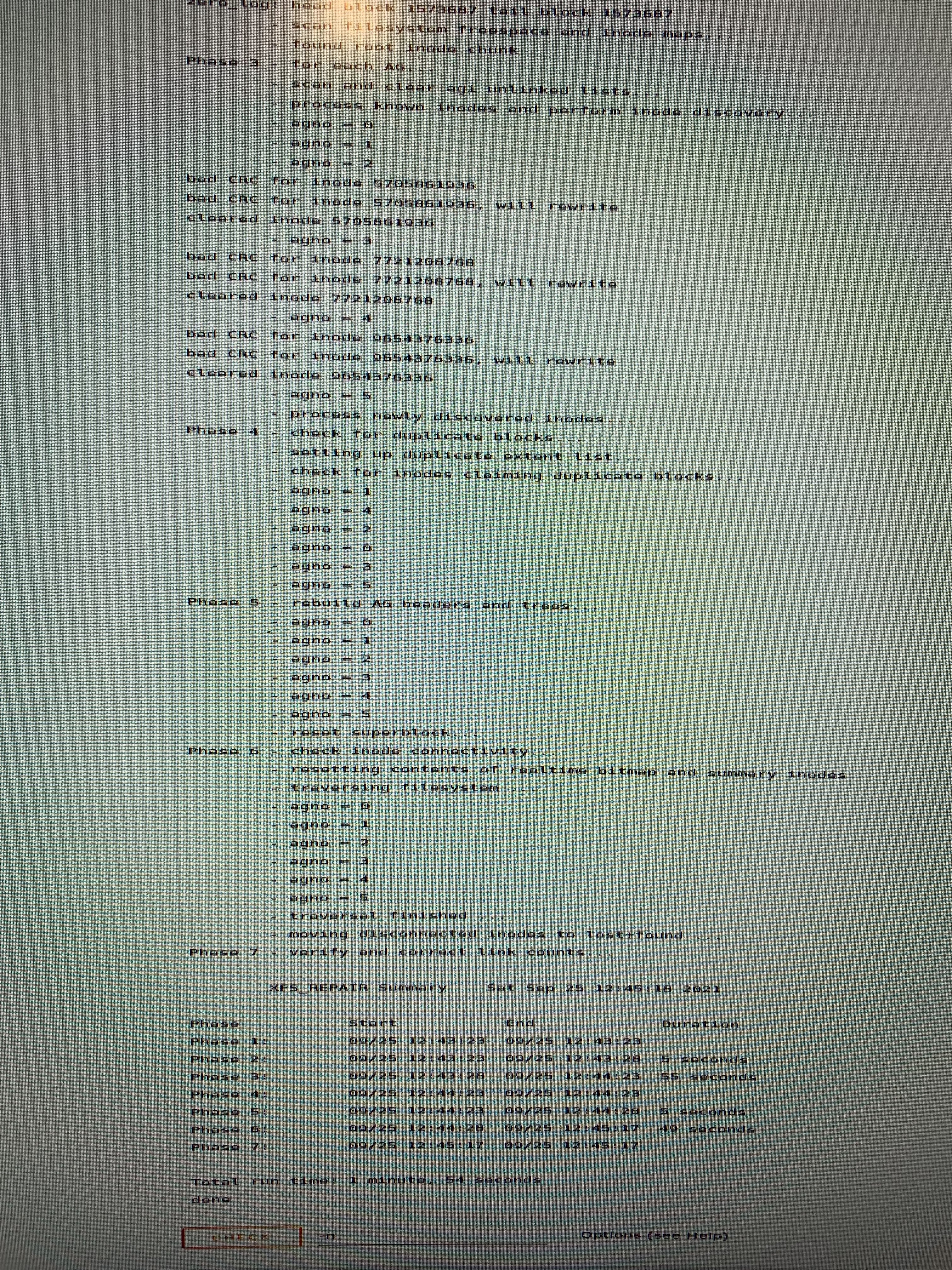

I was only able to take a photo of the disk 4 file system check.
what next?
That looks as if it has managed to repair any corruption without any data loss.
Yes, it seems.

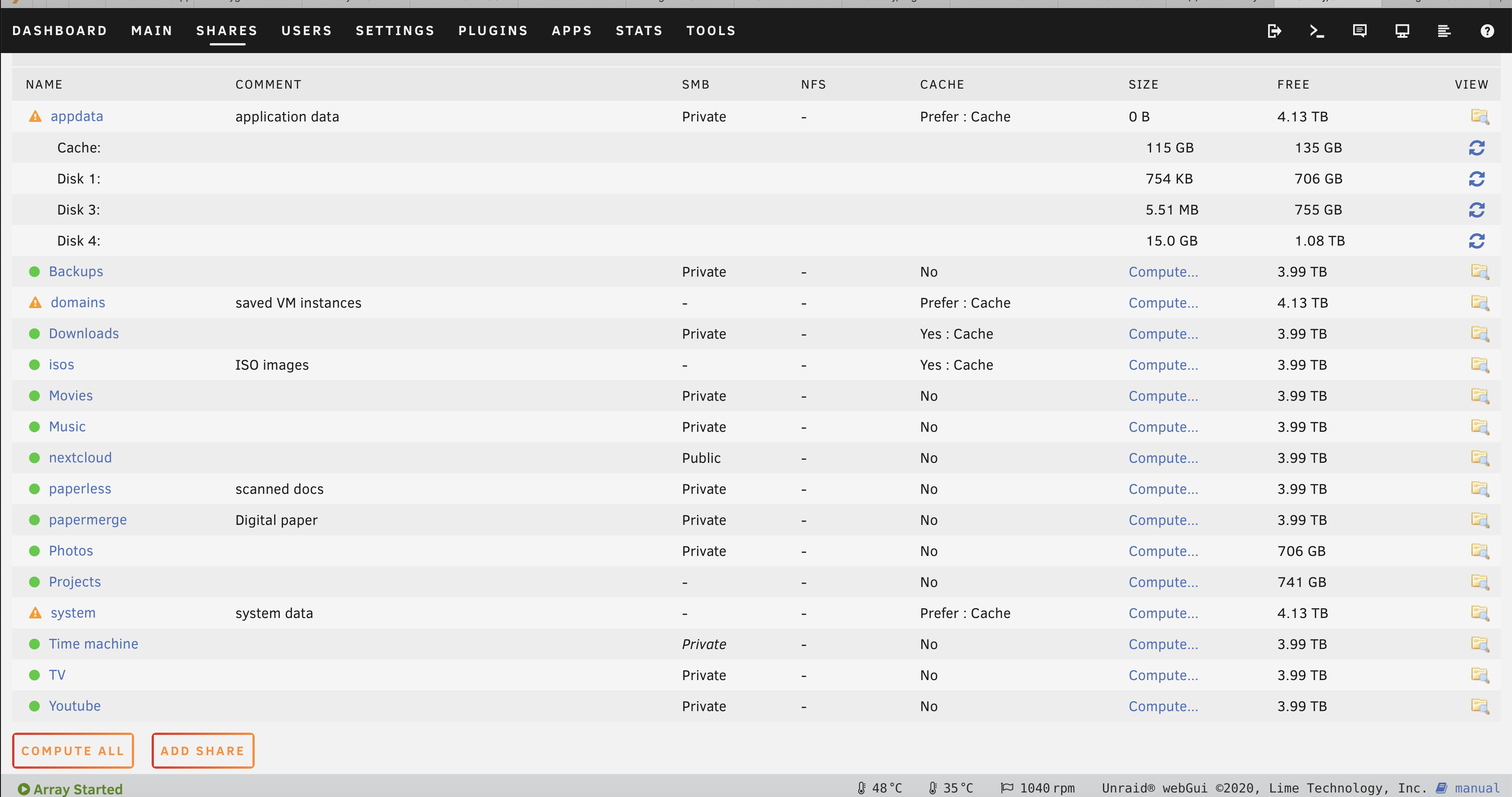

On 9/23/2021 at 3:08 PM, trurl said:
Also, go to User Shares, click Compute All button at the bottom, wait for the complete results. If you don't see the complete results after several minutes, refresh the page. After you get the complete results post a screenshot.

Your screenshot of User Shares above shows appdata on cache and disks 1,3,4 but your diagnostics say there is also appdata on disk5. And the diagnostics also show you had filled log space with entries from mover.
Nothing can move open files, and mover won't move duplicates. Looks like you have duplicates.
Reboot if you haven't already to get log space cleared.
Then go to the command line and post the results of
ls -lah /mnt/cache/appdata
and
ls -lah /mnt/user0/appdata

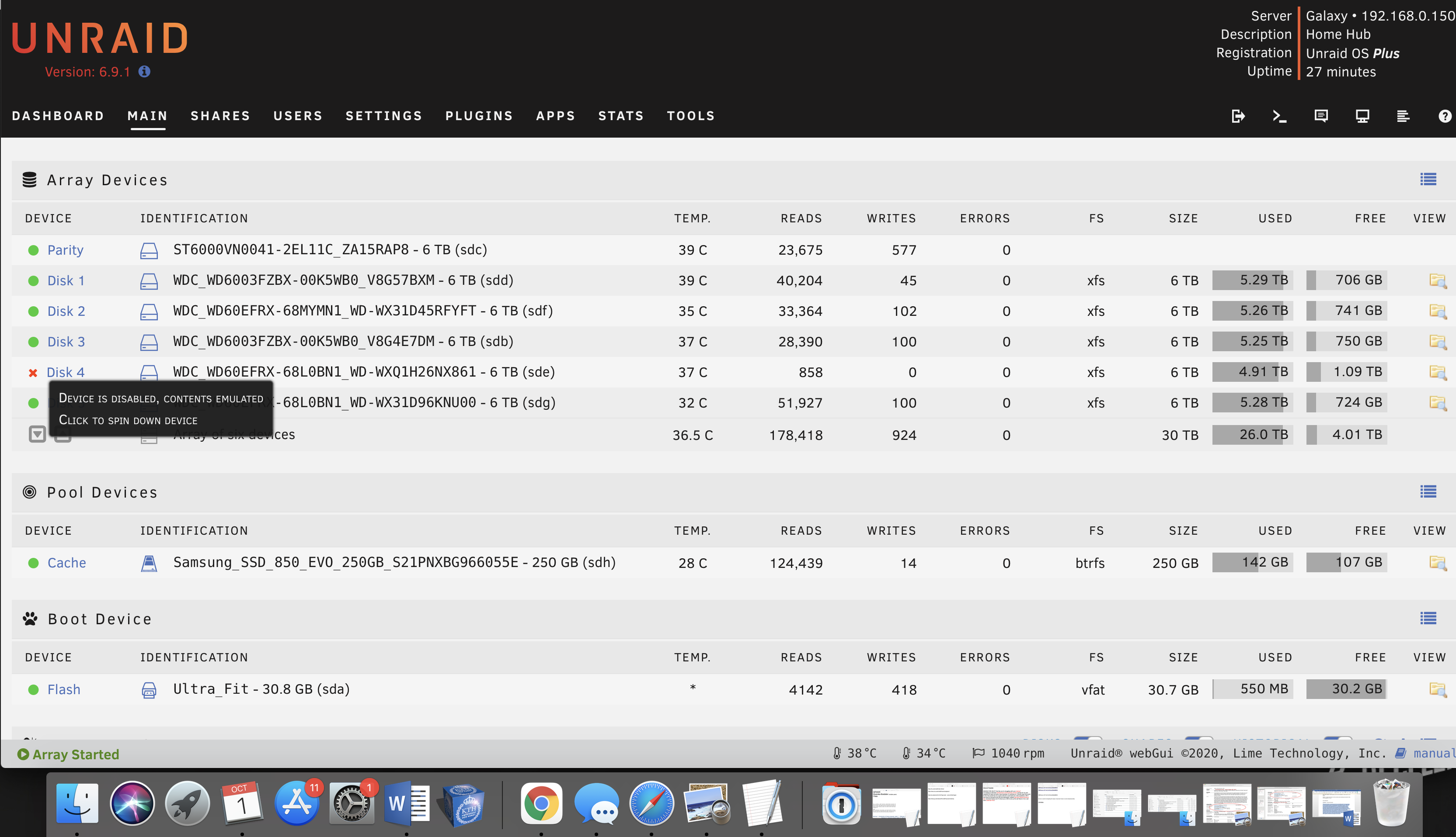

But now Disk 4 seems to have a big issue on top of all of this 😞
Edited by Profezor
1 hour ago, Profezor said:
now Disk 4
Post new diagnostics
I am running a re build on Disk 4. I got to 92% and 1 hour to go and now it has slowed to say the next 8% will take 40 days.
galaxy-diagnostics-20211006-1810.zip
Edited by Profezor
