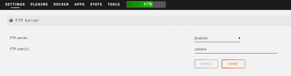

From what I can tell, it looks like the FTP user permissions are not being honored. This is what I did (screenshots below).
  1. Created a new user
  2. In Settings > FTP Server I:
    1. Enabled
    2. Added the user

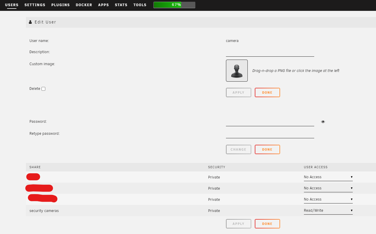

  3. In Users > the user:
    1. Gave the user read/write to  only one share
After that, when I connected to my unraid box using FTP using the user, I was able to navigate to other shares and create files.
