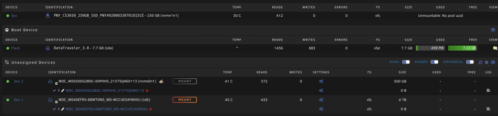

  • 6.9.2?   Your screenshot shows the array started with no disks missing. I think you must mean that disk8 is not assigned. A missing disk would be indicated by a red X and its contents would
  • What do you mean "fix Disk 8"? Since it isn't missing, do you just mean that you want some disk assigned as disk8 so there isn't a gap?
  • Try refreshing the page.

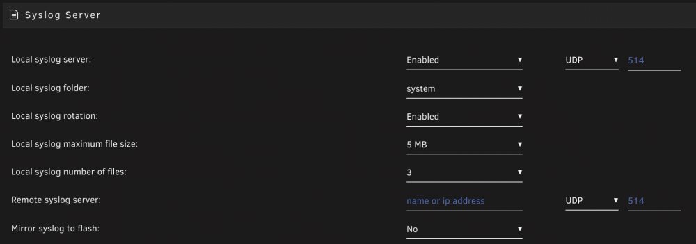

Yes! I am waiting the log from my friend. We setup my log to a rpi zero.
