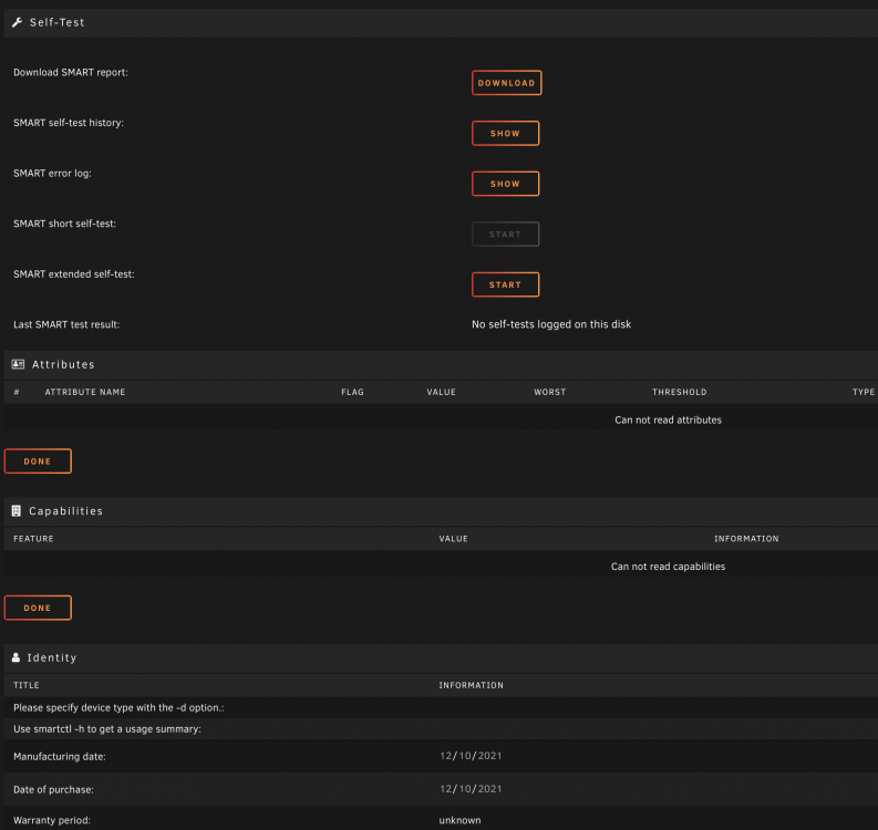

plug in the spare disk you want to use and post new diagnostics or at least a SMART report for that disk
make sure you have good connections and don't disturb other connections
Adding the disk now!
That disk might be OK, but it is a WD RED with nonzero for SMART attribute 1. You should add attributes 1 and 200 to be monitored on WD disks.
And it hasn't had an extended test run on it recently.
Run an extended SMART test on the disk.
Or we can take a look at another disk since you seemed to imply you had more than one spare.
I am running an extended SMART test on that disk. Almost all my disks was WD RED in the unraid.
its just the one on external enclosures I am buying lately are white labeled anyway.
and from what I read all those disks are same with the red ones and the only thing is missing is the red label.
Should I changed the attribute like you said to all those?
I am at Tools > Preclear Disk and this is all I get.. it's like the test isnt running?1706758401_ScreenShot2021-12-10at7_45_36AM.thumb.png.b6da03ee934e26ca36f55ab7bc397059.png
