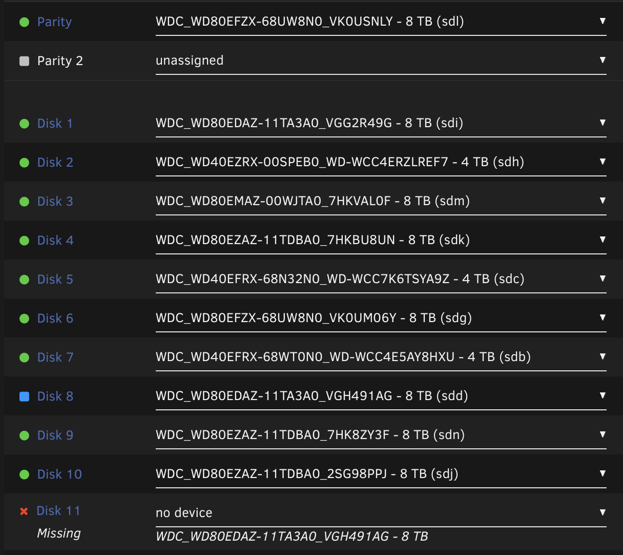

Stopped the Array and I am here now
35790810_ScreenShot2021-11-19at5_13_20PM.thumb.png.24243928266d5d6ce7ac9c830b417d42.png

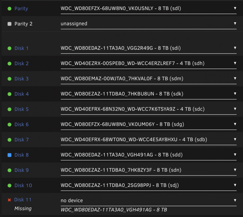

I should do something like this?
866684745_ScreenShot2021-11-19at6_07_47PM.thumb.png.cd9ee67665625d2e43a1b88a66ee1eb5.png
set no device to Disk 11
and set the Disk 11 (8tb new) to Disk 8.
Edited by piratx
Yes. Since you don't need to rebuild parity, before starting the array, check the box saying parity is already valid.
