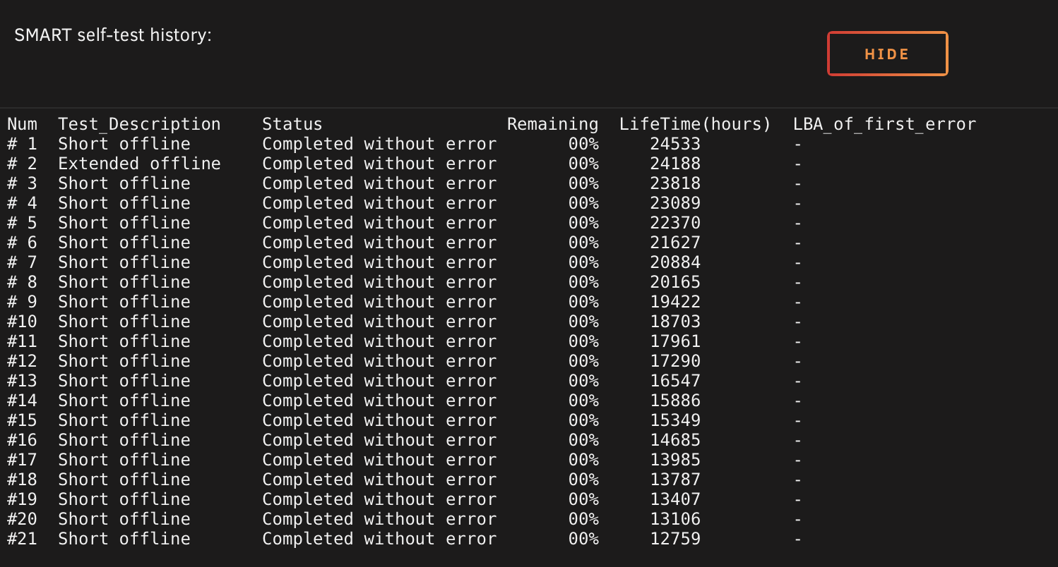

767877372_ScreenShot2021-12-10at8_31_39AM.thumb.png.e7e8e57be78abfd459408cfd7e5a9936.png

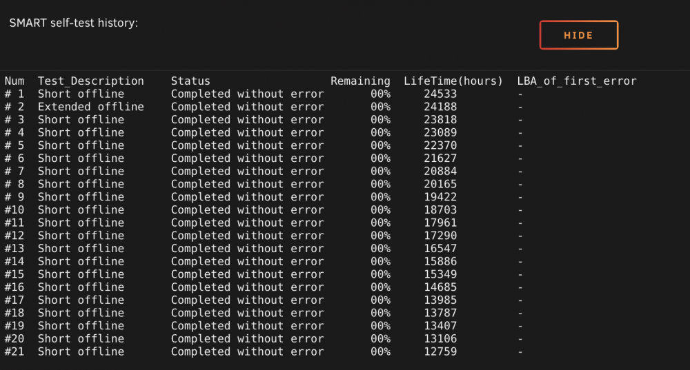

Diagnostics already contains SMART report for all attached disks, which is how I knew what I did about that disk. A new SMART report after the extended test is what we need.
The information in that screenshot is part of the SMART report. The last extended test was completed at hour 24188. The disk is at hour 44222, so that was a few years ago
Running now.. stuck on 10%. I'll let you know!

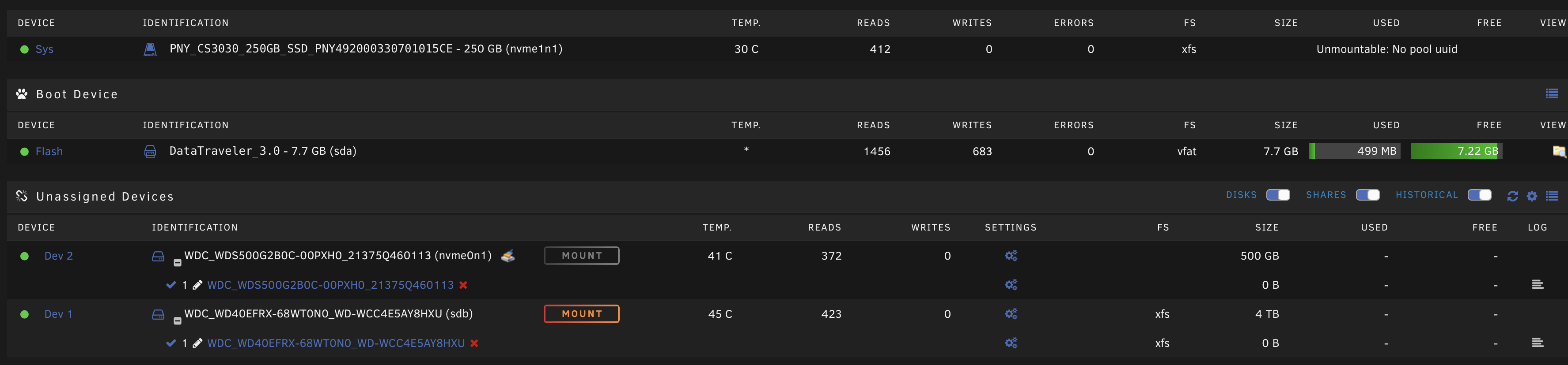

Can I do something else until that finishes? I have something weird on the Sys pool
One thing for sure doesn't work it my qbittorrent client. That happened after I tried to add the 500GB new NVMe on my Sys pool :(258506044_ScreenShot2021-12-10at8_42_51AM.thumb.png.b49e4a4a69769921aa51efefccbd28b0.png

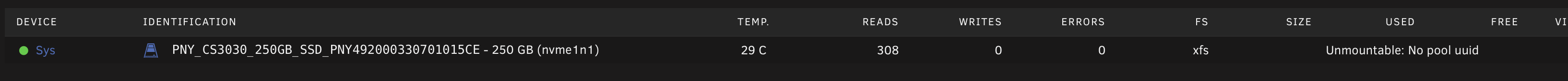

All started when this "Unmountable: No pool uuid" appeared..
1130906670_ScreenShot2021-12-11at1_36_56PM.thumb.png.7d65c458e2954fce3025d6961f864137.png
eleven-diagnostics-20211211-1335.zip
You can try to repair the filesystem on sys, or if there isn't anything important on it you can reformat

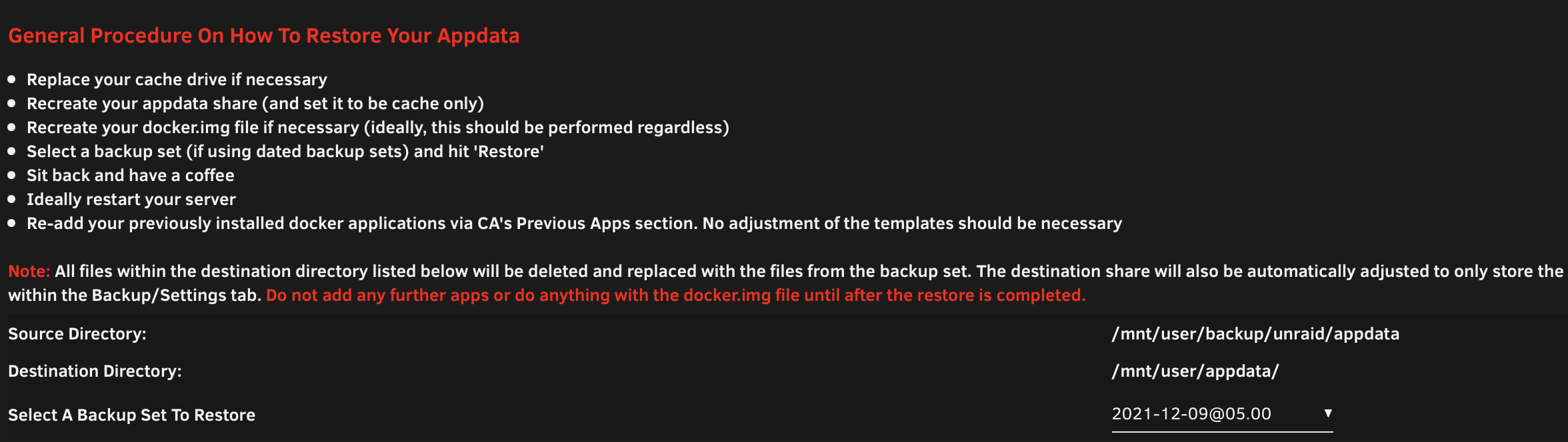

Did you use Previous Apps on the Apps page to reinstall your dockers? If so then everything should have worked exactly as before using your appdata backup.

So I shutdown the unraid and tried to remove the non needed disks (the 4tb which caused issues before and the smaller nvme) which those stayed on my unassigned devices for a month.
