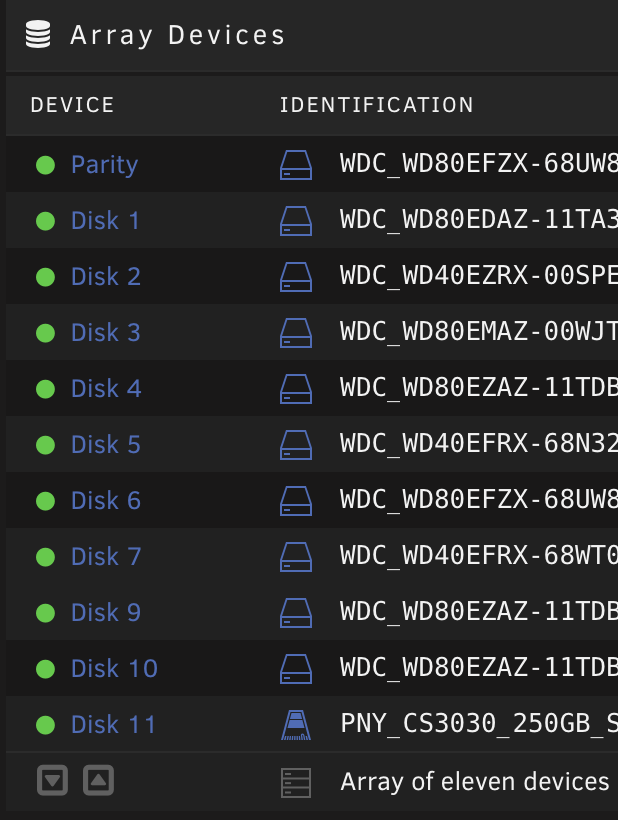

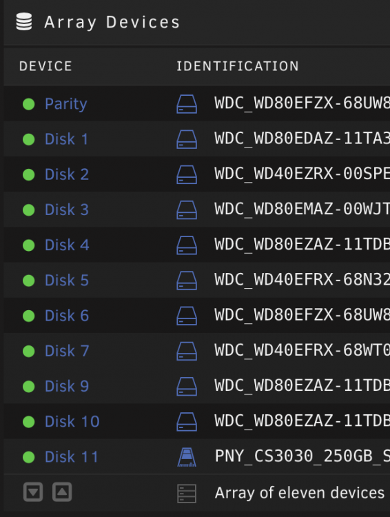

  • 6.9.2?   Your screenshot shows the array started with no disks missing. I think you must mean that disk8 is not assigned. A missing disk would be indicated by a red X and its contents would
  • What do you mean "fix Disk 8"? Since it isn't missing, do you just mean that you want some disk assigned as disk8 so there isn't a gap?
  • Try refreshing the page.
9 hours ago, piratx said:
unRAID 9.6.2 with one Parity disks and 10 disks. Little note here, some 4tb disk in the past had issues so I removed it from my array. Cause of this I have now Parity Disk 1-7 and then 9-11, Disk 8 is missing.
6.9.2?
Your screenshot shows the array started with no disks missing. I think you must mean that disk8 is not assigned. A missing disk would be indicated by a red X and its contents would be emulated. But we can "fill that gap" if that is what you want.
How exactly did you remove that disk8? New Config with parity rebuild?

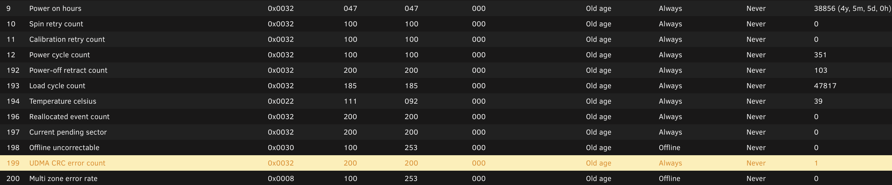

a disk which is giving me this error for some years now.
Not clear which disk you are referring to here, but UDMA CRC Errors are connection problems, not disk problems. Probably nothing wrong with the disk, There are some good arguments to be made for not having an SSD in an array with HDDs though.

I have removed the disk cause of problems and I placed a new 8tb instead of 4tb the previous one was. Never did "New config" so far. So no I just left the slot "open" I suppose!
Ah sorry Disk 5 is giving me the UDMA CRC errors (WDC_WD40EFRX-68N32N0_WD) I have some disks which I installed from external 8tb disks (all WD) and I got a cheat from a friend for them to work properly on my setup.
I want to keep nvme disk 11 on its own pool, probably for appdata (will that make things faster) and VMs..
Diagnostics included
eleven-diagnostics-20211116-1735.zip
Not possible, disk8 would still be considered part of the array, and its contents would be emulated. Did you perhaps "start from scratch" with a new install and no disks assigned? Are you sure you have valid parity?
Or did you never have a disk8 installed?
Yes everything is valid.. Can't remember exactly what I've did sorry. I remember replacing a disk and adding a new one and then I moved back to 10 again..
Was like 8 disks / then 9 disks and then I added the nvme.. can't remember.. :(

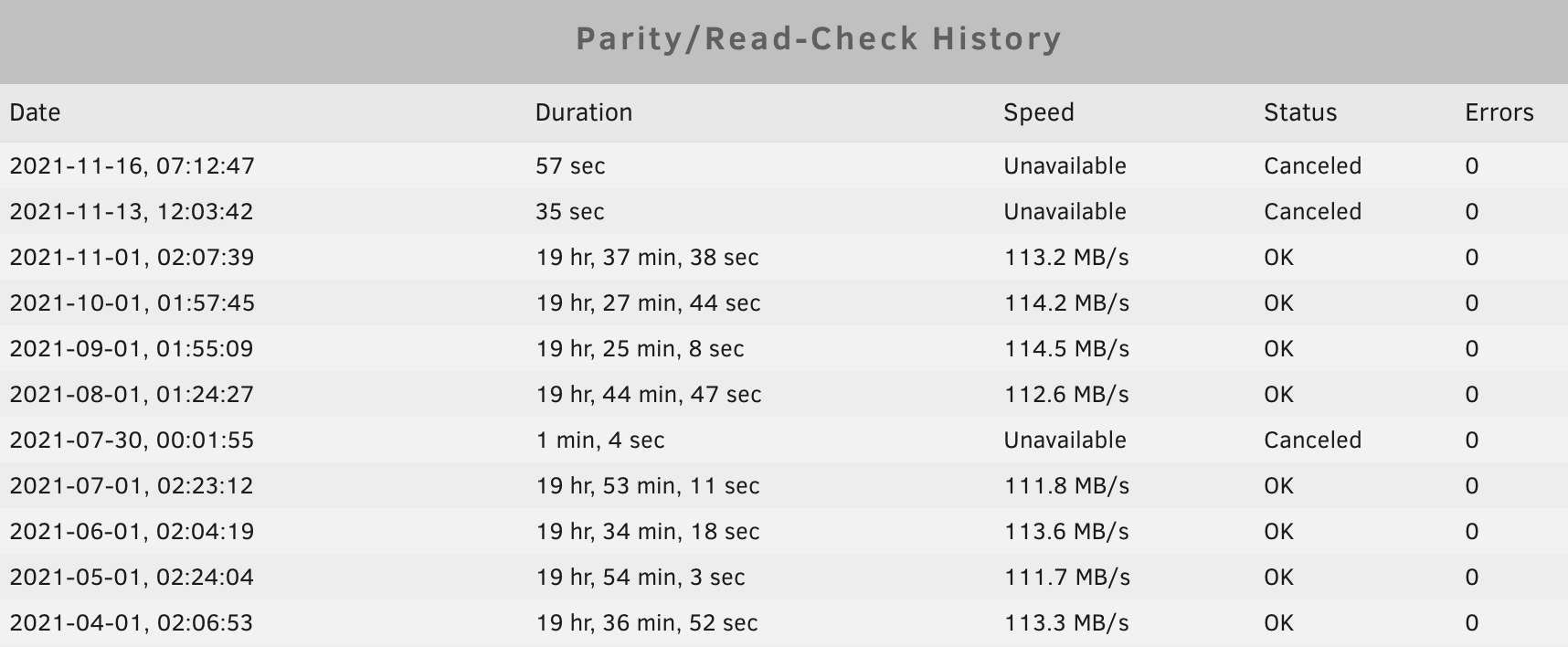

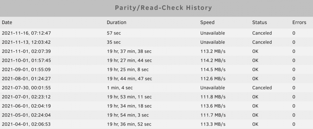

I've checked Parity many times so far.. I don't know how can I check it otherwise?1531598368_ScreenShot2021-11-16at6_04_45PM.thumb.png.865ab5594dcc2baa070a7cc1a390bae4.png
Nothing you have said makes any difference regarding removing a disk from the parity array. You have to rebuild parity so the removed disk is no longer part of the parity calculation. Doesn't matter at all what was on the disk if it was part of the parity array.
1 minute ago, trurl said:
How do you know?
Have you had a parity check since then that had exactly zero sync errors?
When did you remove disk8?
Why did you cancel those most recent parity checks?
Nov 16 07:11:06 eleven emhttpd: unclean shutdown detected
This by itself probably means your parity isn't completely valid.

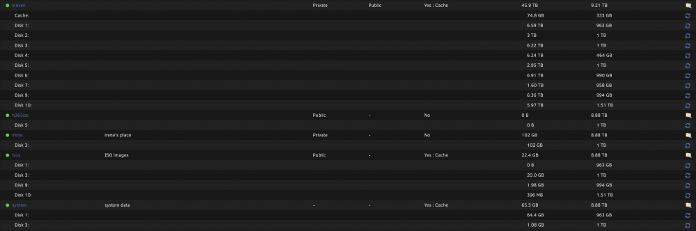

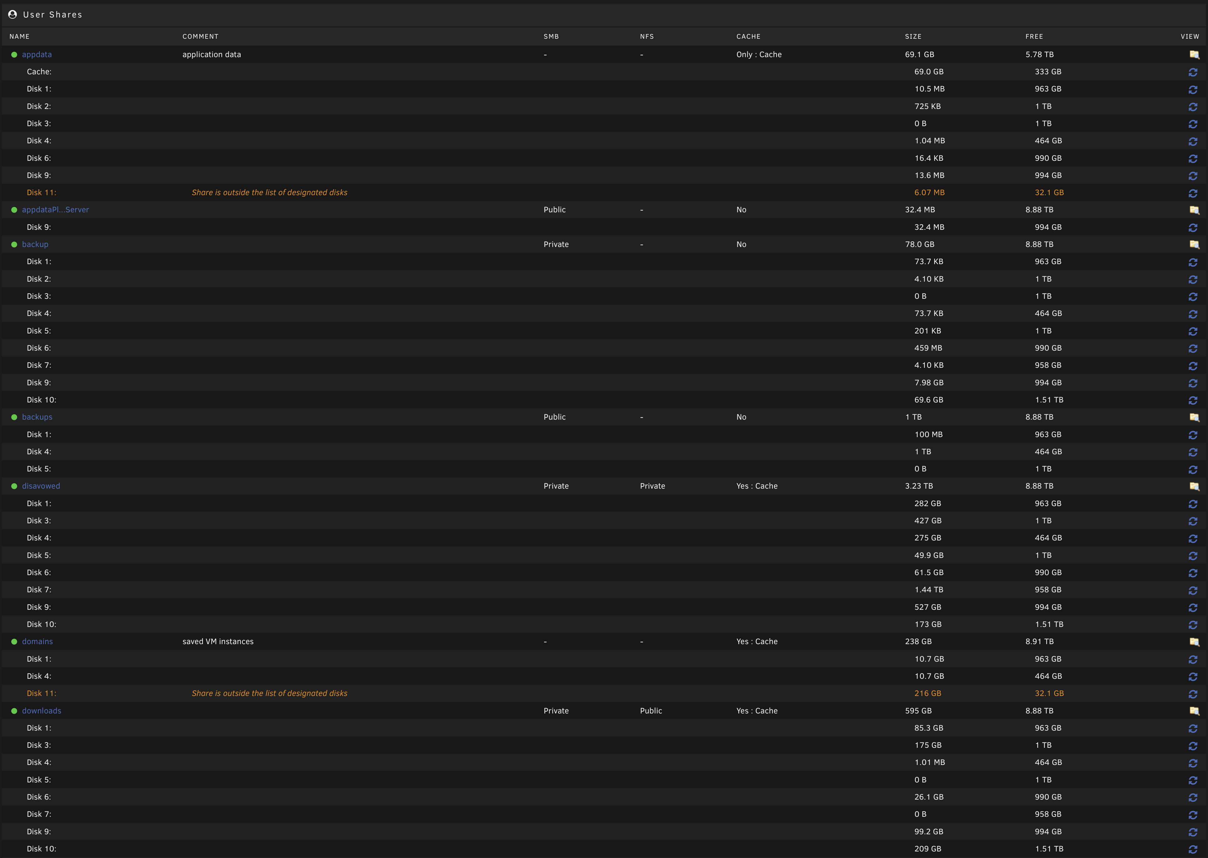

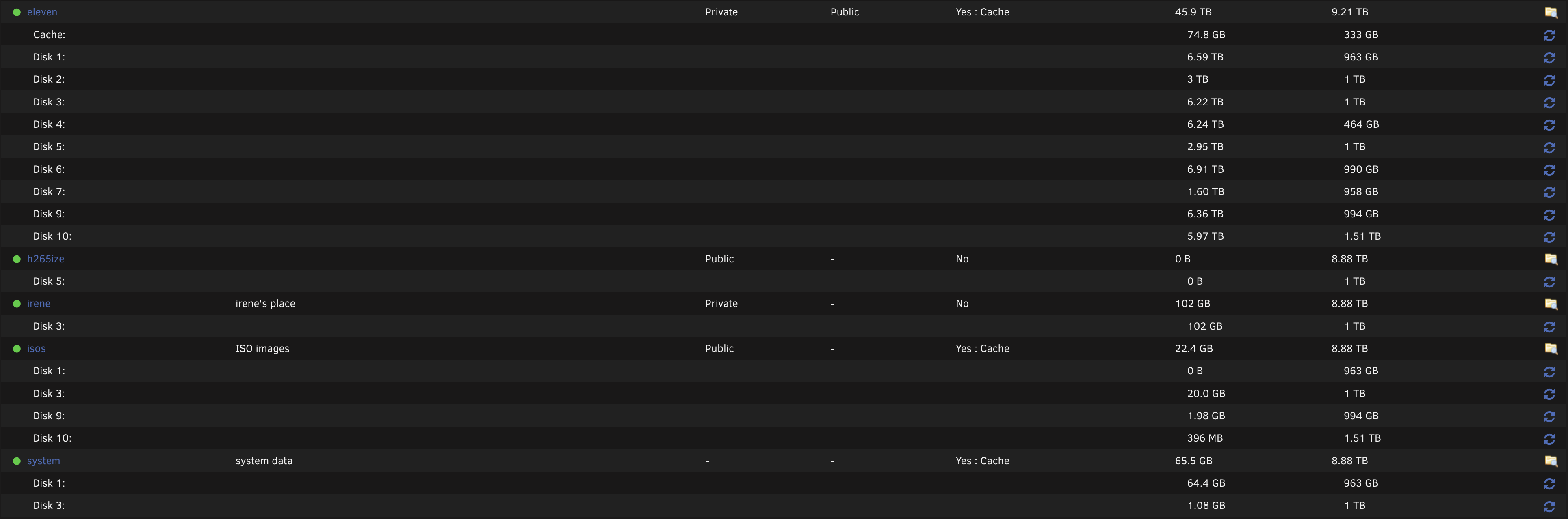

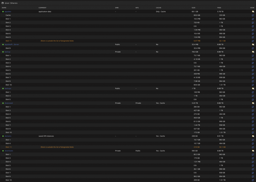

Go to User Shares, click the Compute All button, wait for the result, then post a screenshot.
Also, what do you get from the command line with this?
du -h -d1 /mnt/disk11
5.8M    /mnt/disk11/appdata
202G    /mnt/disk11/domains
202G    /mnt/disk11
Edited by piratx
Still loading :)
Spoiler
551501395_ScreenShot2021-11-16at8_25_07PM.thumb.png.9d797569f9143aa287ccd8d9f0a67ae7.png
2043315054_ScreenShot2021-11-16at8_25_14PM.thumb.png.a8082ec97ee63d7e2e034e6371e48850.png
That helped thanks :D
Ideally, your appdata, domains, system shares would be all on some pool and not in the parity array, so your dockers/VMs would perform better and not keep array disks spunup.
But it doesn't look like that nvme has the capacity for all of that. Why is your docker.img so large? Are you sure you don't have some application writing into it instead of to mapped storage?
